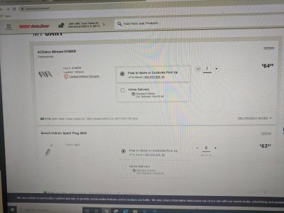

I was going to use these.

The wires at RA are a better quality than the "Professional" brand of AC Delco and are only $2.80 more and the AC Delco is a preferred plug for most are are $43.60 for 8 of them instead of $63.92 for the Bosch. If you can wait for the RA parts and use the 5% RA discount code and still pay shipping, you should come out money ahead and have better quality parts, again IMO.
Before the 5% discount and whatever shipping is, the total you have is $128.91 and my total is $111.39.
Hell, the same Professional wires at RA are $34.99. The AC Delco Iridium plugs are 5.45 each at RA.
I believe the AC Delco wires #748RR would be a better long haul choice.

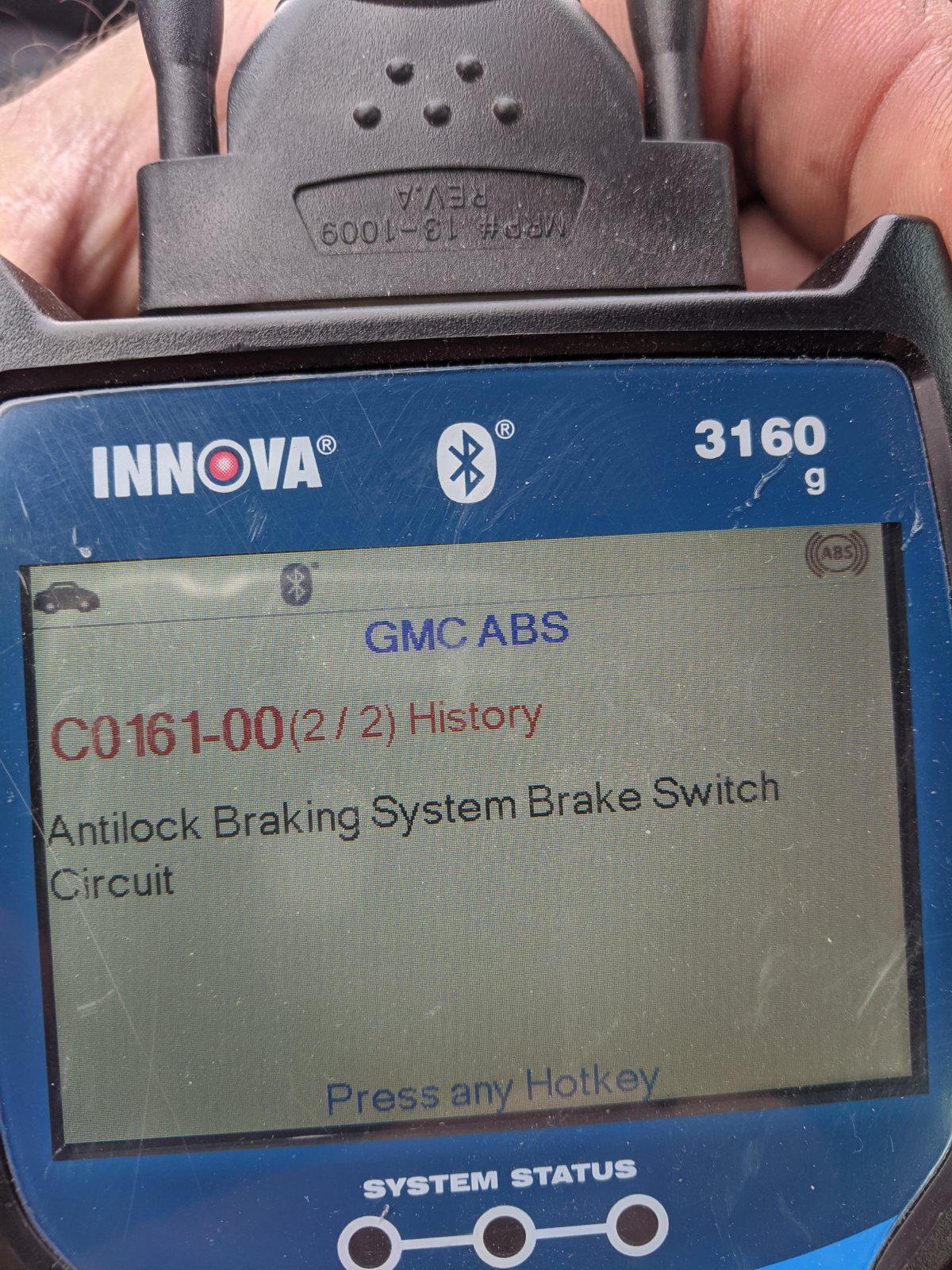

We bought a 2007 GMC XL Denali this wknd with 163,000 on Odometer. When test driving it ran fine with no codes or messages other than low tire indicator. On way home from dealership we stopped at gas station to check air pressure. Upon stopping it started to idle roughly and then quit and then not restart until it cooled down. Also we noticed the cruise control did not work. The button light came on but no engagement light on cluster. After getting it started again it ran fine and we drove on, along the way random messages appeared such as stabiilitrak not engaged, service traction control and hood open.
Yesterday I replaced the brake light switch and that fixed the cruise control and message went away. Drove it today at lunch and it idled for awhile and then messages appeared again and now cruise doesn't work again. Can somet help me out. Does this sound like a bad ground somewhere or ??? Thanks all. I appreciate ya.

There is a plug connection above rear shock bolt on the frame that can set off both those codes. I bumped mine while changes shocks ... you cant see it but you can feel it and see if it's all the way clipped together

It says 2 of 2. What is/was the other code? Plus that says it is a history code. If you are not experiencing any anti-lock brake or regular brake problems, I would make note of it and clear it and see if it comes back.
That code could also be related to your replacing that brake light switch.

if he had a problem with a hub then the abs light would be on or there would be brake pedal abs feedback when stopping or he would hear grinding noise, a bad hub would not trigger a stabilitrac/traction control code, just abs even though they are related the abs code would take priority.

Will clear the code tonight. And see what it does after I put the plugs and wires in this wknd. Did buy the ac/delco iridium plugs and the ac/delco wires.

Now you can start fresh and address any codes that may pop up later that could be legitimate codes to deal with.
