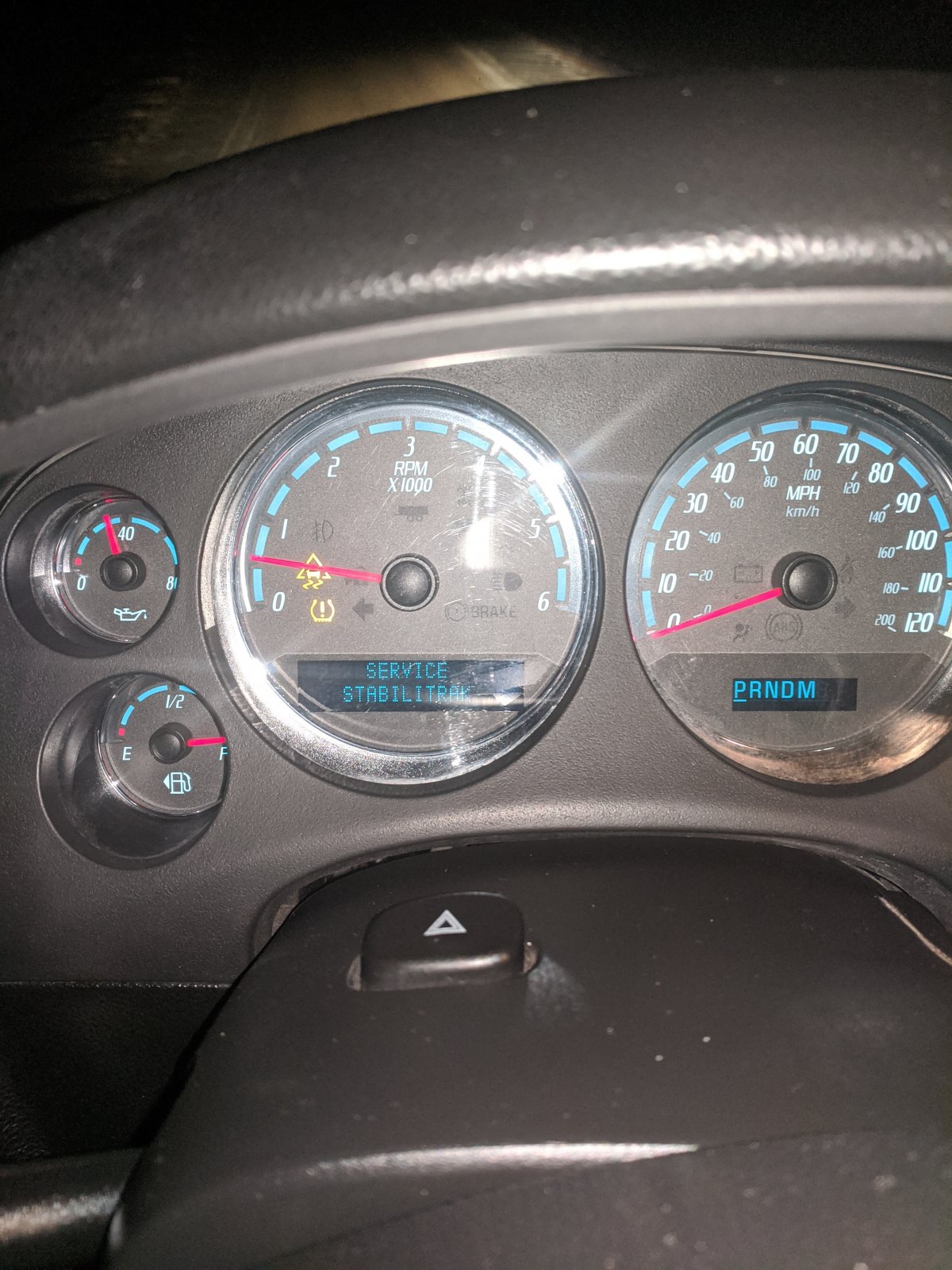

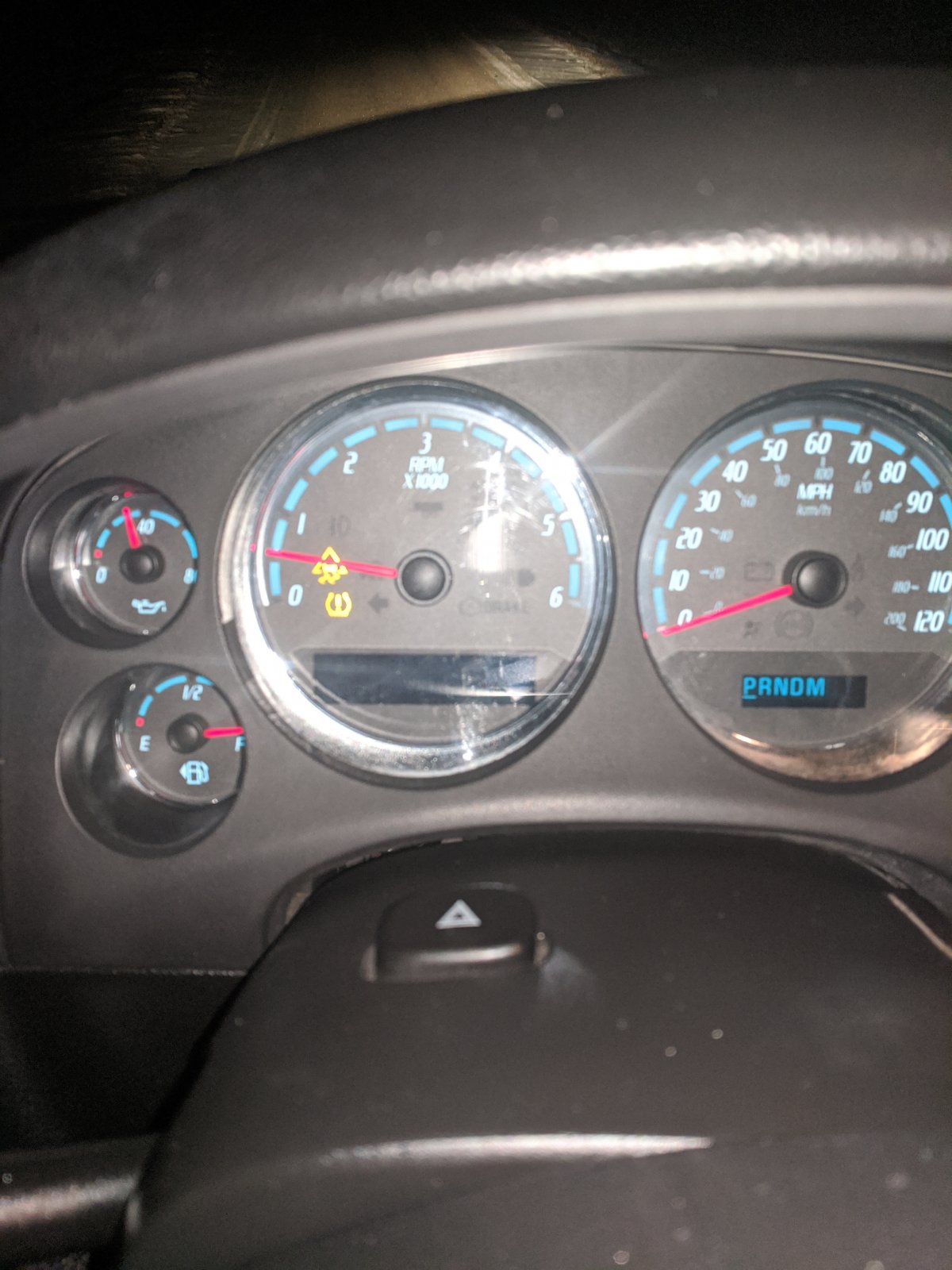

We bought a 2007 GMC XL Denali this wknd with 163,000 on Odometer. When test driving it ran fine with no codes or messages other than low tire indicator. On way home from dealership we stopped at gas station to check air pressure. Upon stopping it started to idle roughly and then quit and then not restart until it cooled down. Also we noticed the cruise control did not work. The button light came on but no engagement light on cluster. After getting it started again it ran fine and we drove on, along the way random messages appeared such as stabiilitrak not engaged, service traction control and hood open.
Yesterday I replaced the brake light switch and that fixed the cruise control and message went away. Drove it today at lunch and it idled for awhile and then messages appeared again and now cruise doesn't work again. Can somet help me out. Does this sound like a bad ground somewhere or ??? Thanks all. I appreciate ya.

Stabilitrak and traction control both run off the wheel speed sensors, so that’s likely one problem sensor with two symptoms.
Hit up a parts store and have it scanned for active and stored codes. Post them up. Then you’ll have a lot more information.

as long as that stabiltrac/traction light is on the cruise control wont work. It's a safety thing because it's getting erratic or bad data from somewhere so cruise is disabled.

ok, so yesterday check engine light came on as well with error code P0335 Camshaft Positioning Sensor.
Now what do you ll suggest. Camshaft Positioning Sensor or plugs and wires or both??
