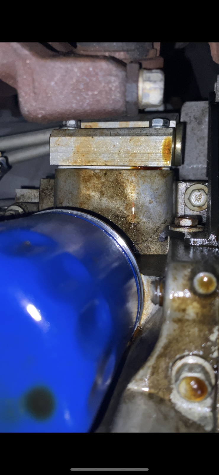

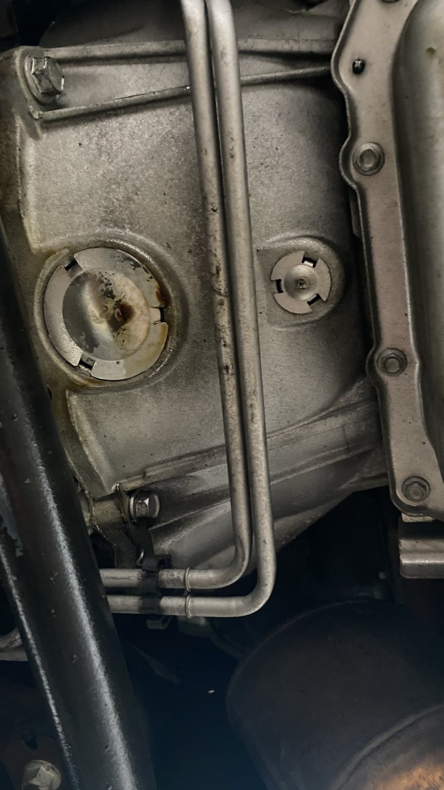

I am beyond frustrated. Back in Aug 2021 my 2012 Yukon XL started leaking oil. Brought it in for service and they fixed the leak, saying it was Oil Cooler Gasket. Brought it home the next day and noticed oil in the same location. Brought it back and they said it wasn't tight enough. A few months later I'm denial again but more oil started appearing to be leaking from the same spot. Brought it in and they said it was the Rear main seal. Got that fixed, as many of you know wasn't cheap. Well, as of today been noticing yet again leaking from the same similar area as the first time I brought it in back in August.This is now BS. I'm at the point where I'm going to dispute my last charge. Has anyone had this type of leaked fixed properly. I refuse to bring it in and get charged any additional money.

These repairs are under warranty nationwide, at any GM dealer if memory serves. If yours were mine I would keep going up with a flashlight. Would also replace the oil filter on the off-chance that the gasket is leaking under pressure and making that mess.

Check the oil pressure sensor and valley cover gasket.

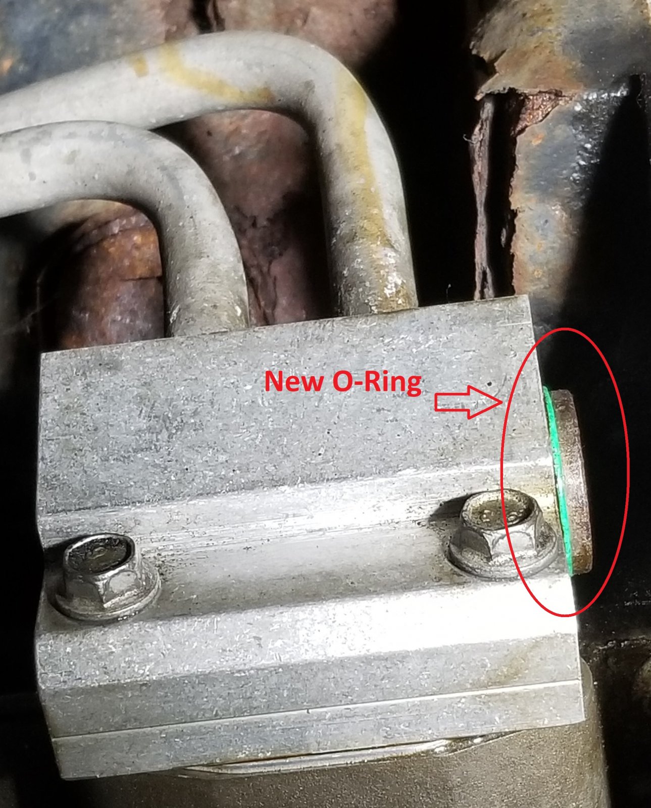

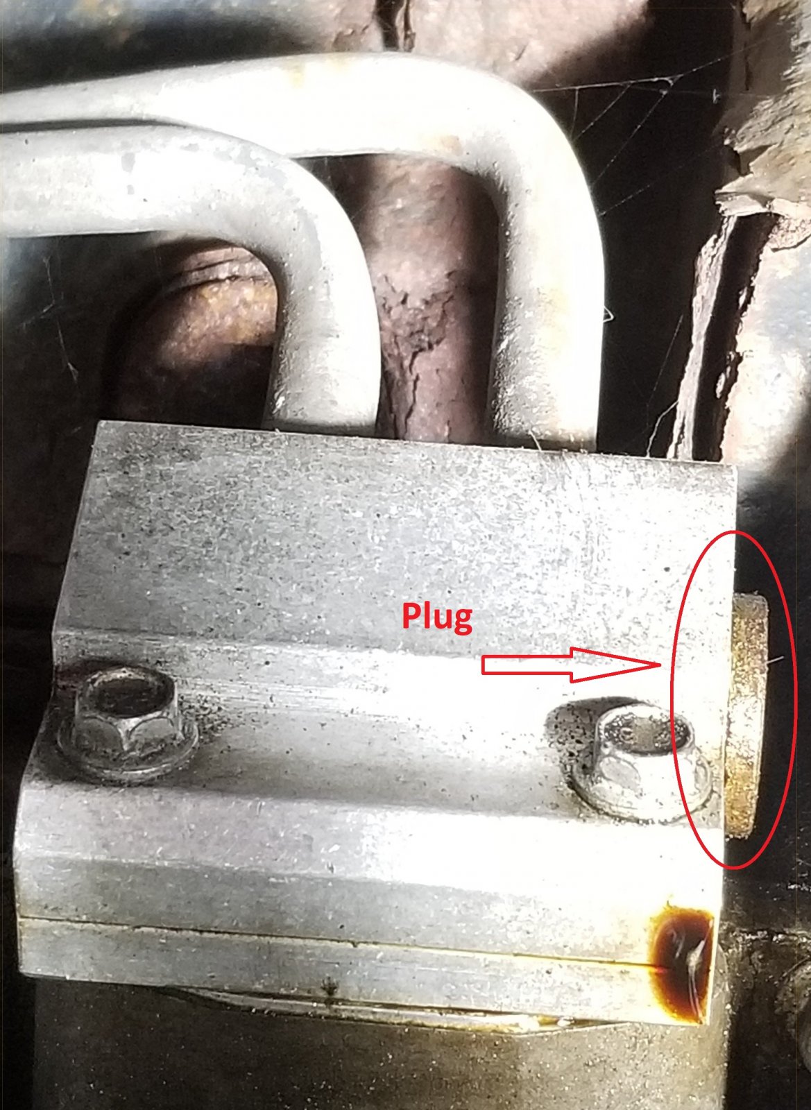

O-ring on right side of the cooler block (2nd pix of your posting)
See the followings:

Few things as frustrating as chasing leaks. In fairness, it's likely that you had leaks from the two that they fixed, or soon would have, in addition to another that's causing what you're seeing now. Based on the pictures, there are three likely culprits: 1/ The o-ring that @jz57 mentioned, 2/ The valley cover gasket, and 3/ the valve cover gaskets. Given that the pictures show oil drips on both sides of the engine (oil filter side and starter side), I'm inclined to think it's the valve covers. That said, they're also the easiest to replace in your driveway, if you so choose. The valley cover requires removing the intake manifold which is also well within the capabilities of a DIY'er but you may wish to farm out as well. If they get in that far, have them replace the oil pressure sender and screen at the same time.
