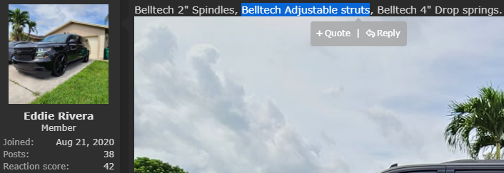

Page 38. Try reaching out to Eddie Rivera.

He just responded. Those are Belltech adjustable struts 25004 not coilovers 16002 i was hoping
