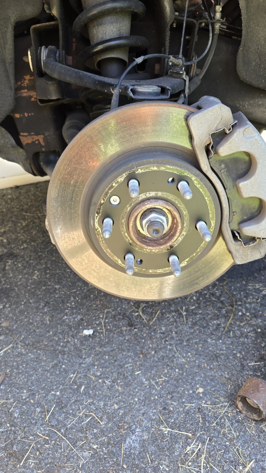

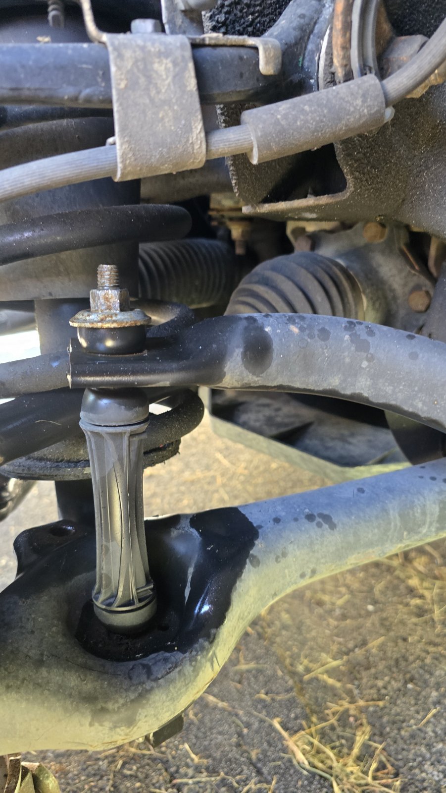

Once we got to the suburban we started front driver side, removing lugs and wheel. I still dont have the right sockets for lugs, so i just use the e kit in the back + jack handle for leverage. Honestly the hardest part is finding the best mounting points for my jackstands since I have the retractable running boards that steal that real estate from me.
On the Front driver side with a stepladder I popped the hit the 3 strut top mounting bolts with lubricant and after removing the two connectors was able to loosen the nuts there. Then underneath I removed the lower mounting bolts. I also loosened the sway bar to give the whole control arm some play.
Getting the strut out was just a matter of pushing up and down on the control arms, and the bottom came right out. You have to lower it a bit and then pull out from the top.

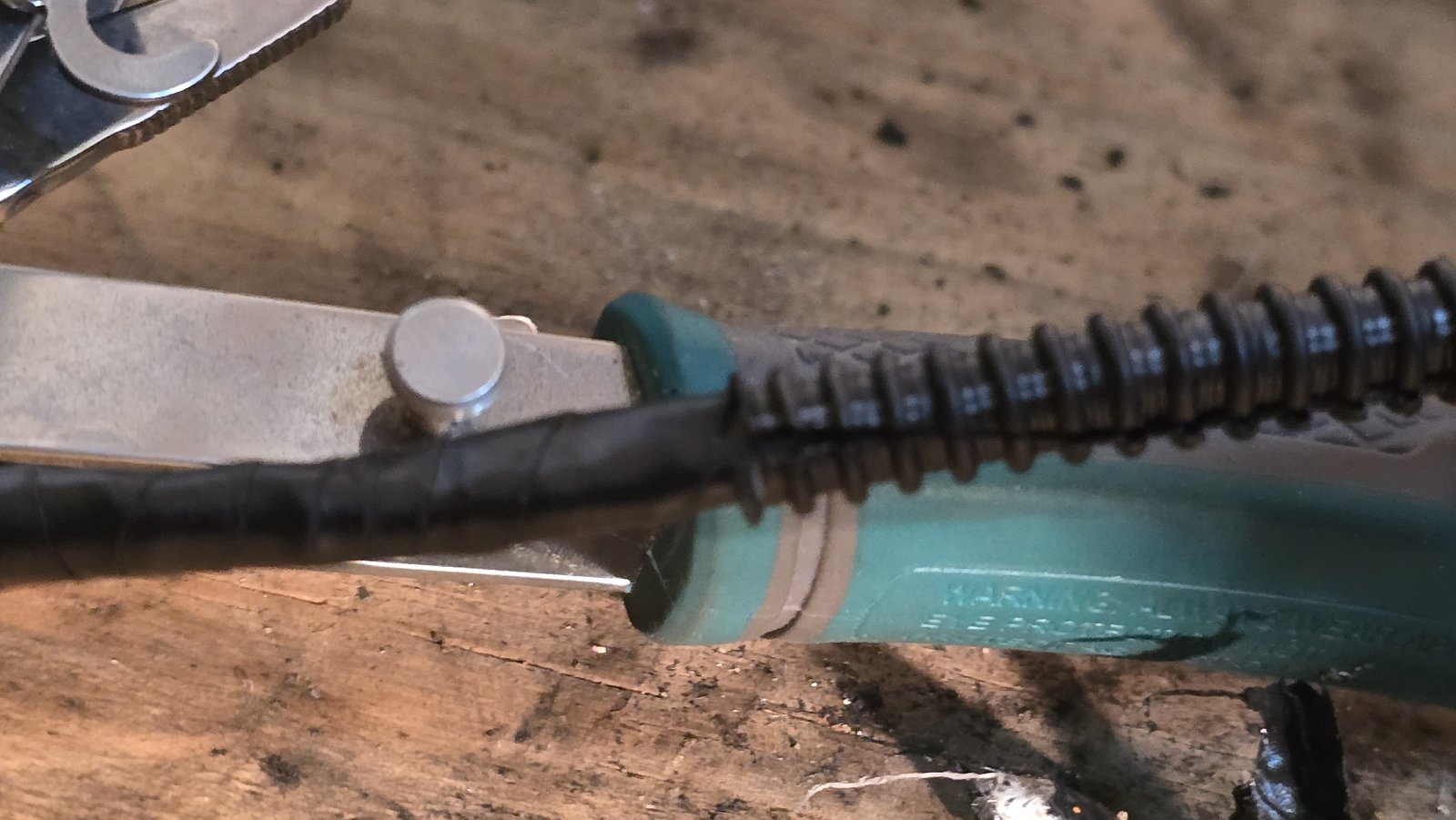

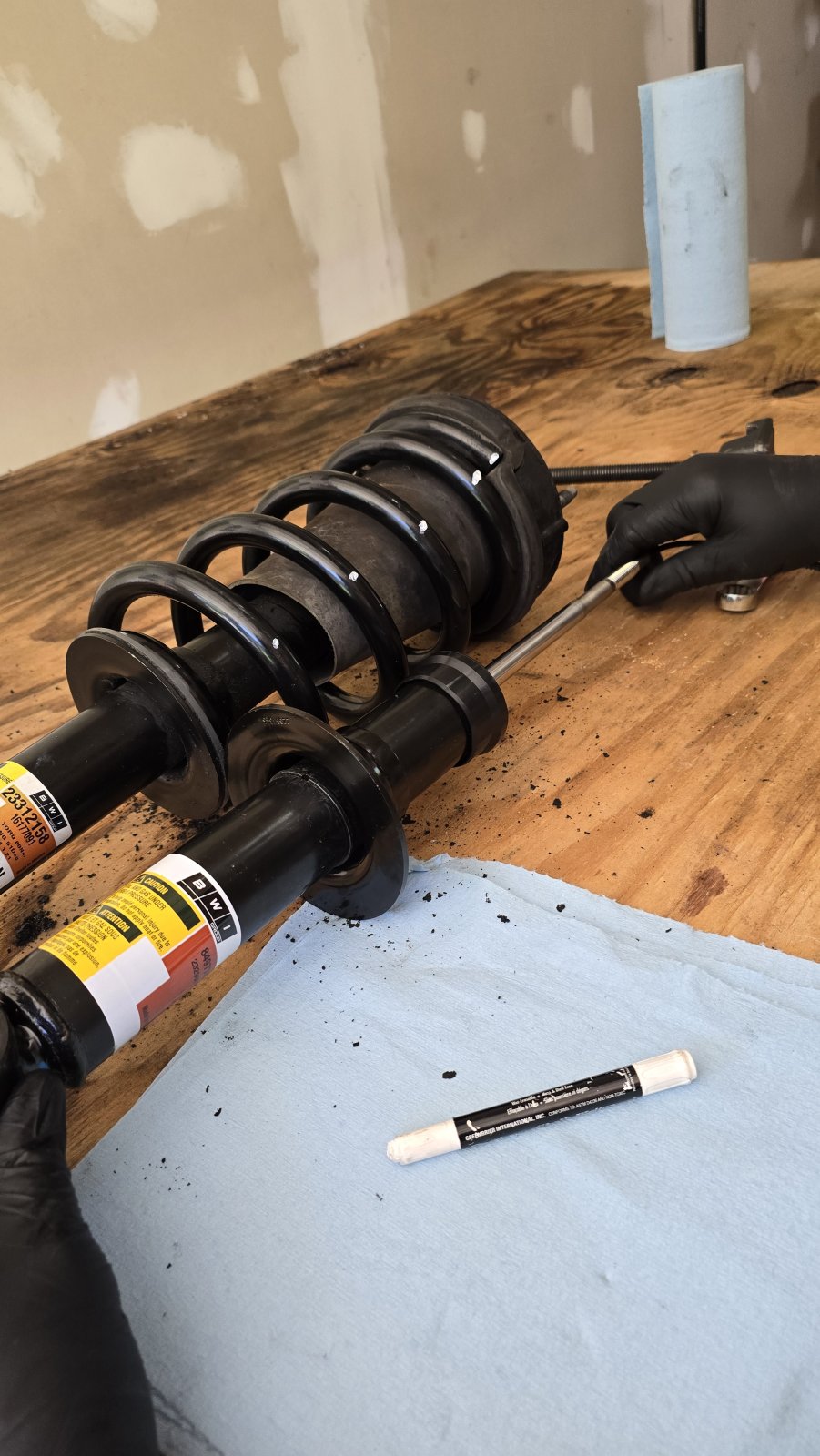

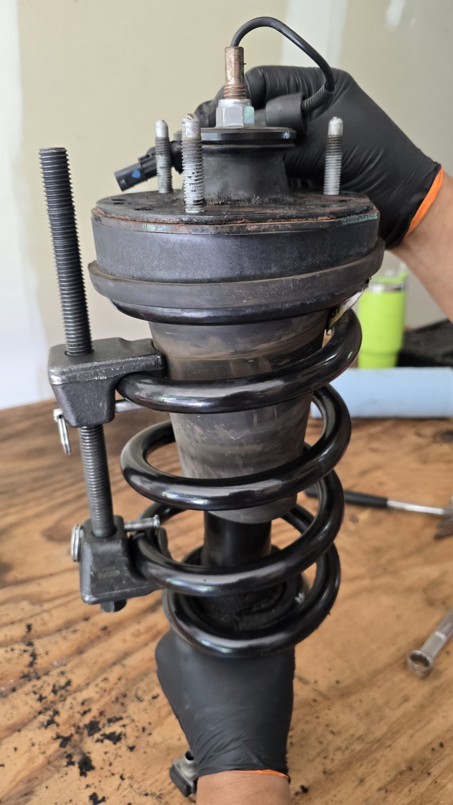

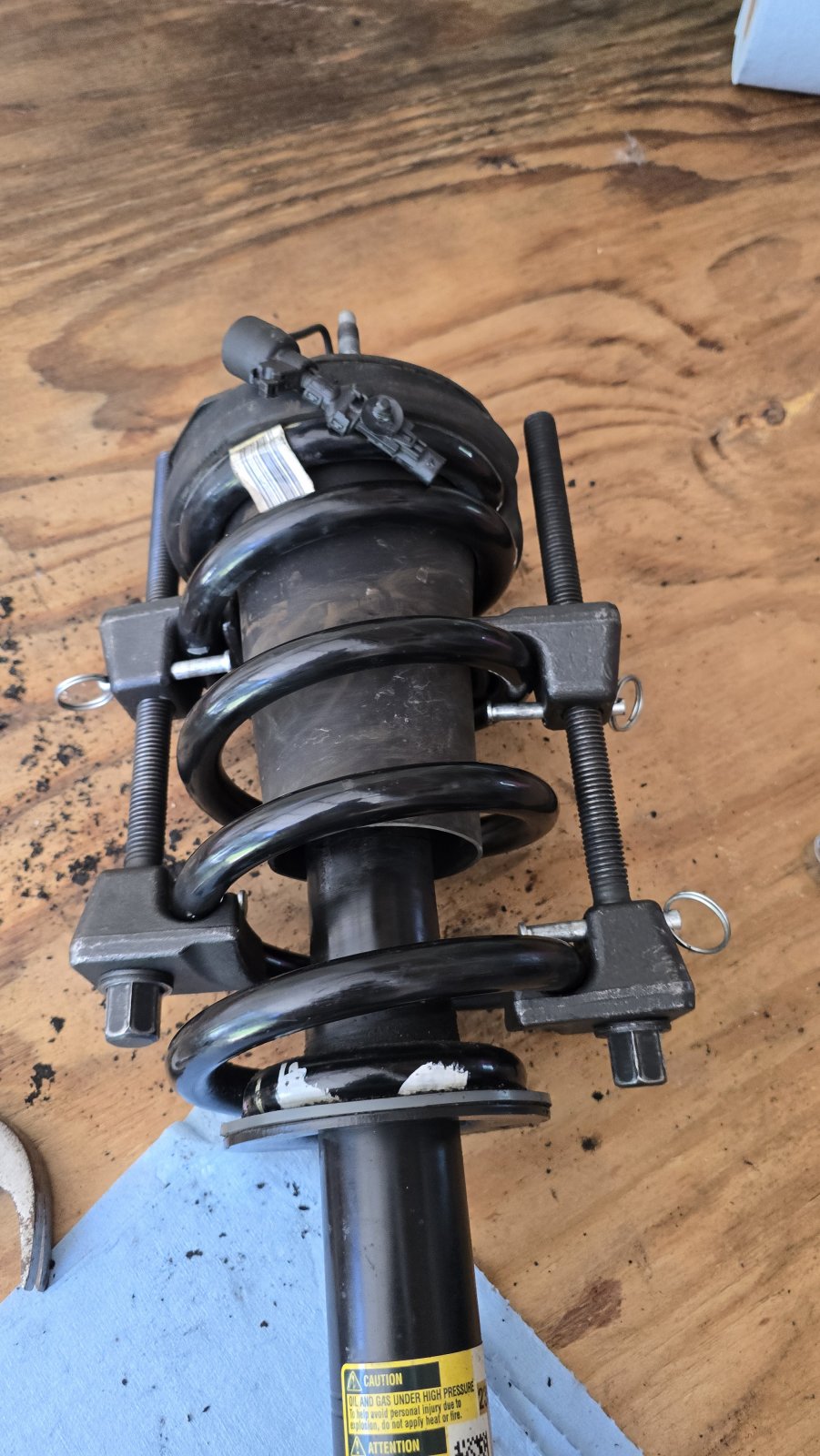

My dad hipped me to the fact the local Autozone had tool rental, where basically they charge you the price of a tool then refund it. Works for me as I was able to get a set of strut spring compressors.
Here began the trouble spots. So the spring compressors we got might have been just a tad undersized for the coil thickness. The compressors fit over the springs just fine but the safety slide pins would not click into place by hand. I was worried we would be in a bad spot but I was able with a hammer and extension bar chisel the safety pins in place.
I probably spent too much time the first time around tightening each compressor, but once i got it i got it and I removed the top nut with no drama. I go to get my new strut out the box when lo and behold I realize: they don't ship with a new connector. I wasn't expecting that but thankfully Im pretty comfortable with electrical work. To remove the old absorber from the coils you have to:

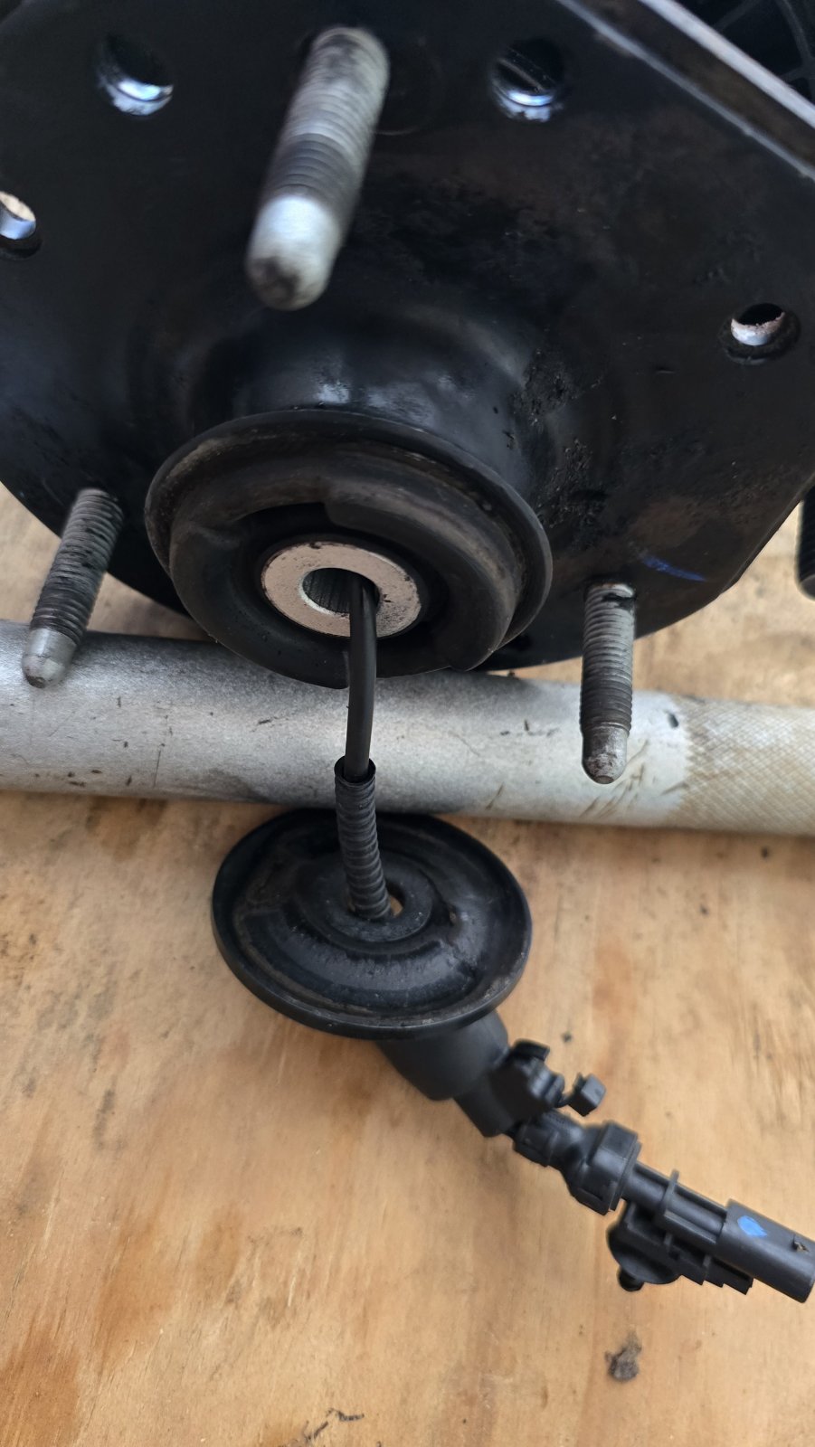

- remove the mounting plate after removing the top nut holding in place
- cut the old connector line, leaving at least 2" of line to re-soldier to the new strut

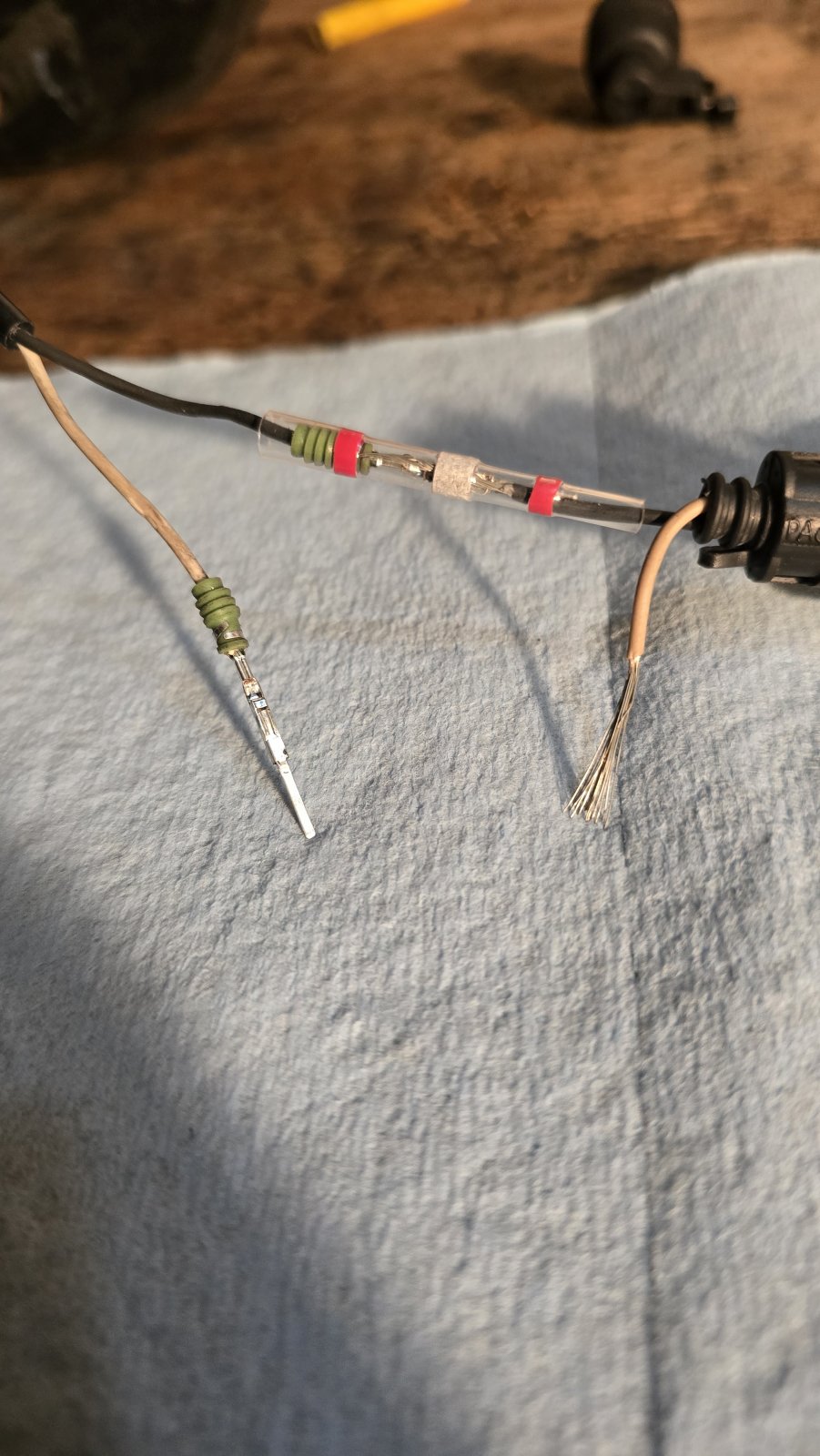

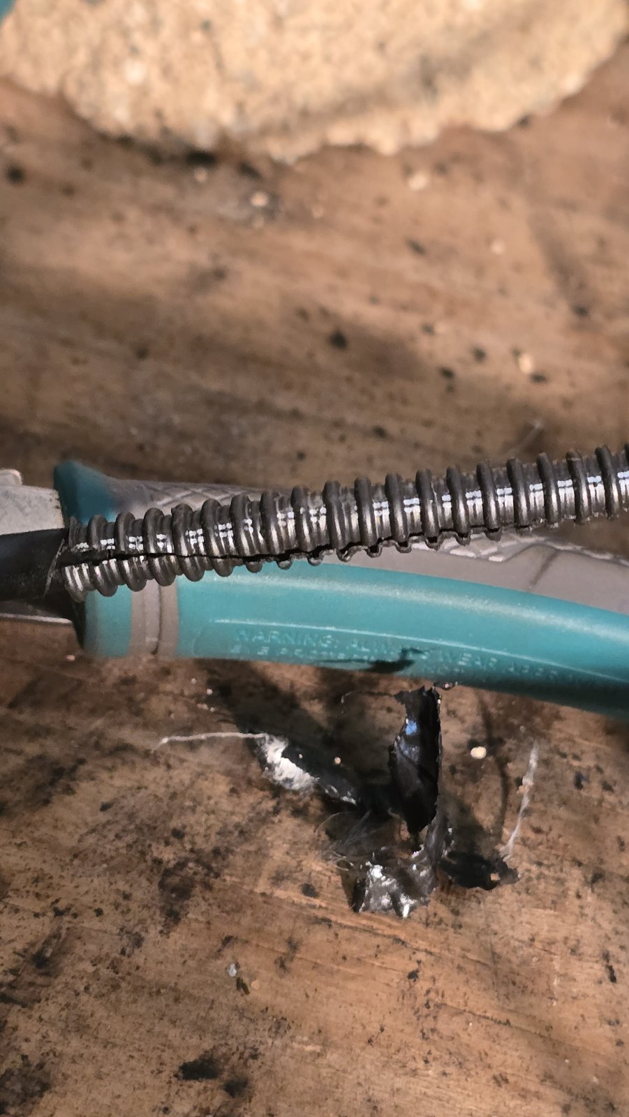

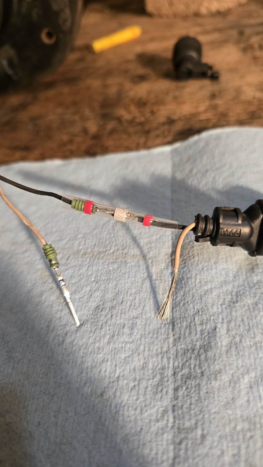

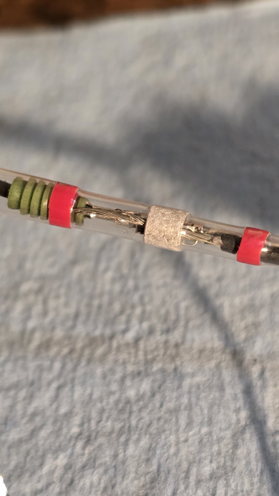

Once you snip off the old connector, remove the old strut and assemble the new one. You dont necessarily have to re tension the top nut yet, you can do that after soldering the new connector on, but that's the annoying part of these, you have to feed the line back through the mounting plate. I found it easier to cut a line vertically through the rubber boot that covers the top plate nut to make maneuvering the connector wire through easier.
To splice a new connector you can approach this one of two ways: disassemble the old connector housing and retrofit the new lines in the old housing. In my opinion this is a tidier approach, but is a tad more complicated.
Aaron hines has a really good video here on how he did this, around the 6:35 mark:
I opted for the messier, but more straightforward strip and soldier method
I couldn't find my old soldering iron, so I went back to Autozone and picked up a new one. While i was there I looked down the aisle and found an even better solution: splice butt connectors that self soldier when you hit it with flame. These are just like the regular heat activated non-crimping butt connectors but have a bead of soldier baked in, so all you do is strip both ends of your connection, slip the connector over each part and hit it with fire.
The two wires for the connector are 18gauge, so I got some for that size and after stripping the outer and inner cladding to expose the stranded wire on the old line you'll feed each 18ga wire (white to white, black to black) into a connector. I got a firestarter and it worked perfectly. You'll want to get your multimeter out after finishing any splice and soldier job to test for continuity. Hearing the meter beep after all this was one of the most satisfying things ever

Great job! That kind of spring compressor scares me! I'll never use that kind again! LOL
You know, after having to use them over and over it wasn't that bad. As long as they are sized correctly they will hold pretty well. The key is doing the best you can to have each compressor close to 180° opposite each other. And when you tighten each side with your impact gun do so in even amounts.
Definitely if you have access to a shops wall mount compressor use that! Far better!

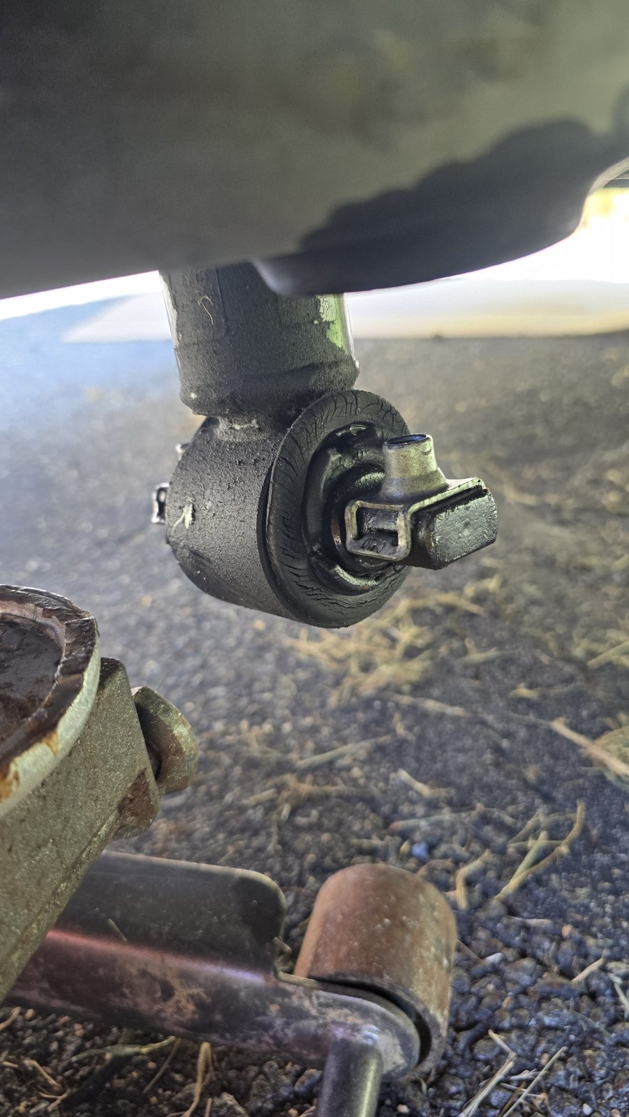

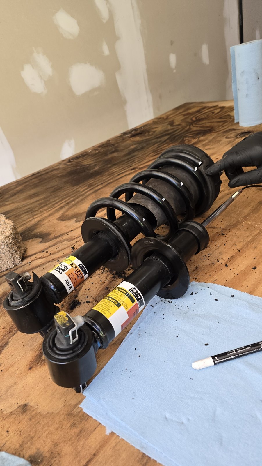

For the passenger side front my dad recommended this - and glad of him to realize this- if you remove the wheel skirt you can pretty much get lateral access to remove the strut. This is key since getting at the top plate from the top is much harder due to battery, coolant lines, etc. You'll need a 7mm socket, flathead screwdriver, and a T10 torx bit to remove all the pins. Once you do the skirt comes out easy.
Working on thr second strut went pretty much like working on thr first, but because of one minor oversight this actually took the longest.
You'll need to note the orientation of the bottom elbow of the strut in relation to mounting plate bolts BEFORE you disassemble the spring from the shock. If you dont then the elbow can be mis aligned and you won't be able to install the reconfigured strut.
Yall, I attempted to put a single strut in no less than SIX times. Lets just say I got really good and really comfortable with the spring compressors
A rule of thumb (that i learned after the fact) is thr bottom elbow bolt holes need to be perpendicular to the single bolt thread that is marked on the neck of the strut. And usually when the strut is installed one bolt thread will be in front facing you with the other two in rear. Make sure you make note of this when you go to reassemble the spring. The only time you can spin the lower elbow is while the springs are compressed and the top nut is loose.
