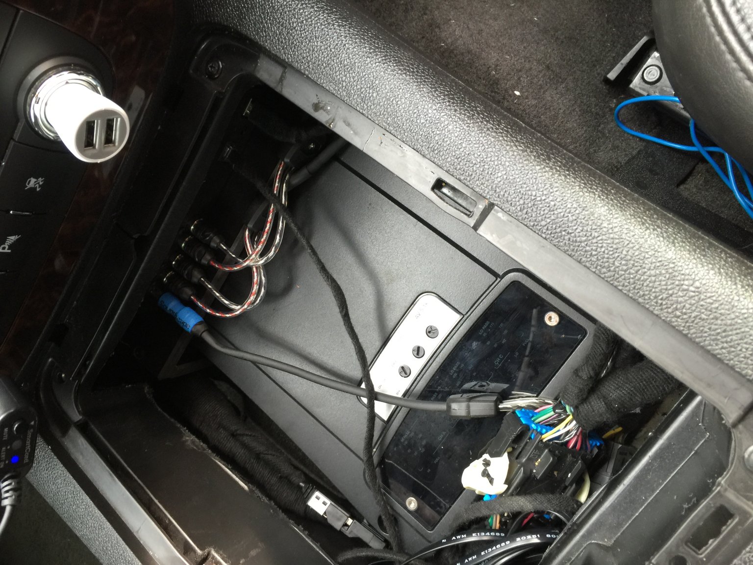

This is my 3rd system running in my Yukon Denali. This time I wanted to run SQ competition grade audio equipment but keep all/ cabin cargo space available.

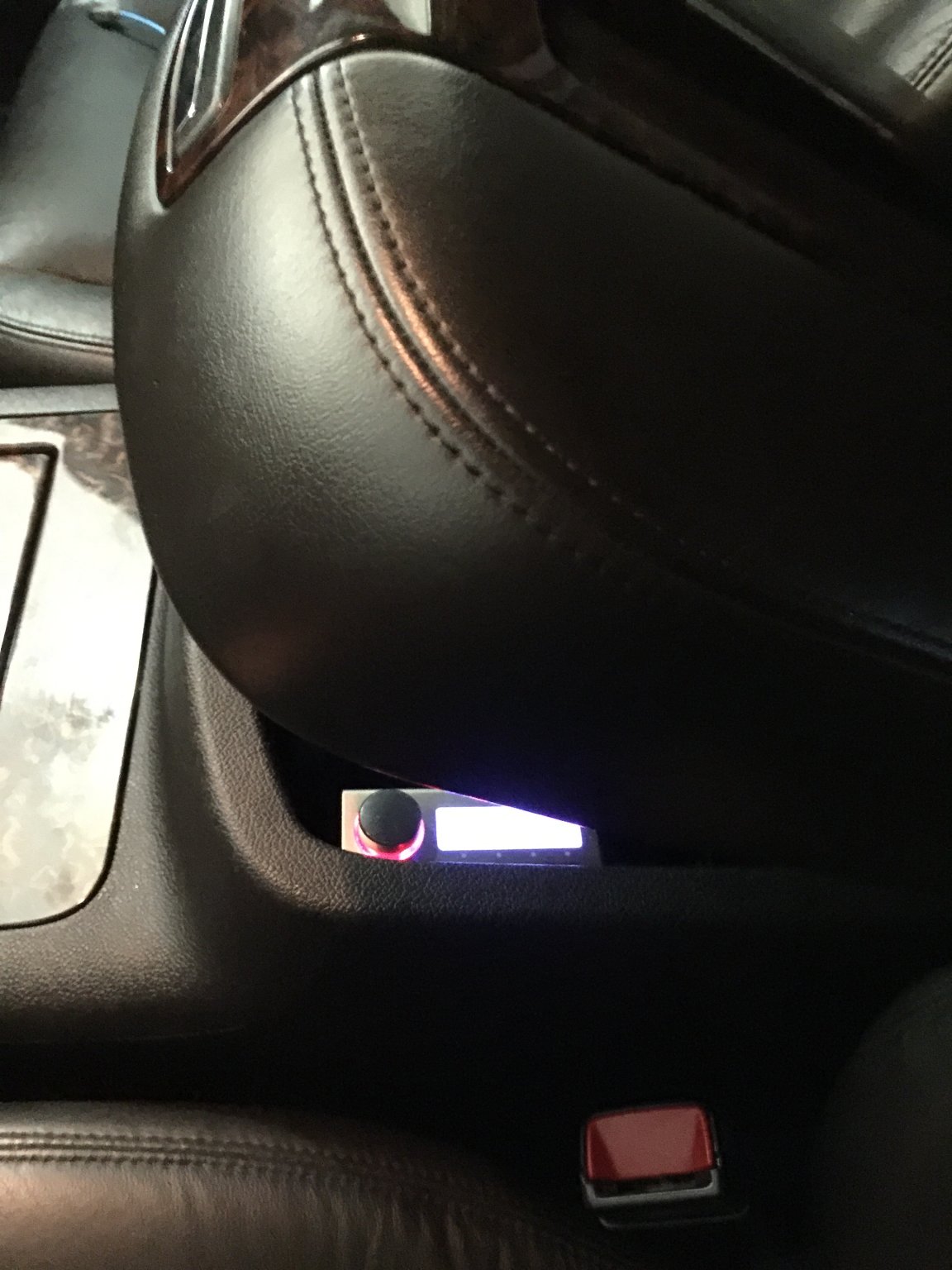

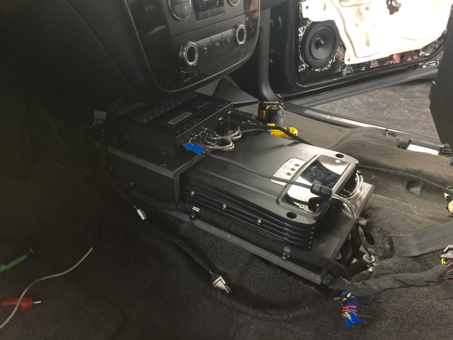

Amp-Audison Voce 5.1K 5 channel amp. Class A/B for mids and tweets and Class D for the subs. Amps rated at 1700 watts with a very low distortion rate. One of the finest amps on the market. Cleanest sq amp I have owned to date.
Audison Bit Ten- DSP. I highly suggest running a Dsp vs loc for any audio upgrades. This provides the best quality signal along with allowing you to correct timing, EQ, and more features than I will list. It also takes the place of any passive crossovers needed for a component set.
Hybrid Audio Technologies Legatia speakers-
L6v2 7.1" midbass woofer (actually fits perfect in our Yukons/Tahoes with custom mdf baffles)

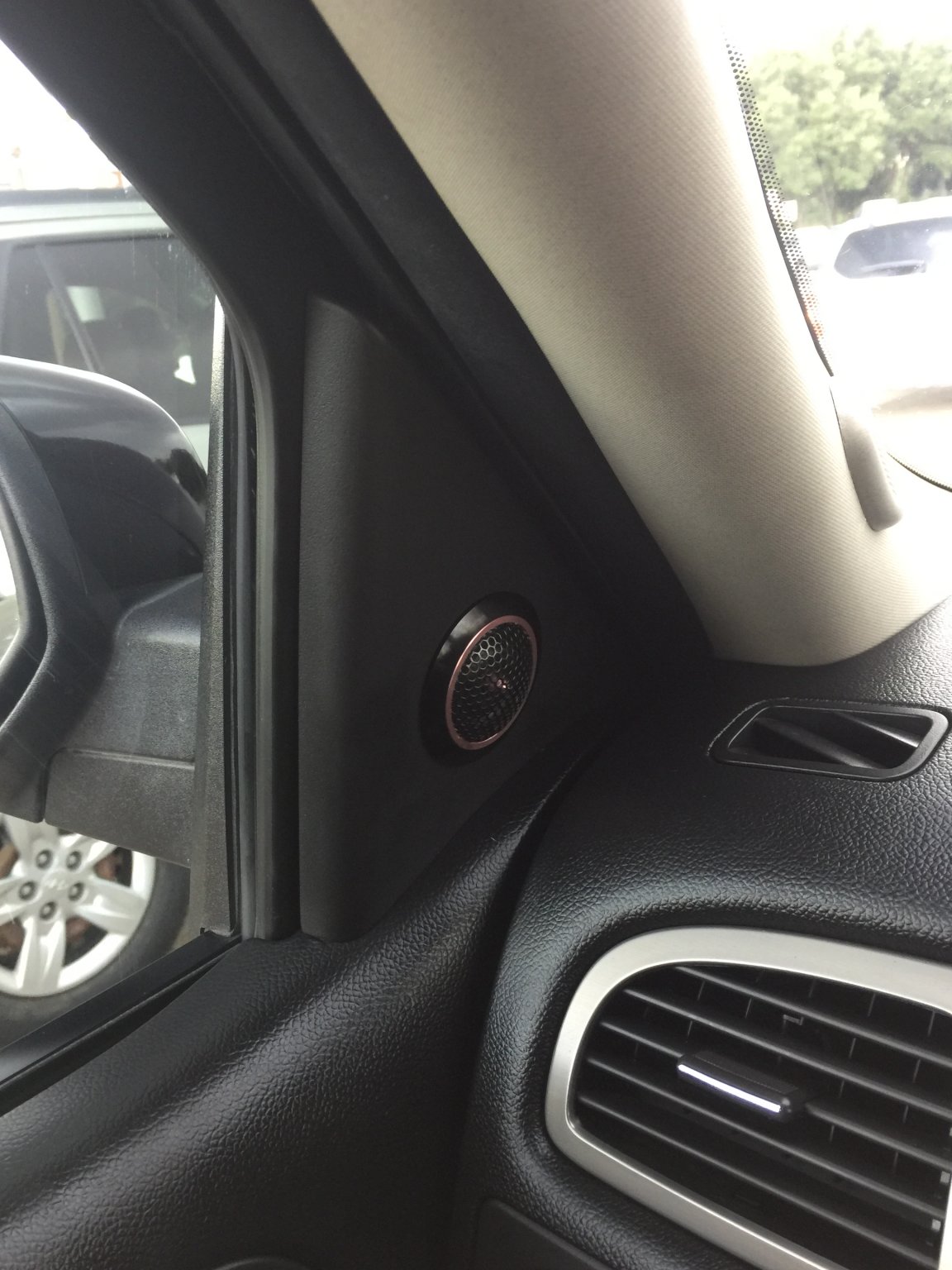

L1ProR2 tweeters- these babies sing. Too big to fit behind the Bose stock tweeter location so moved into sail panel.

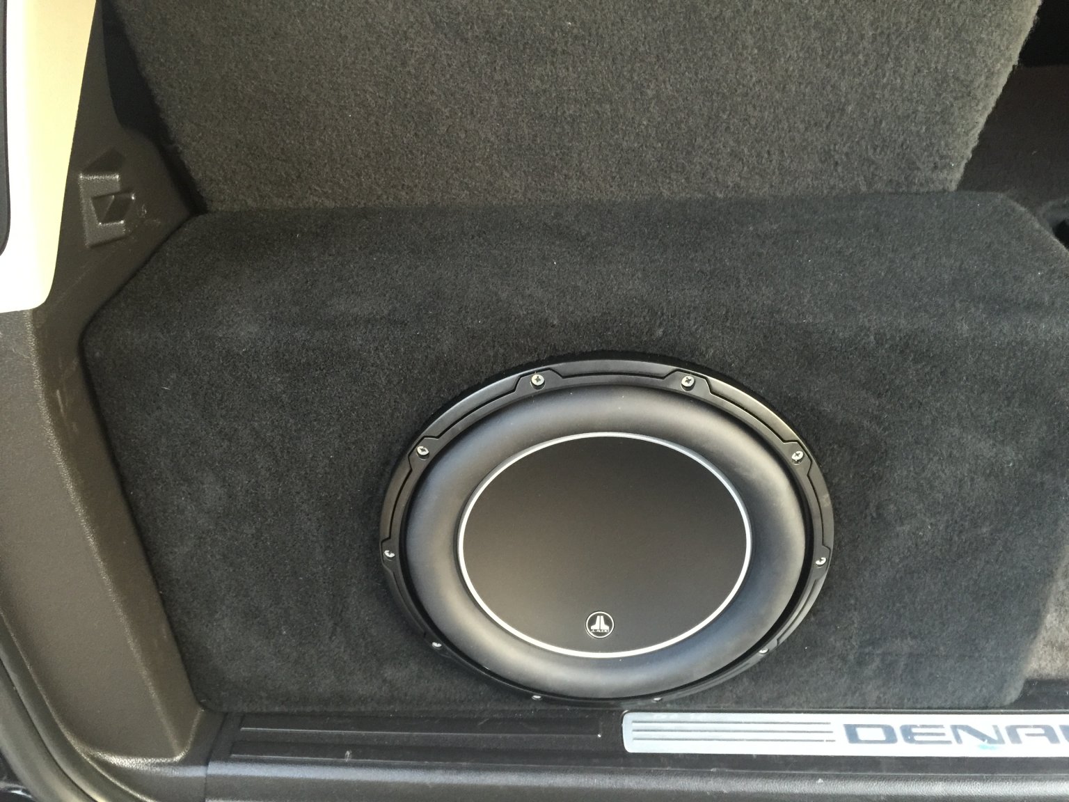

A JL W6v3 is handling sub duties for me. This is JL's finest SQ meets SPL sub available. The best part is it doesn't take a large enclosure to pound. Which is perfect for behind the 3rd row and still allows space for cargo.
Dynamat www ran in all 4 doors, inner and outer skin, along with the floor area below speakers. I ended up adding some to the back of my license plate and bracket to stop rattles and in the sunroof area above the rear view mirror.
Very happy with the sq and it's the first system that I could literally turn up full blast and have zero distortion or clipping.

Thanks - it's my 3rd system in my Denali. Each one is more SQ oriented. I'm still working on this one.
Flipped out the JL 12w3v3 for its bigger brother thr 12w6v3, dual 2 ohm sub. Highly recommend taking the step up. Fits perfect in our vehicles behind the 3rd row and still space for storage.

And it does have a grill.. Just wasn't installed when I took the pics.
