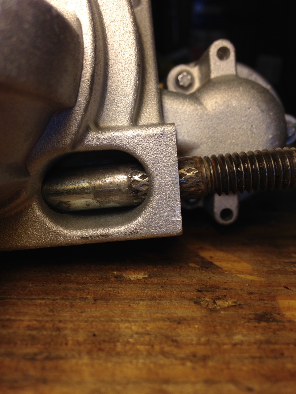

Just throwing it out there, but how long are your starter bolts? The correct bolt for the gear reduction is about 4-5/16” long but some early starters (the big direct ones) may have used longer ones. If you had to use spacers to get the bolts to sit, then you’d need to change the bolts. Photos of gear reduction starter and bolts…

I noticed one of my bolts has a bend in it now ... and I'm at work but I will measure them in the morning and follow up . I didn't think much into the bolts because I took a gear reduction off and replaced it with the same . And I don't think it was bent before .
