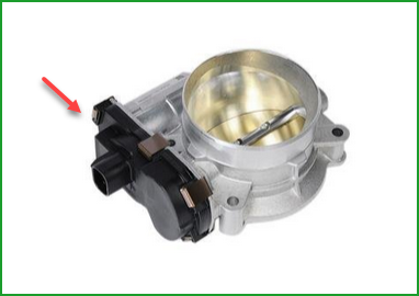

Make sure the RVC is plugged into the current sensor on the negative cable right off the battery. If unplugged, the alternator will run at maximum output all the time.

Would you be able to drop a photo for reference
Here

Ok the plug in that’s fixed to the condenser ??

No the black ring next to it around the cable with the black/pink plug.
Yea it plugged in, took it to my mechanic and he said it’s fine. Put a really nice reader on it. And no codes other than some communication codes in the electrical stuff(not relating to the engine)
Did some voltage tests on the battery and alternator. He said those check out too so. I guess I’ll just keep an eye on it when i start it in the mornings
