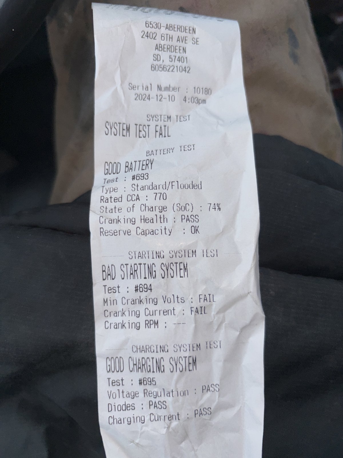

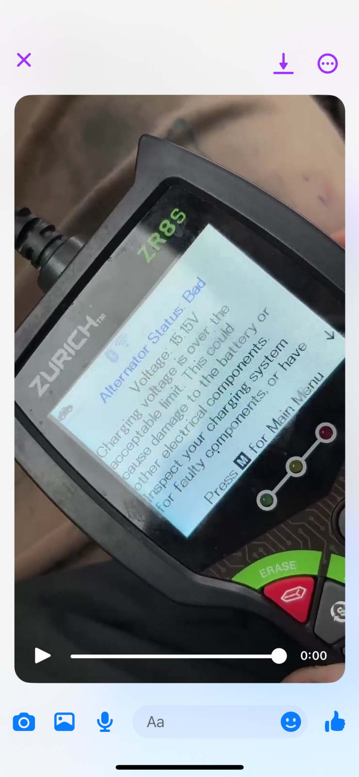

2014 Tahoe 177k miles. So the last few days, it’s been getting pretty cold and I noticed my truck kinda bogs down like it’s gonna stall for a split second when first starting it and than rpm go back up. I did a battery and alternator test with my OBD reader and it passed on battery but alternator failed both tests. (Took two to make sure) it has me hold the RPM at around 2000 for 20-30 seconds. So OK I’m like all right no big deal. I’ll order an alternator and get it taken care of. But I wanted to be 100% sure so I took it to AutoZone and have them tested with their little thing and I guess they are telling me my starter is failing and that my alternator and battery are fine. So I guess I’m confused because results are contradicting each other.

its ok, the scanner is just a generic thing that was probably right for older vehicles without computer controlled charging.

And I also had auto zone run some tests. There reader said starter was bad. But then again, everyone tells me not to trust AutoZone or any parts store for that matter.
I heard these scanners can mimic just enough voltage to get a good reading

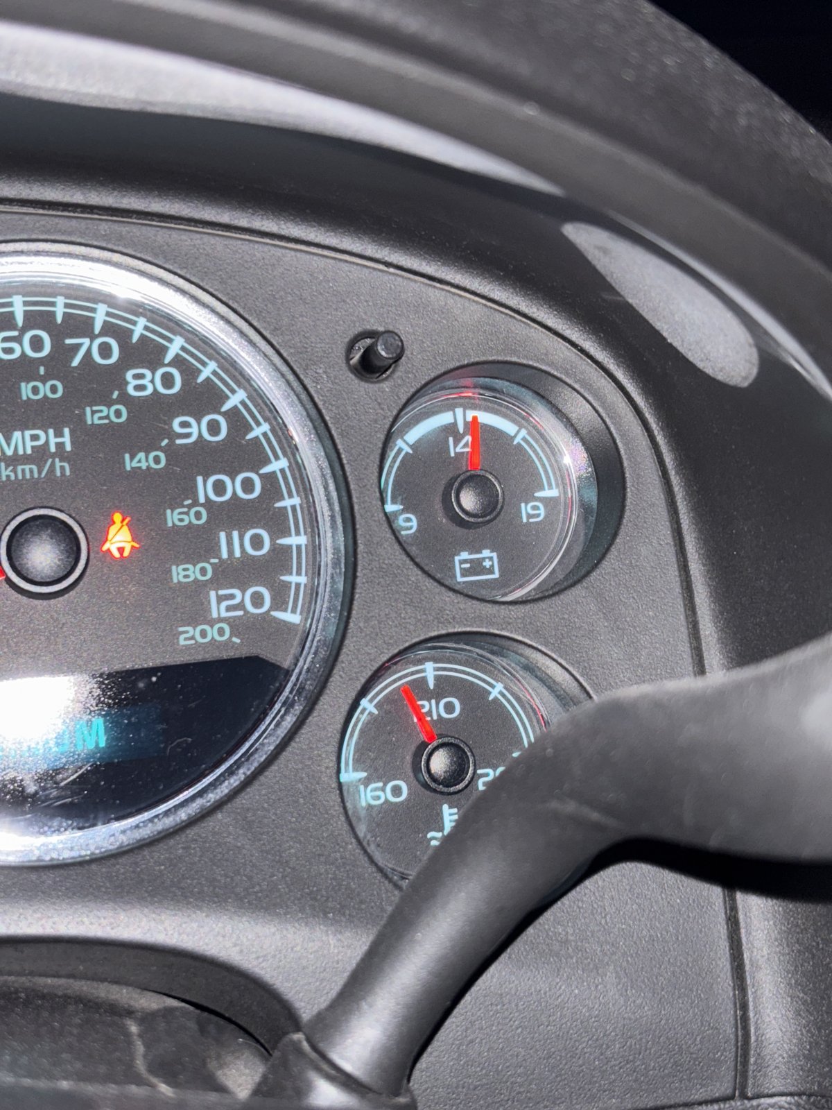

Sitting perfectly at idle… would that mean I can rule out the alternator? Sometimes the headlight dim when I first take off as well.
Taking it to my local
Shop tmrw to hopefully get some more answers.
