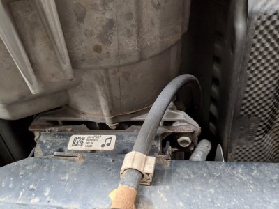

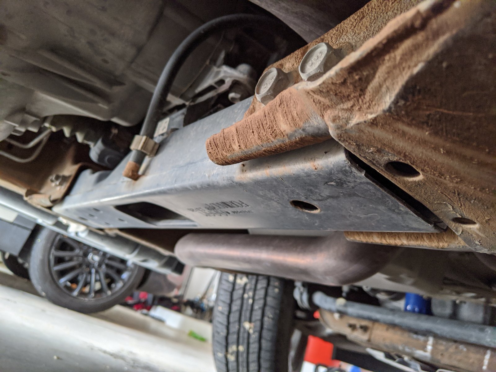

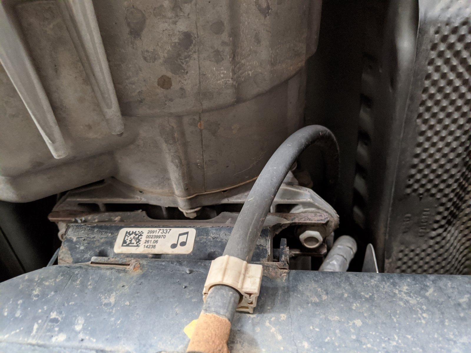

I feel like I was able to rule out the transmission, although I did notice for the first time that the transmission crossmember is not original to the truck (probably a red herring for this issue). It doesn't have the same waxy undercoat as everywhere else. (undercoat is covered in sand and silt from a couple remote camping trips in southern Utah, not rusty).
I also noticed the trans support has some musical notes... It's off topic, but still interesting.
The more time I spend under the truck while it's squealing, the further forward I think it may be. I'll have to drop the plastic skid pan and do some more stethoscope-ing this weekend. I'll update with results.
