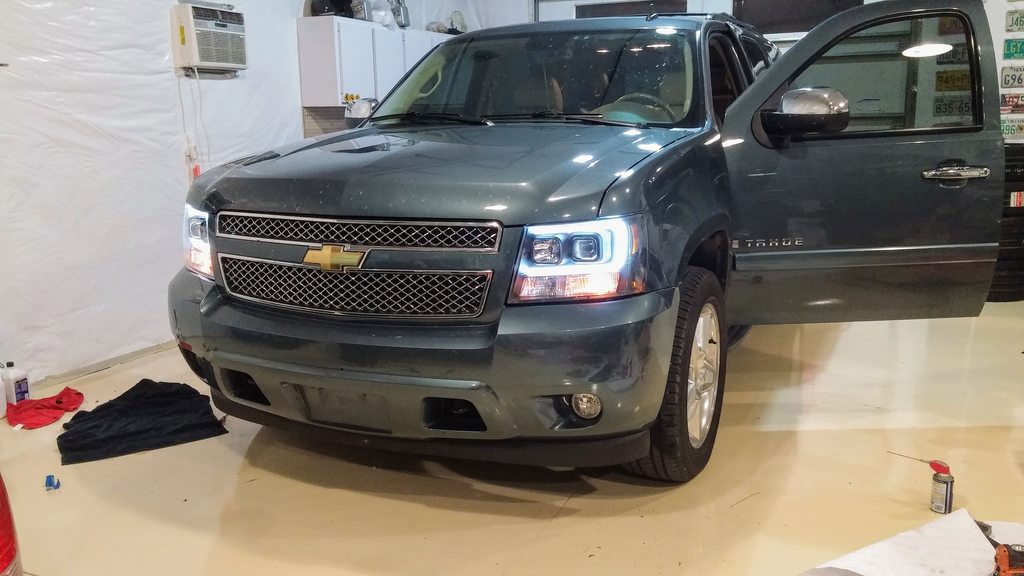

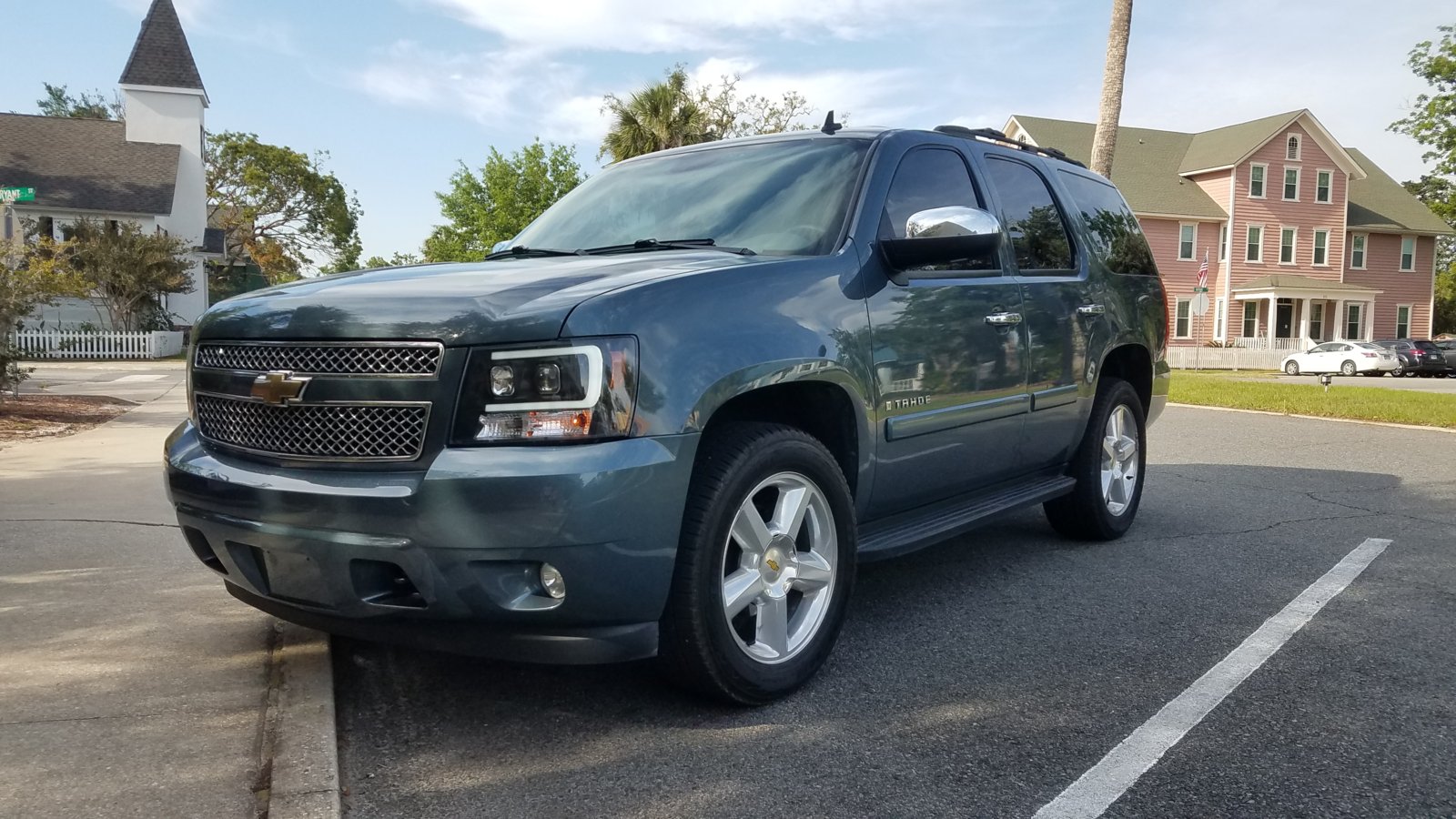

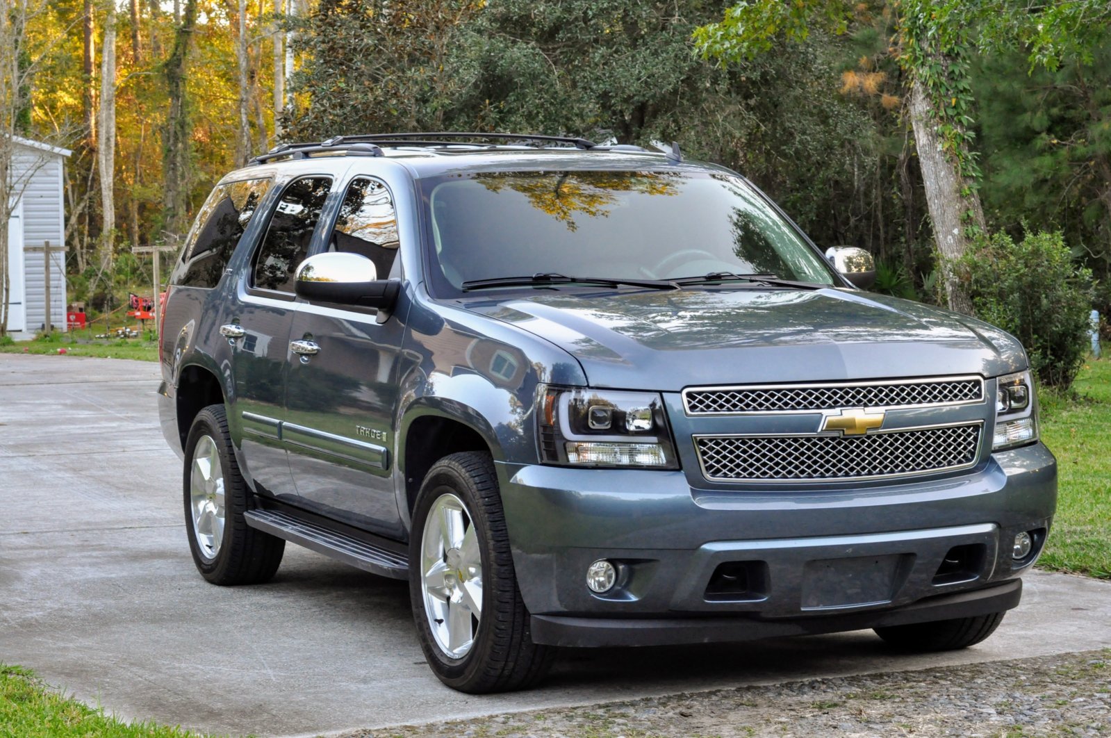

I run spyders in several of my cars. The beam pattern is horrible in all but the tahoe. On my other cars i ripped out the spyder projectors and installed TRS ones. The square ones my tahoe are actually very good. Great beam, great cutoff with HIDs. I highly recommend them
