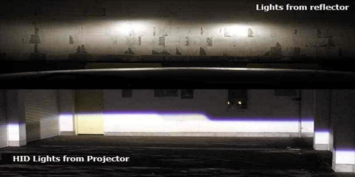

If both the high beam and low beam positions in your housings take the same bulb, then you'd need two pairs. Even though they use the same bulb, the high beam will be brighter and scatter the light higher and over a wider area since it's a standard reflector housing. The purpose of the projector in the low beam housing is to tone down the brightness and focus the light to be more on the road and stop at a certain point (the "cutoff") as to not blind oncoming traffic. At this price point, the projectors aren't as clear or efficient as those in the high-dollar aftermarket kits or OEM in high-end cars. So, they often require a more powerful light to compensate, which would be an HID.
Generally, the "ebay" aftermarket projector lenses will yield a beam pattern that's something like 50/50 of the reflector and projector patterns in the above pic. They also will commonly have "flares", which are rays of unfocused light shooting upward at angles away from the intended projection area.
