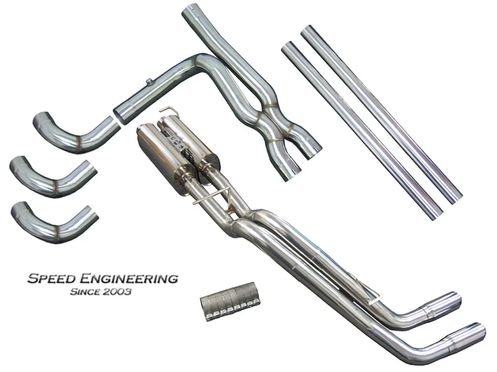

Speed Engineering makes a nice Stainless Steel 3" Dual Exhaust kit for GM Trucks. Have any of you tried using it on your Tahoe? The only real question is will the over the axle pipes fit with the coil spring suspension vs the leaf springs that the trucks use.

I'm just wondering if the over the axle portion will work with the Tahoe rear suspension vs the leaf spring suspension on the Pick-up Truck it's designed for. I asked Speed Engineering, and they wouldn't commit, and don't offer a Tahoe / Suburban specific kit.

I cant help there. I would guess it may be close, but with it being developed for leaf springs vs coils and control arms it may be off by an in or a mile.
You could always use what works and have the rest fabbed at a shop. That's probably what i would do anyway, as ive never been a fan of the duals on one side of a vehicle. But that's just me.
