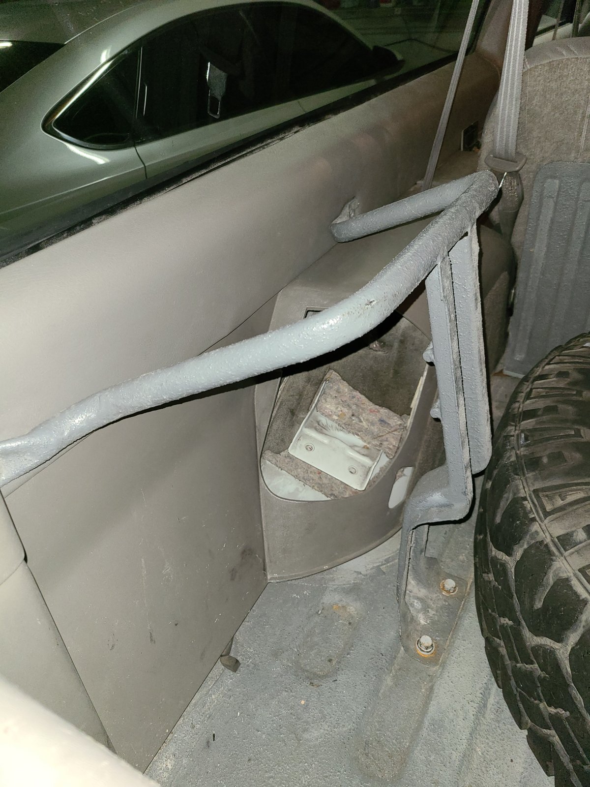

Hi All, I've been restoring a 98 2 door Tahoe and the previous owner lost a molding and some of the parts to bolt on the spare. Does anyone know where I can find them? Tried some junk yards, but not easy to find.

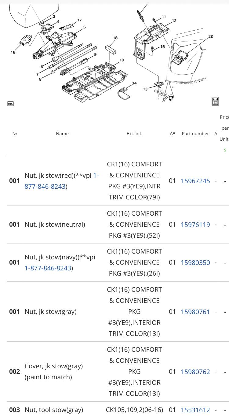

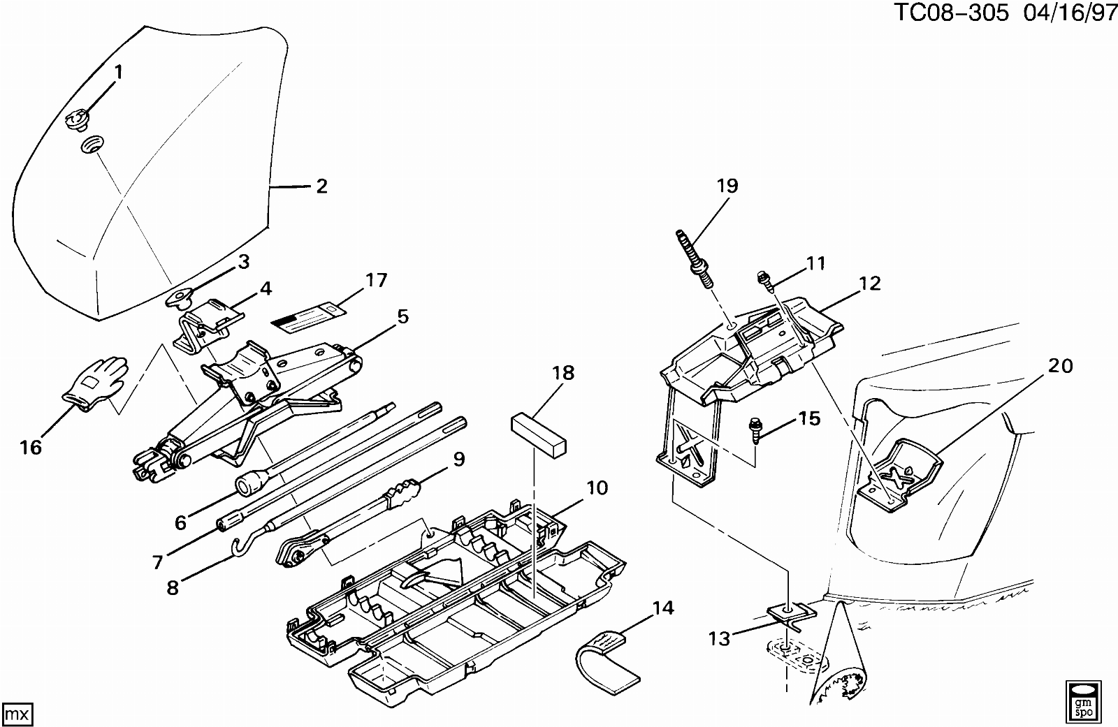

This site has the old parts diagrams which will give you the GM part number. You cannot order from them, and the site is usually overrun with ads, but it should help in your search.
https://nemigaparts.com/cat_spares/epc/chevrolet/54c-k/
A two door Tahoe is denoted by 105 (16) in the model code. A four door Tahoe is 107 (06) and a Suburban 109(06), so that identifies what is specific to each model. Here are the spare tire diagrams from the site:

Just thought I'd bump, if anyone has atleast #2 , the jack cover I'd buy it off them. I can't stand looking at that hole.
