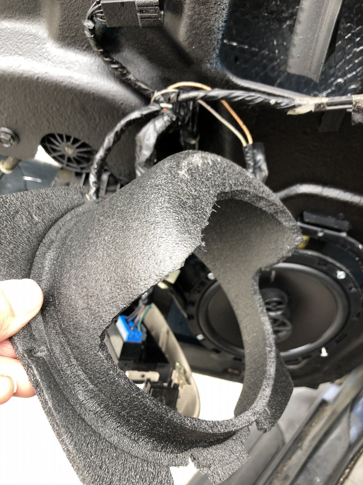

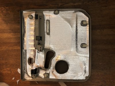

Nicely done. I just went through the same process... Noico butyl sound deadening on the inner metal walls inside the doors, Boom Mat butyl spray (two layers) on the outer metal walls inside the doors, Siless Liner padding foam on the interior of the door panels, foam speaker rings and speaker baffles (cut out - credit to Rocket Man for the tip). I also covered a good portion of each wall of the rear panel woofer box with Noico.
I didn’t think my rear view mirror would be vibrating as much as it does, night and day difference.

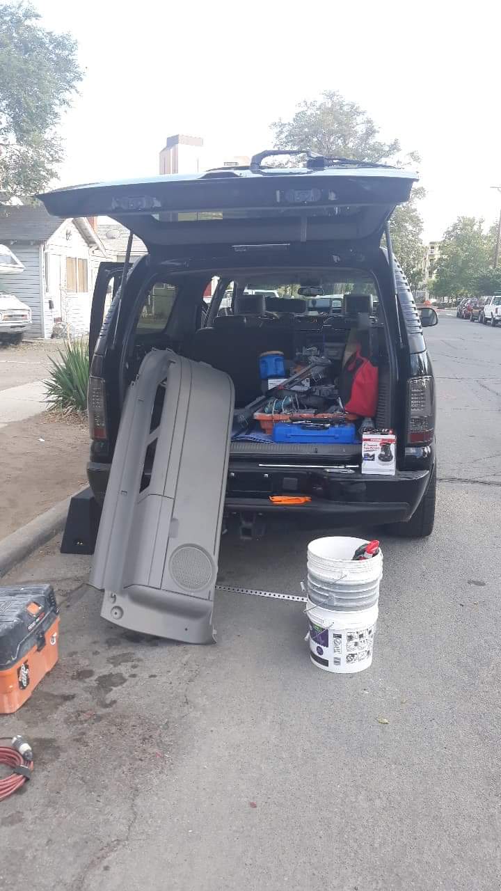

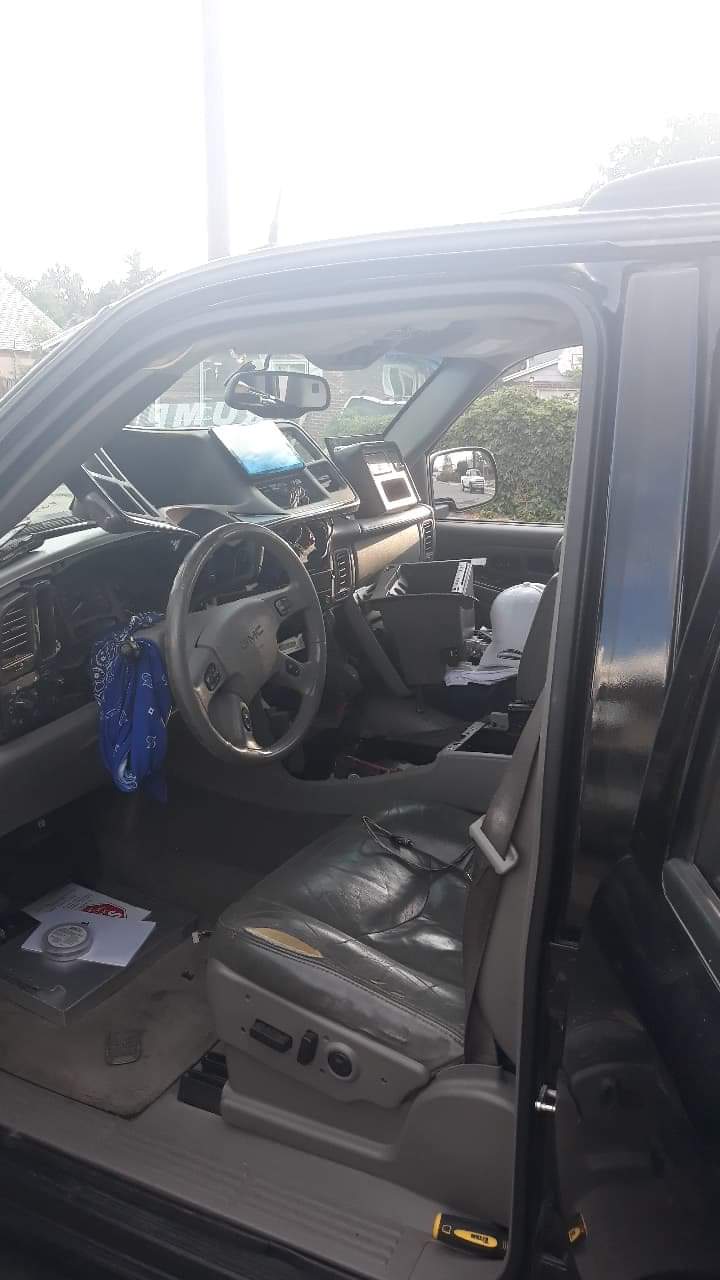

Here's a picture of how I mounted a 9 inch touch screen without modifying the interior bezel it's not for off-road use it would need a few more nuts of course I need to do more plastic welding on all the little tabs but I'm going to wait until installing the subwoofers

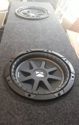

Unfortunately I didn't purchase as much CCF as I should have so I need to use it fairly sparingly I'm considering that my subwoofer box is just a eBay pre-manufactured type I'm wondering what to do about it I'll probably crack the interior open tomorrow and get the amplifier mounted apparently the 2002 Factory location is exactly where I was planning on mounting mine luckily I have a 2004 so I hope that spots open forward the wheel well driver side
