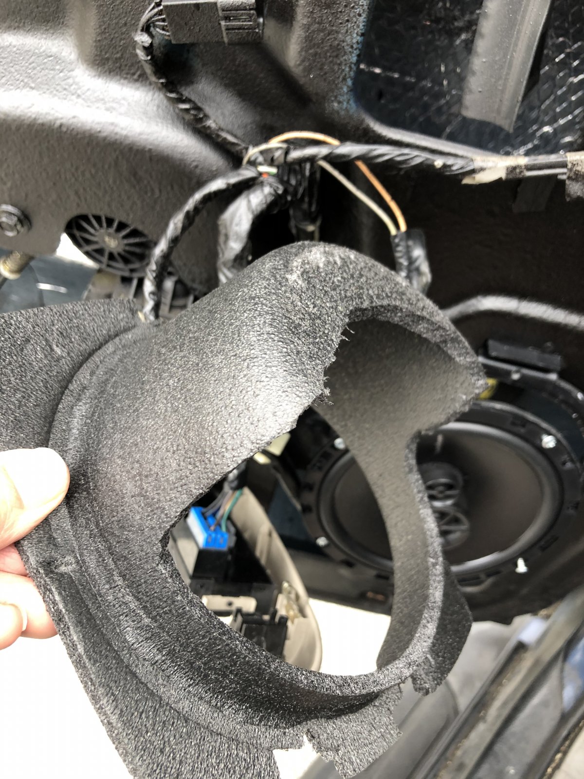

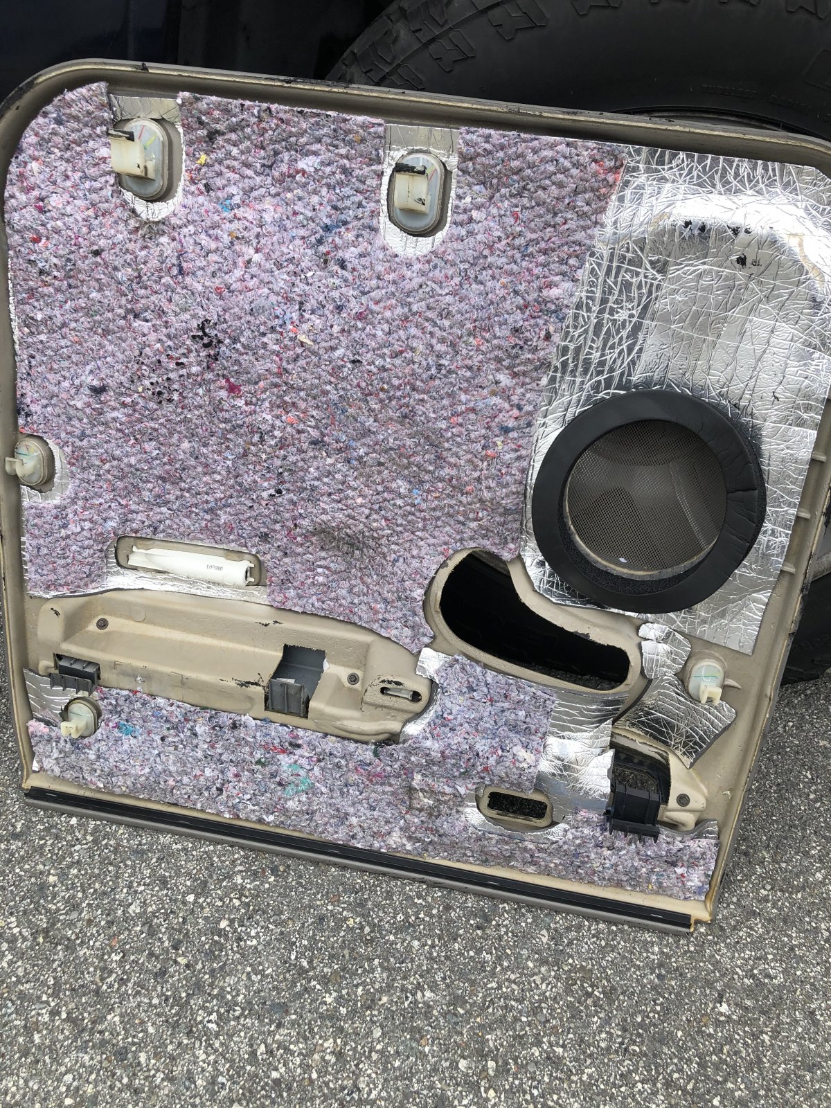

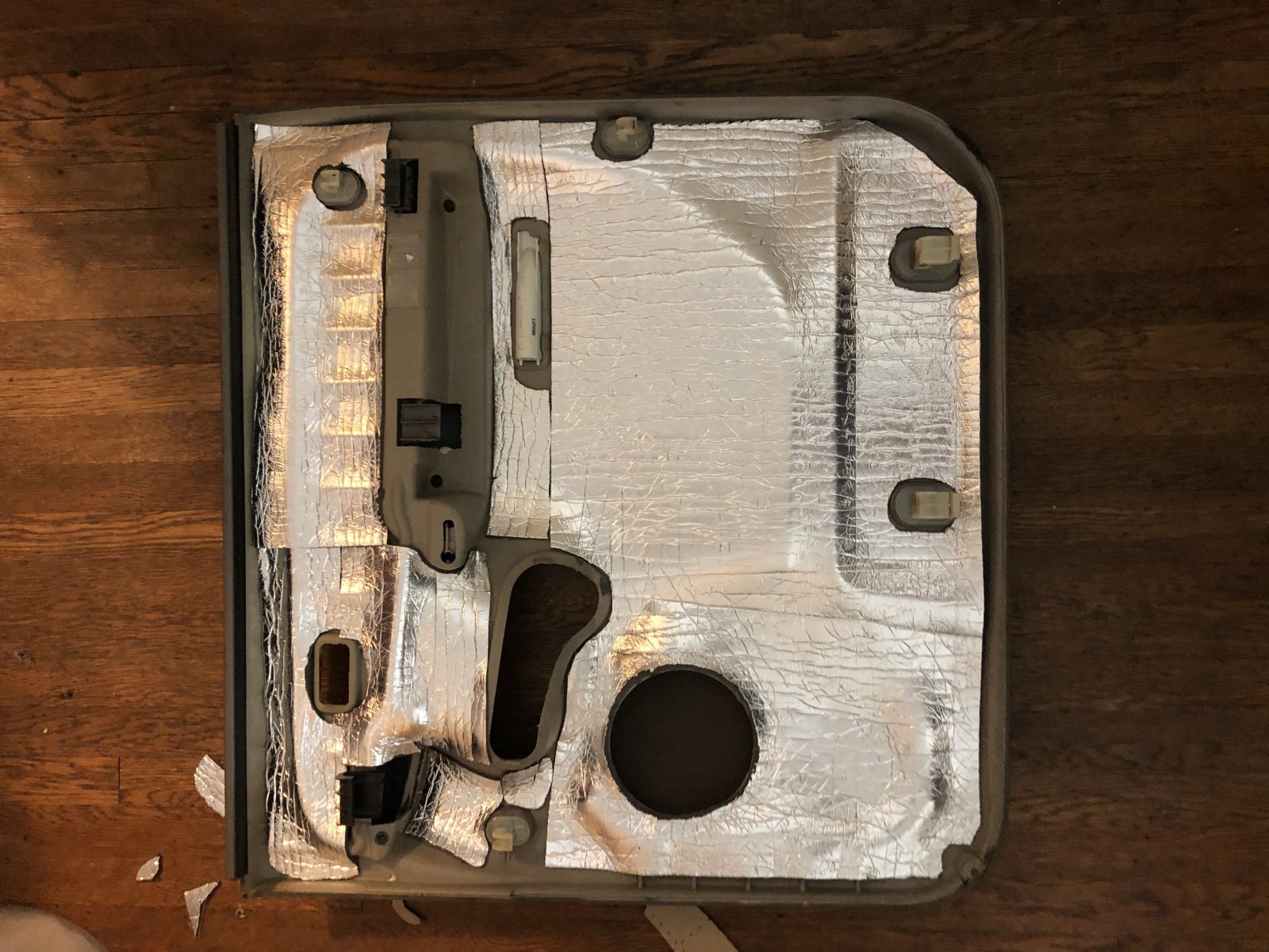

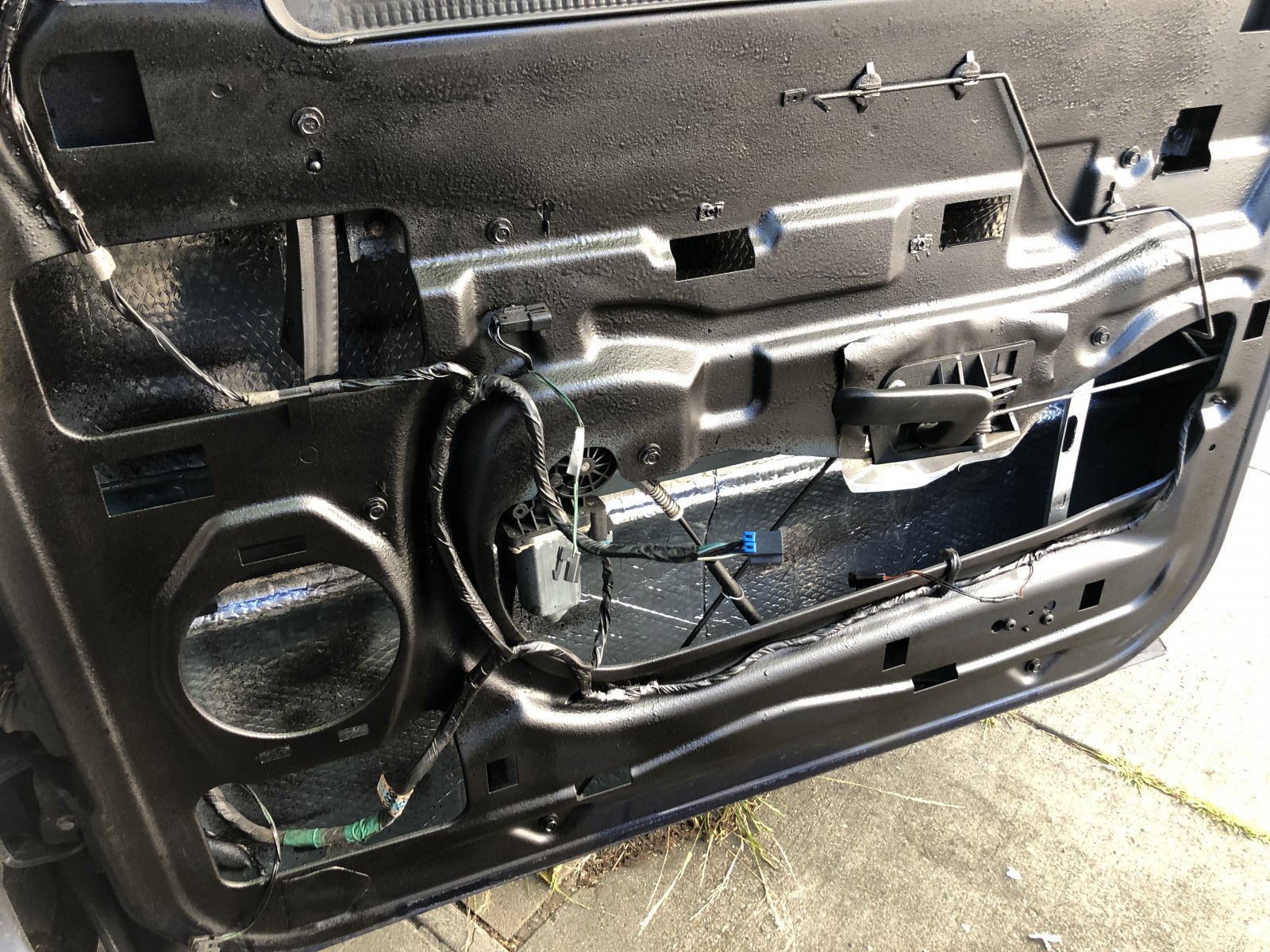

Nicely done. I just went through the same process... Noico butyl sound deadening on the inner metal walls inside the doors, Boom Mat butyl spray (two layers) on the outer metal walls inside the doors, Siless Liner padding foam on the interior of the door panels, foam speaker rings and speaker baffles (cut out - credit to Rocket Man for the tip). I also covered a good portion of each wall of the rear panel woofer box with Noico.
I didn’t think my rear view mirror would be vibrating as much as it does, night and day difference.

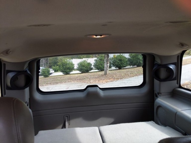

Btw there is a company which makes speaker pods to fit 6.5” speakers onto the D-pillars, but they’re a bit pricey at $110
https://www.customspeakerpods.com/product-page/d-pillar-speaker-pod-for-6-5-00-06-gmfst
If you go this route, might be a good idea to cut out a portion of your actual D-pillar to increase the enclosure size for the speakers.
Yeah those are way out of my budget and as much as I like an aftermarket stereo I like it to look more or less Factory

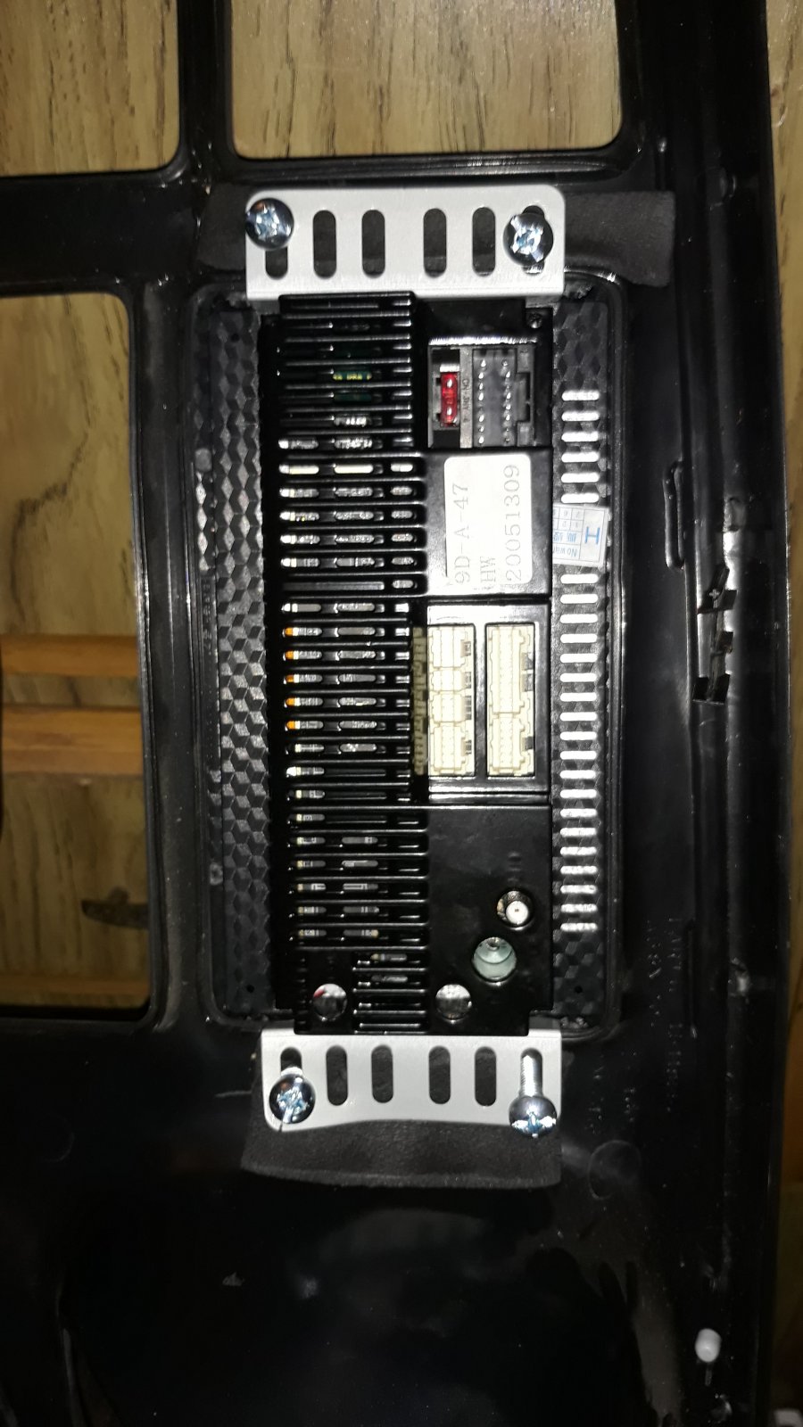

Here's a picture of how I mounted a 9 inch touch screen without modifying the interior bezel it's not for off-road use it would need a few more nuts of course I need to do more plastic welding on all the little tabs but I'm going to wait until installing the subwoofers

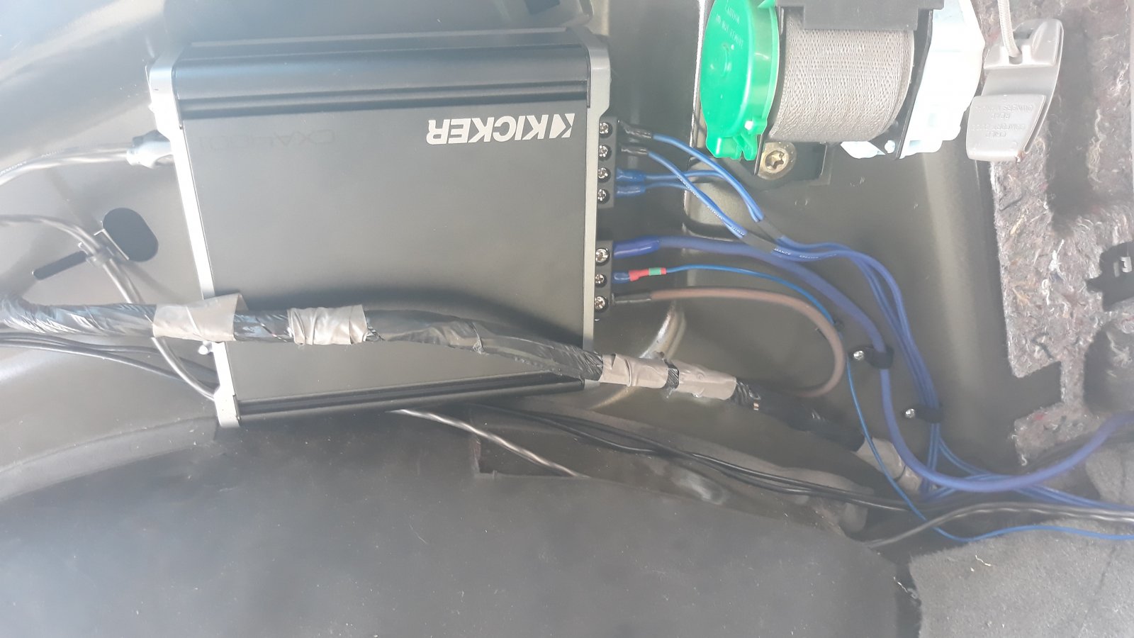

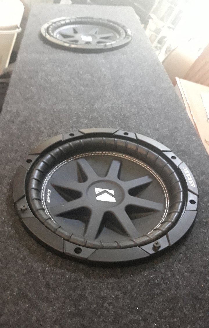

Unfortunately I didn't purchase as much CCF as I should have so I need to use it fairly sparingly I'm considering that my subwoofer box is just a eBay pre-manufactured type I'm wondering what to do about it I'll probably crack the interior open tomorrow and get the amplifier mounted apparently the 2002 Factory location is exactly where I was planning on mounting mine luckily I have a 2004 so I hope that spots open forward the wheel well driver side

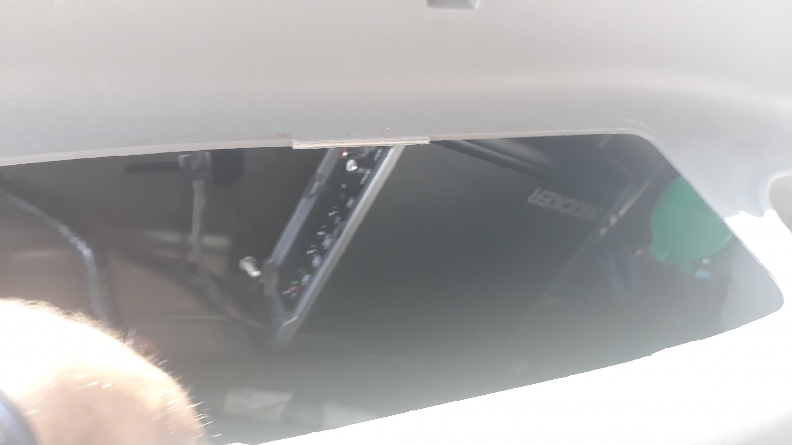

Thats convenient

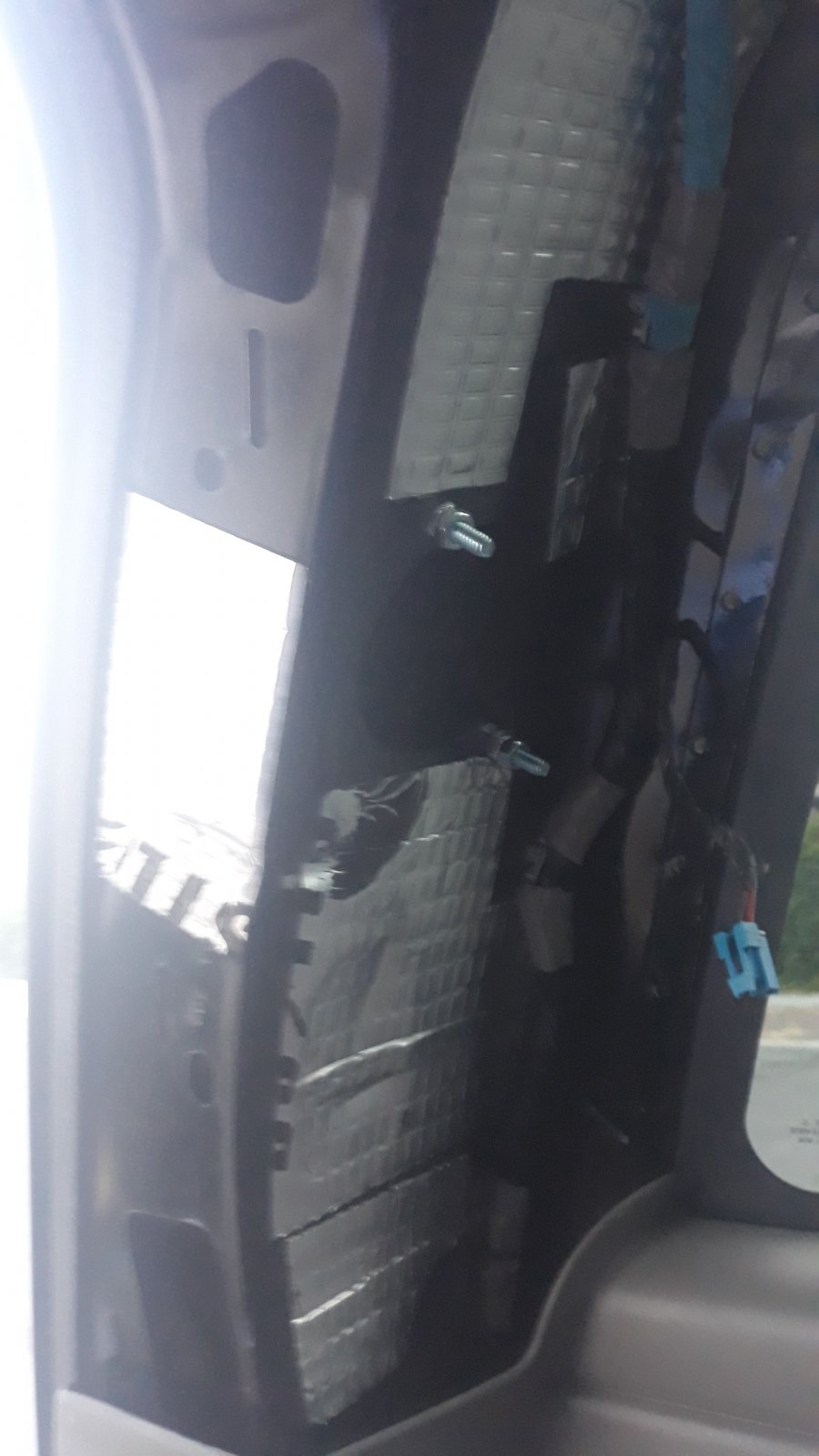

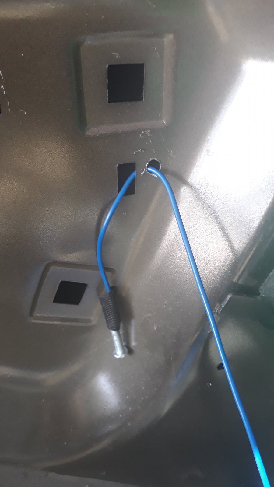

And thats how i got the bolts in
druiddonn
druiddonn
Oct 3, 2015
112
128
That's the cubby hole on the back of the Denali XL 04 and I will be able to adjust the amp without removing the entire panel because I mounted it in the 02 Factory location the other one photo is just showing how I got the bolt to poke out of the hole since I couldn't fit my hand back there

Here's the link for the sound dampening I used I didn't find it super expensive 26 square feet will Almost Do the vehicle I also used CCF but only right behind the speakers and in places that I think wires are going to rattle
I bought Kilmat 80 mil for about the same price per sq ft ($1.40 as opposed to $1.25) for that 50 mil. when I did my Silverado but I just did the interior of the doors themselves. I should have been more thorough. I need to redo them anyway since I pulled it off to swap out the latch mechanisms and it didn’t go back on perfect.

That's a good price I basically just got enough to do the four doors with a little bit left over for the A&D pillars I don't have anything for the floor or the roof and I really don't plan on taking the interior that far apart
My understanding is that something like 30% on the sheet metal makes a huge Improvement I just did the flat areas but even as bad as my hearing is it's a major upgrade even with these cheap speakers I paid 115 for all eight speakers and my two tens cost me $230 that was the box that amp the install kit and the subwoofers the thing that's killing me is the special adapter for the Bose system otherwise I think my whole system would have been under 500
