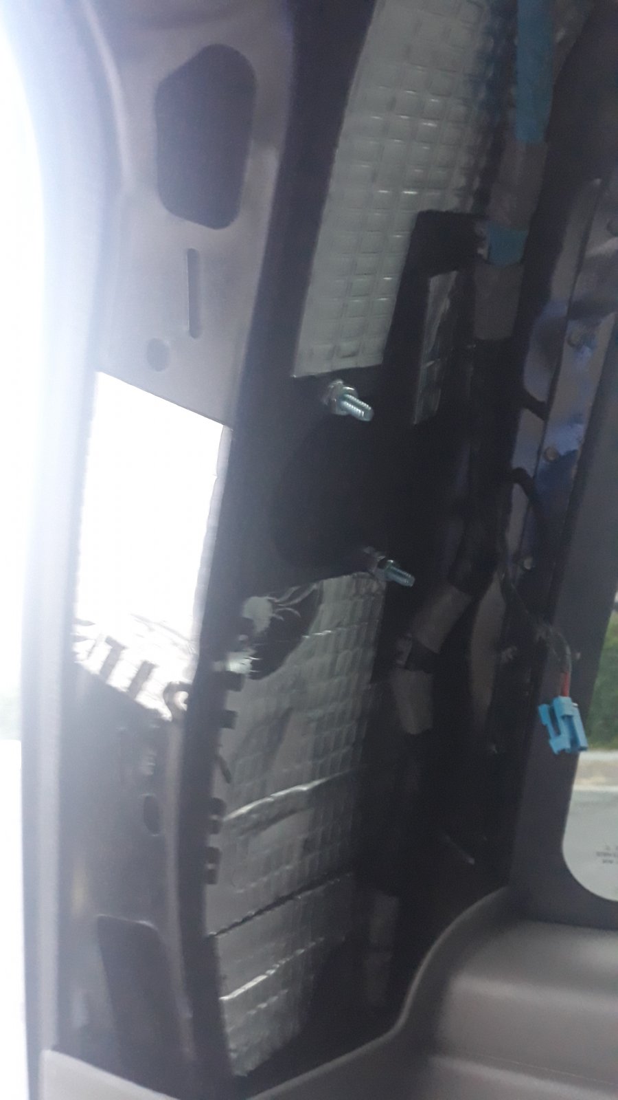

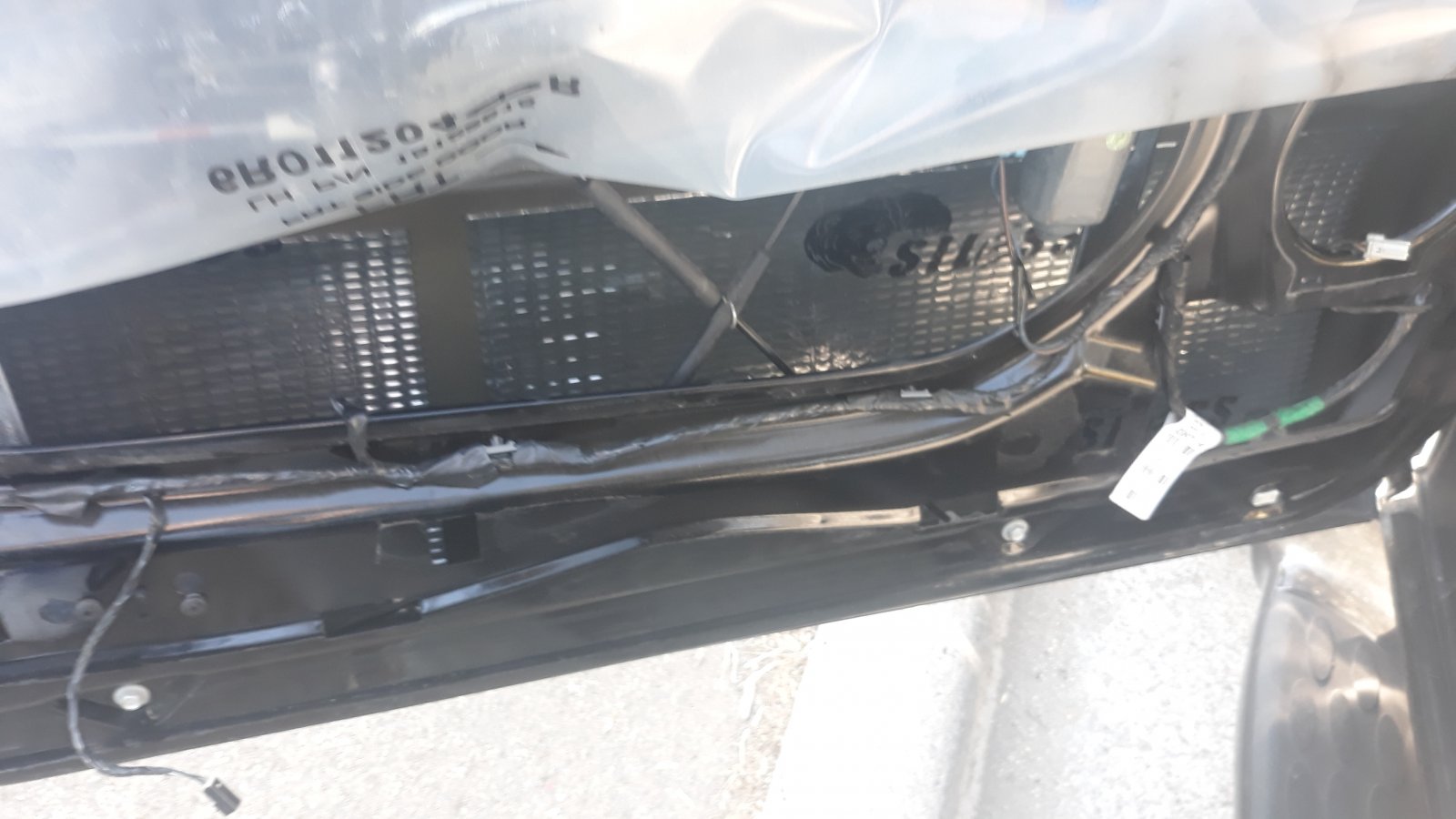

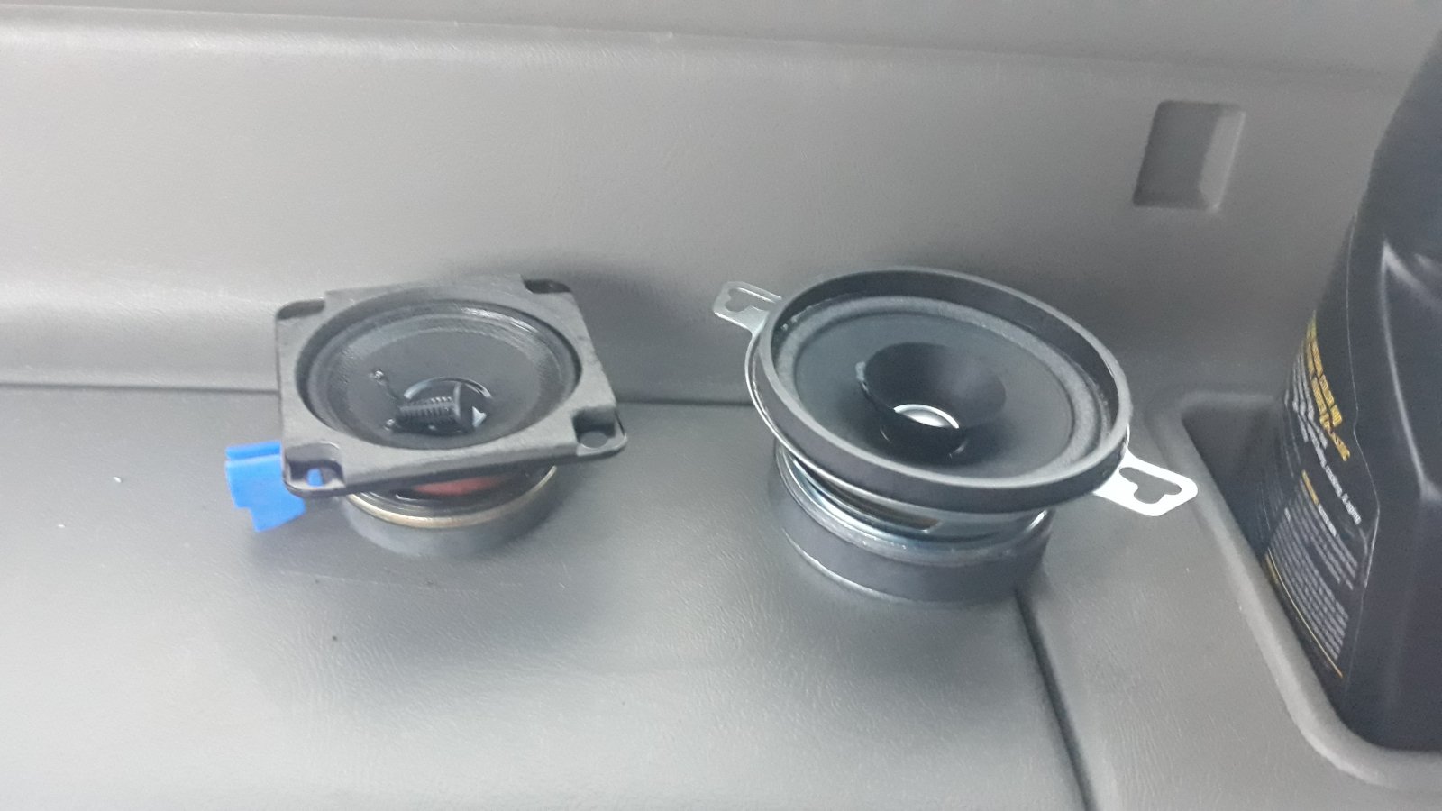

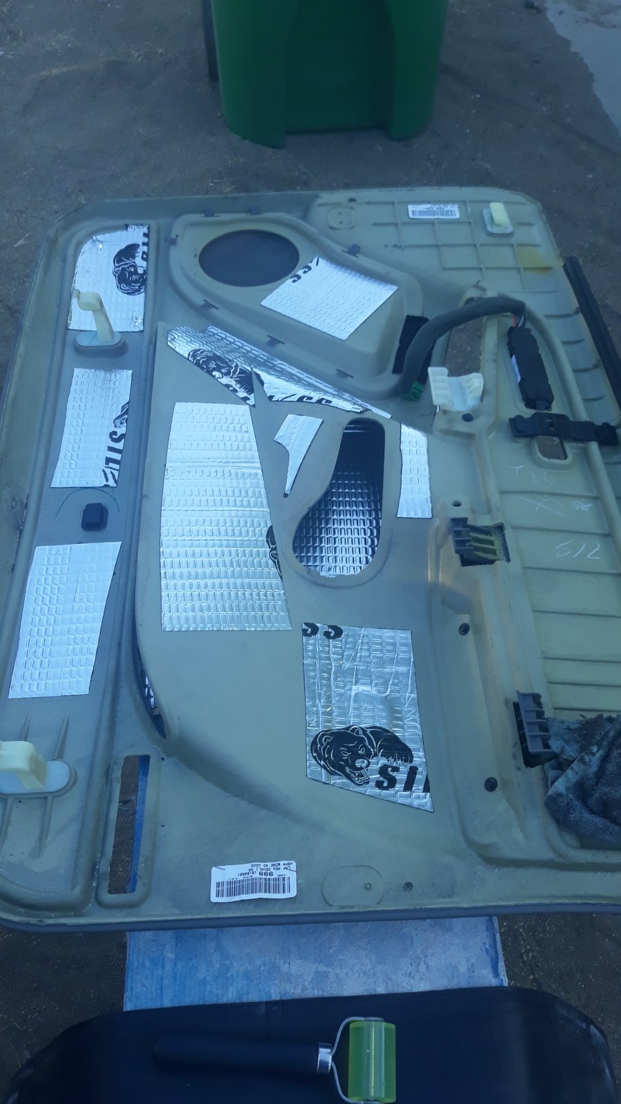

A few photos of the sound deadening that I added today I swapped out the 16 year old speakers for some very cheap Kenwood to two ways when I upgrade the speakers I may add more sound deadening but I think this is enough for now

The installation of sound deadening material can make all the difference in the world for door speaker sound quality.
From a sound reproduction acoustics perspective, you cannot have a worse acoustic environment than a car/truck door - a large narrow metal box, with all kinds of metal semi-loose components inside of it.

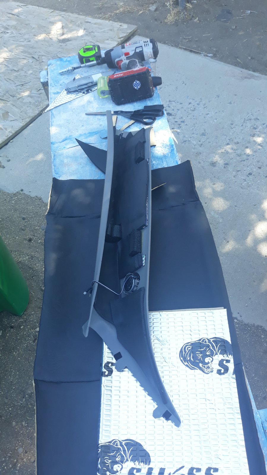

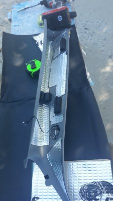

I have never seen it installed on the trim parts, always on the vehicle itself. Where did you learn to do it like that?

Well the factory does have some sound deadening measures here most higher in manufacturers included in the interior panels as well as the sheet metal but I probably learned it from a YouTube video where I learn everything but I can't get this wiring harness to work and I'm positive I've got the right adapters

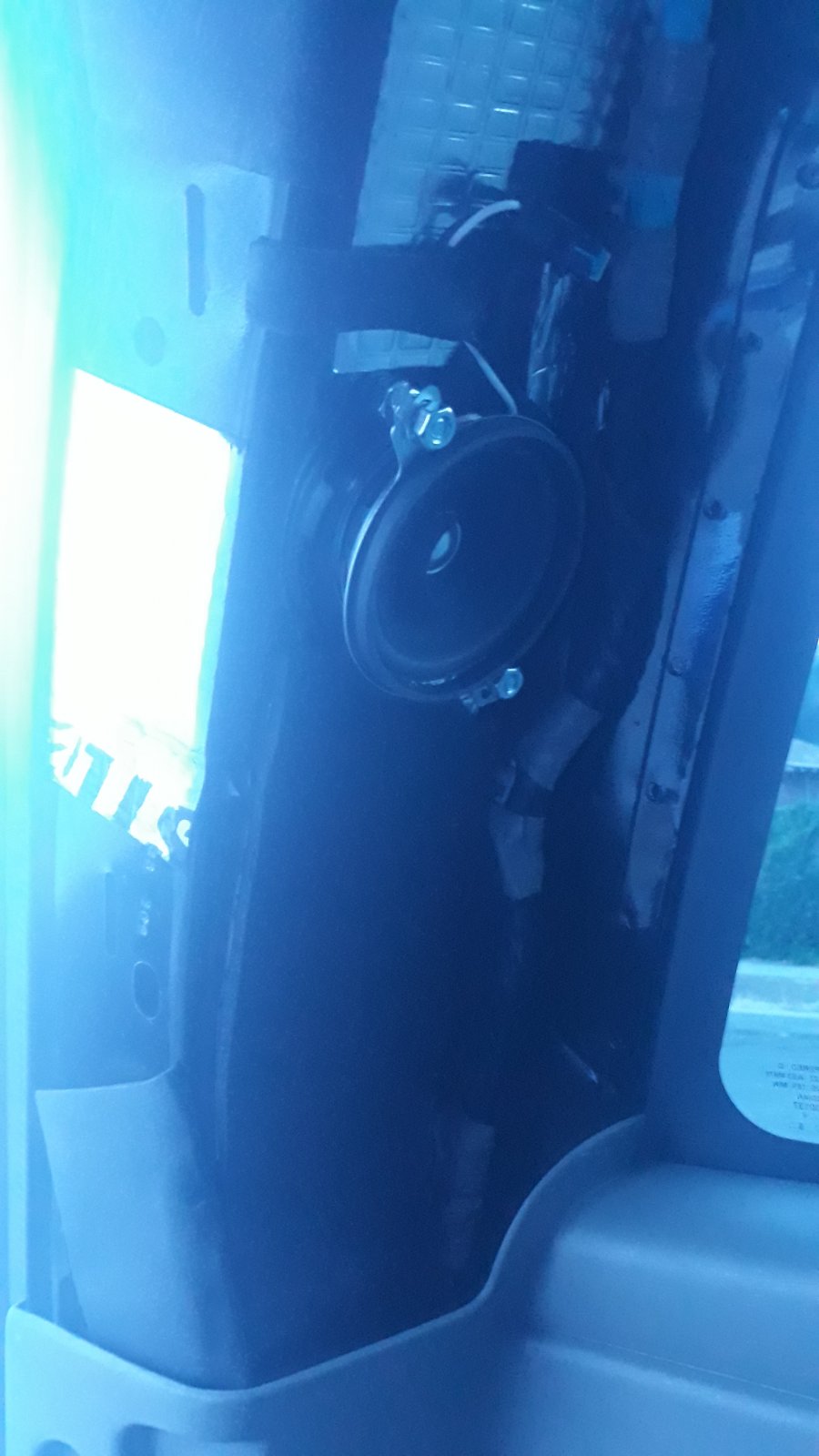

I did the depillars today the speakers I ordered are supposed to be a perfect fit and they are not but they are matched to the other six speakers I need to replace the second passenger side door so I'll be waiting to do that until after body work for now 6 speakers replaced

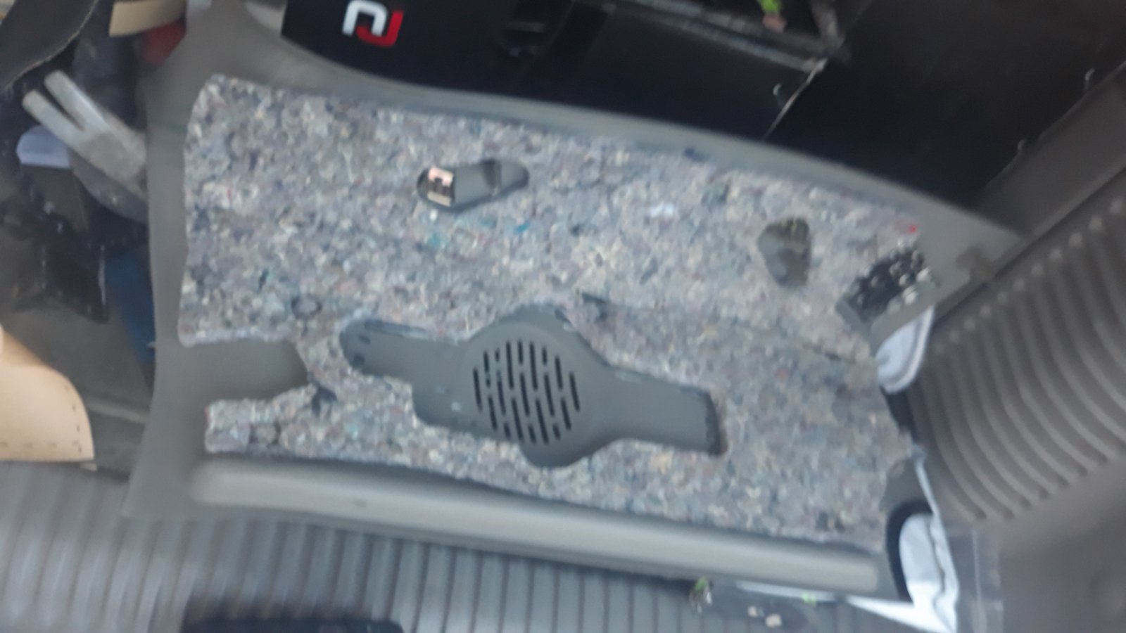

Here's a photo of some of that factory sound deadening on the Denali
View attachment 253060 View attachment 253061
There’s no direct replacement speakers for our D pillars due to the oddball size, they always require some sort of modification to make something fit.
Yeah that makes sense it's weird the way it was mounted to the trim I've only ever seen tweeters done that way as you can see from the pictures I figured something out that works
52,949
Nice work. I was going to do something at one point but decided I can’t hear them way back there anyway especially with a 10” JL sub in a Thunderform enclosure right there in the rear panel.

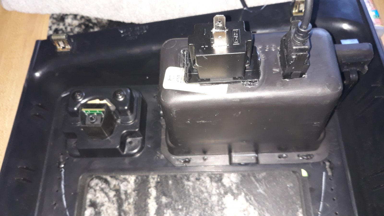

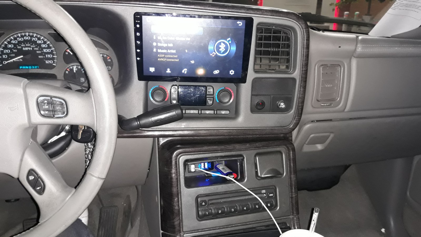

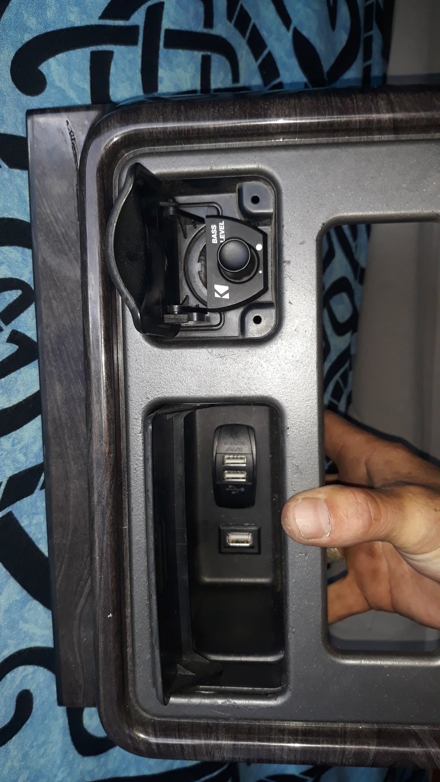

One USB port plugs into the back of the head unit the other two are just for charging powered from the cigarette lighter which now holds the subwoofer volume
The two for charging light up blue and that should add a nice glow

and then I had to move the double USB port because the structure behind it didn't allow for clearance but I need to take the whole thing apart again whenever the vinyl wrap shows up I finally found somebody that has Denali pattern vinyl wrap
52,949
Why not cut whatever is behind it, is it something important? I’m always getting my angle grinder or my Dremel out. There’s so much unneeded metal lol.

I tried not to cut things anymore cutting the back of the little cubby holes not a big deal I'll have to redo it when the vinyl wrap shows up so it works
