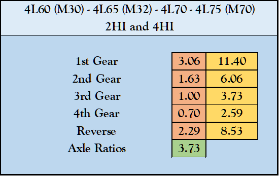

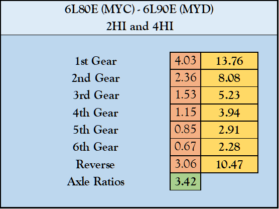

It's torque management and that extra 400 pounds. BlackBear tune will remove that TM, or most of it, and put more power to the ground.
It's not the gearing:
The Yellow boxes are the effective ratios when combining the transmission and axle ratio and as you can see, the 6-speed 3.42 combination smokes the 4-speed and 3.73s.
View attachment 381074View attachment 381075
I'll have to take your word on the gearing, because you clearly know more than I about these things.
I DO plan on getting a BB tune though.
