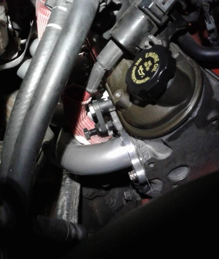

Bad scenario, first and last manifold bolts broken on drivers side. I see the front one has a stud sticking out - cant tell about the rear one yet. Do I buy the camps or attempt to remove the rest of them and replace with gasket?
Thats your call. I have a stripped bolt on mine. I was gonna put a helicoil in it and i just broke down and did the quick and ez clamp. It's a permanent fix. You may be able to get the one with the stud out but are probably going to need to pull the manifold off to get a good grip on it.

The clamps work great! I ended up buying the dorman units from Amazon, They were a little less expensive and the shipping was fast & free. I ordered yesterday morning and had them installed by 7pm (same day).
