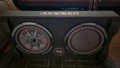

Welp, don't hang around a store when you're looking at upgrading more stuff. I'm back slightly into the audiophile category I guess, although I don't care about how loud my stuff is.....truthfully just want to keep it inside the cabin and sound awesome. Kept it all Kicker, with this CXS400.1 one channel amp (400w rms) and this Kicker down firing 10" CompRT sub. The box is super sturdy, dude jumped on it in the store. I like it since it's going to be hard to see it, and unsuspecting since it's flat.
This is how the box will sit....
Flipped up so you can see the sub.

Nice. Was the guy like 100 lbs lol? Does the speaker box box go under the 2nd row seats, or laying flat in the cargo area? Where are you gonna mount the amp? How are you going to wire the amp? I know it's mono, but I'm just curious.
He was about 200lb, but I hadn't even bought it yet. He was the store owner and does installs too, so I know he was familiar with it. Otherwise I'd have been like wtf. :D
This box lays flat in the cargo area, too big to go under the seat. I like it since it's a down firing woofer, and slim-line, so it's low profile and not noticable. If anyone saw it through the tint, it doesn't resemble a sub enclosure.
I wired it 300 watts (2ohm).
