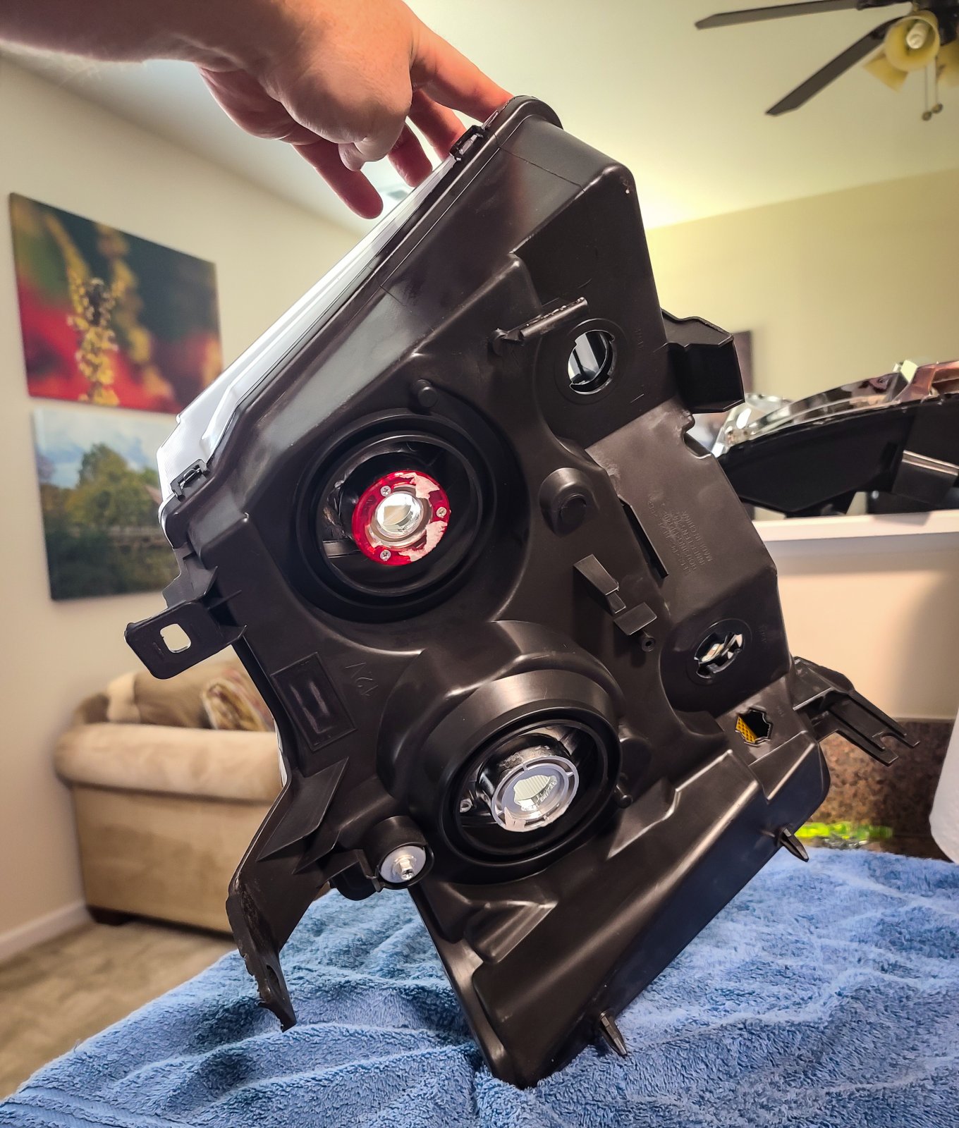

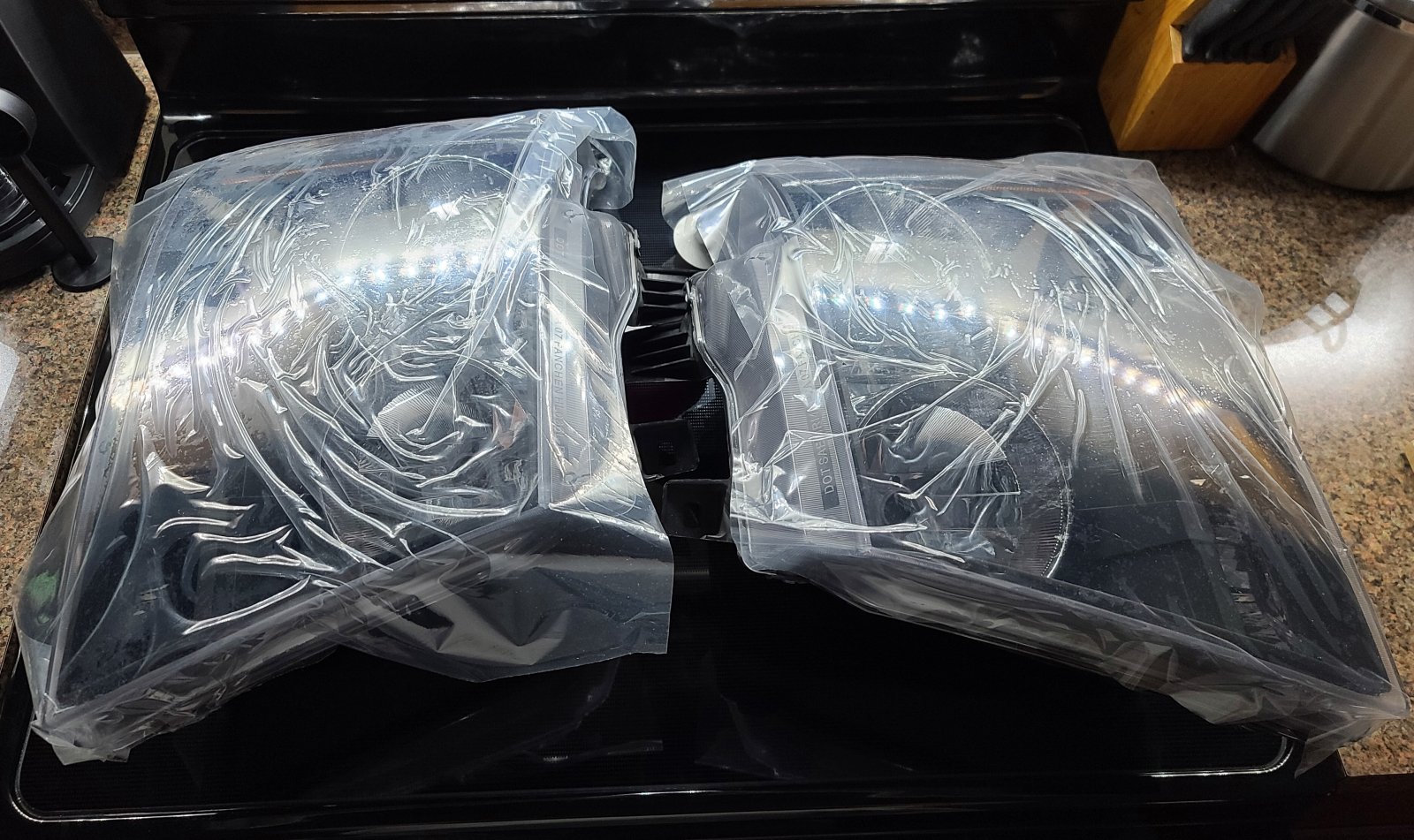

Work has really hampered any time to get this finished. Got them assembled now though, need to put the harness in and mount the assemblies without the lenses for alignment. Hope I can do that tonight or tomorrow. If North Carolina can go a few days without straight line winds and tornadoes......
Fresh headlights
Pro tip when baking and splitting headlights: use a towel on your counter to provide a slip-free and soft surface to work with. Also, keep the assembly in a similar hold like I've shown here, similar to holding a football for a field goal/extra point. Those tabs all over the headlight are super soft when warmed, and will bend or deform easily.
Another pro tip: find an inner seam to "work" a flathead screwdriver or prying tool, when separating your baked headlight. The marks from your tool won't be seen.

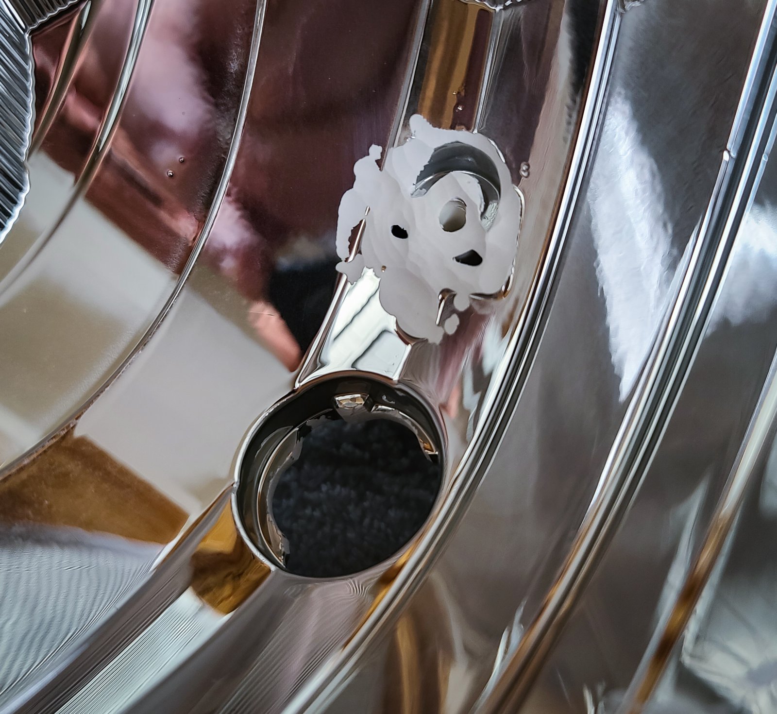

Refoector pedestal removal. Once the reflector is unbolted, you need to grind this part down so the projector fits flush.
Used my pneumatic grinder, another reason I'll never sell my tools from my BMW tech days. These Matco bits will grind through damn anything.
Good to go.

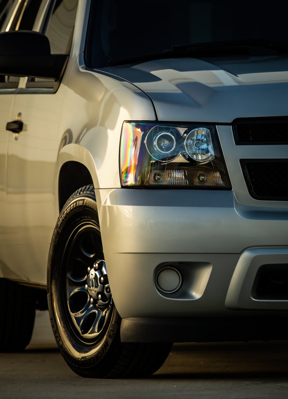

All done. While I was up babysitting a brisket on the smoker last night, I baked the lenses back on and got everything buttoned up. Well worth it, and things were almost dead-on from the start. I got them leveled in the garage, then took the Tahoe with the headlights installed (minus lenses) to the back of a large store to check aim at several distances.
