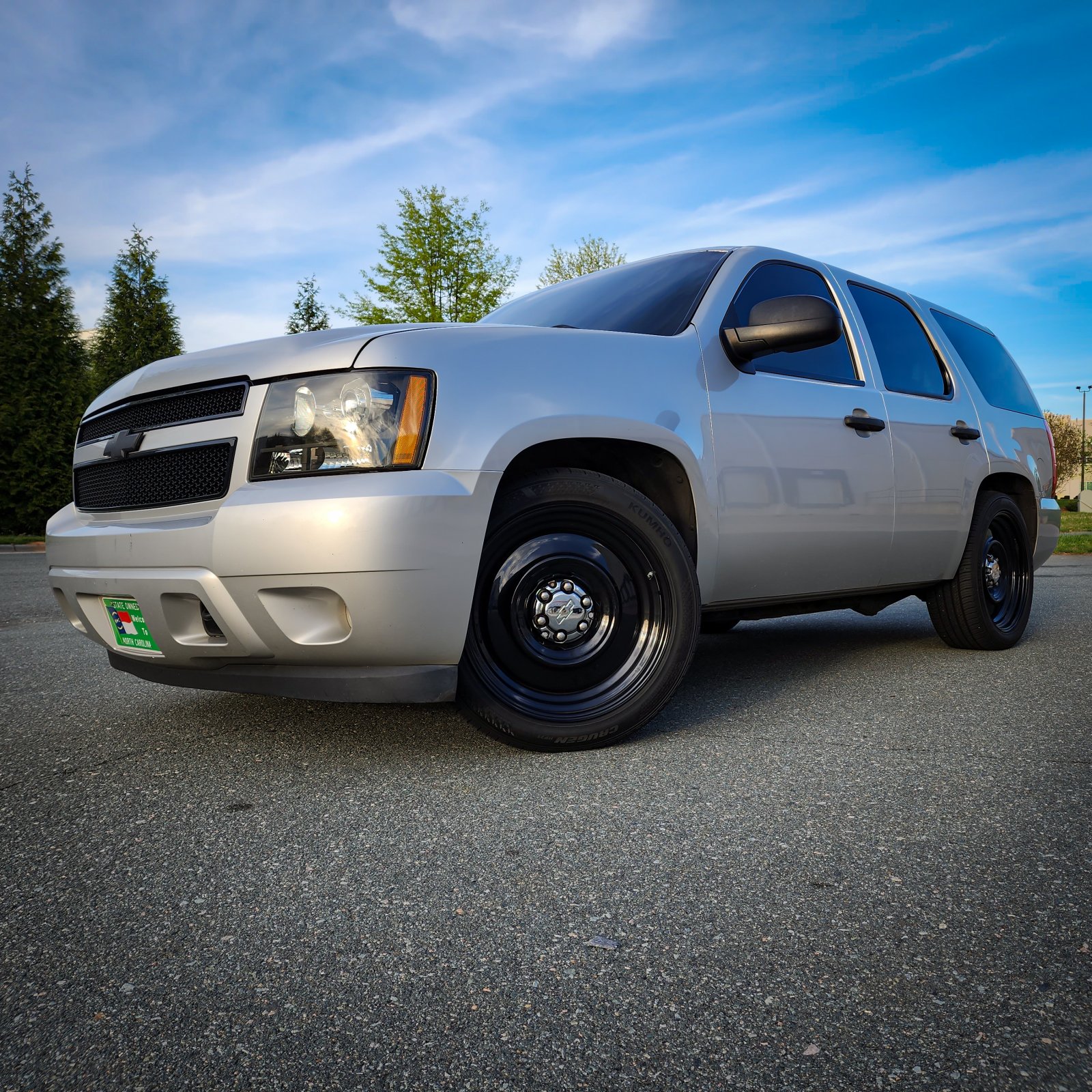

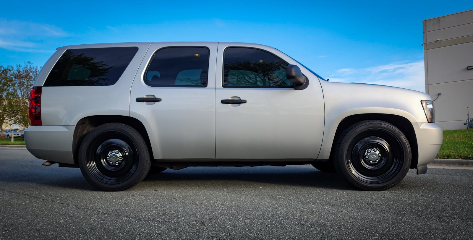

Do you think the ssv caps would look good on there?
I do. I really like the look with the chrome centers on the black wheel, and think it keeps to the overall appearance. And my State Trooper buddies loved the look too from these pics.
They look great. How are you thinking to mount the PPV center cap? I didn’t like where the mounting holes lined up, thought drilling and tapping into that raised ring would possibly weaken the wheel. I like the look without them, so I didn’t bother. There is a guy out there that makes a clip kit to mount other styles of cap. I have him saved somewhere if you need them. Think it was about $100. I’m dropping mine to 4/6 on Friday..pretty excited. I’ve got the front spindles, shock extenders and 4” spring now. Going to 6” rear spring, trailing arm replicators, and Spohn adjustable panhard bar, and adjustable drop front struts, to take out the Chevy lean. All Belltech stuff before and after…except the 6” springs. I’ll post a pic when it’s all done.

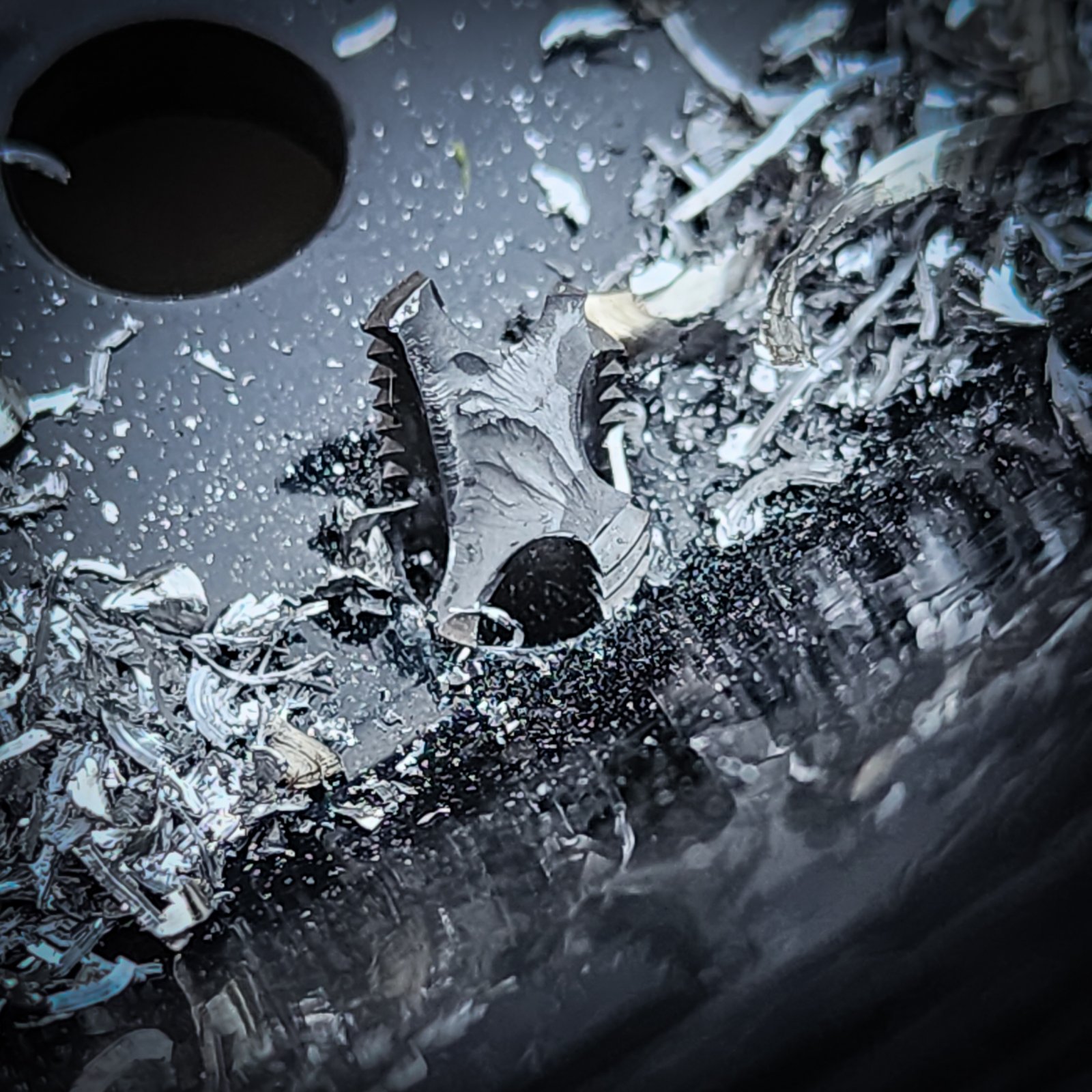

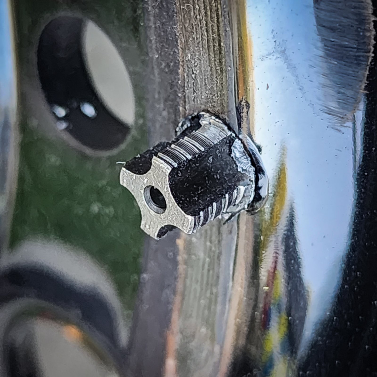

Ripped the FR off after mowing the grass, drilled/tapped the first hole, drilled/started to tap the second hole......SNAP.
POS Stanley tools from Lowes, damn tap snapped like a twig. Luckily I was able to grab the end with vise grips and turn it out. Guess I'll finish tomorrow, as long as I don't break another.

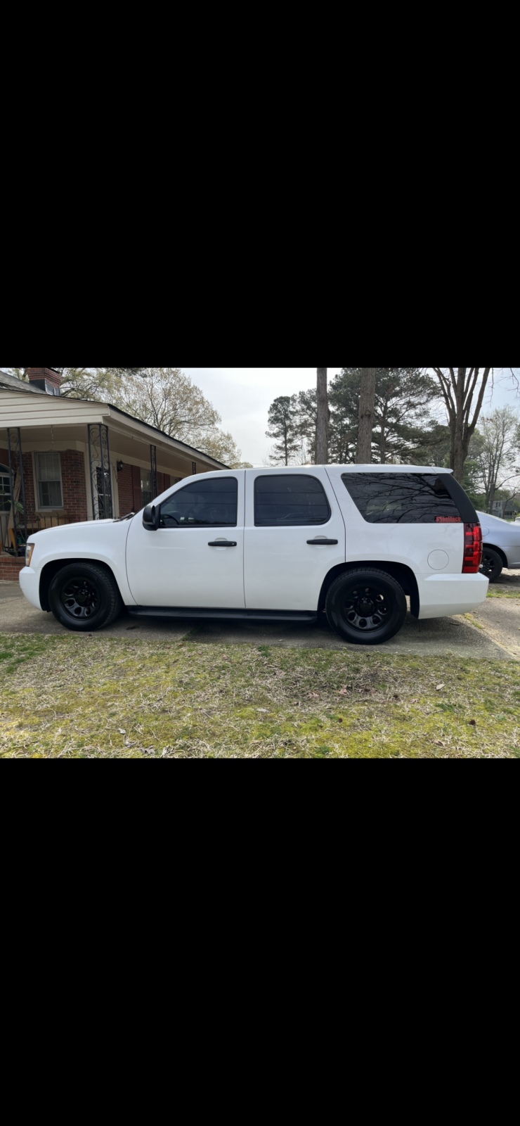

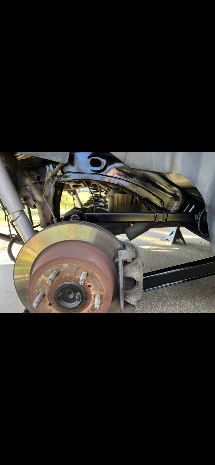

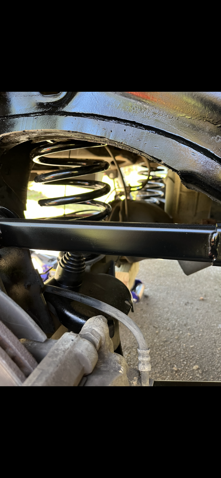

They look really good, I have mine off at the moment, because I still have a tire that needs a repair. But I think I’m going to drill and tap mine. My center caps are factory black..maybe off a newer model? I did get mine lowered to 4/6 last week. Had to do the free travel mod myself, my shop didnt want to do it. It was a pain, but turned out good. Couple hours in the driveway. Used 5-6 thin cut off disks on angle grinder. Moved bump stop to axle pad.
