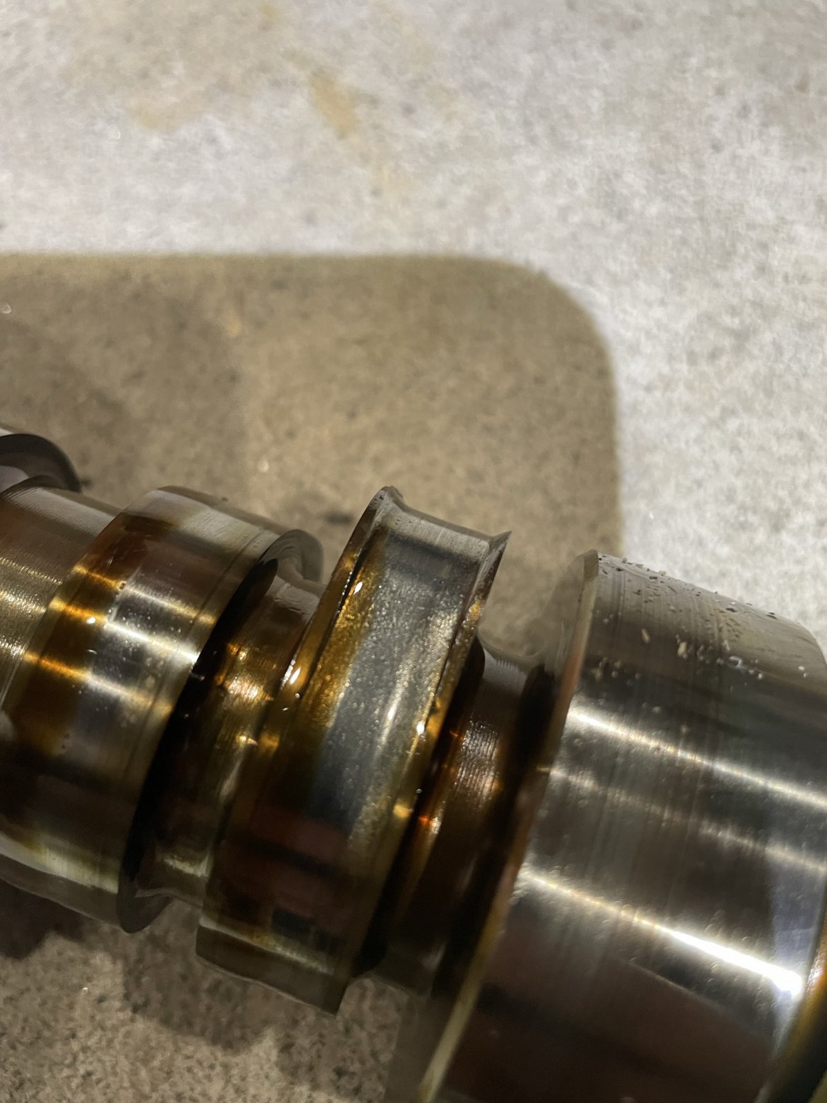

Did you make sure the lifter didn’t wipe out the cam? My bad lifter did this to my cylinder 7 lobe.

Wow! Looks more like a pulley than a cam lobe...
Yeah I had a misfire at idle for like 6 months I was chasing. I finally caved one day after trying everything I was capable of trying to diagnose and pulled the heads. Found a bad lifter than the cam. The misfire also ended up killing my catalytic converter shortly after. It’s all straightened out now though
