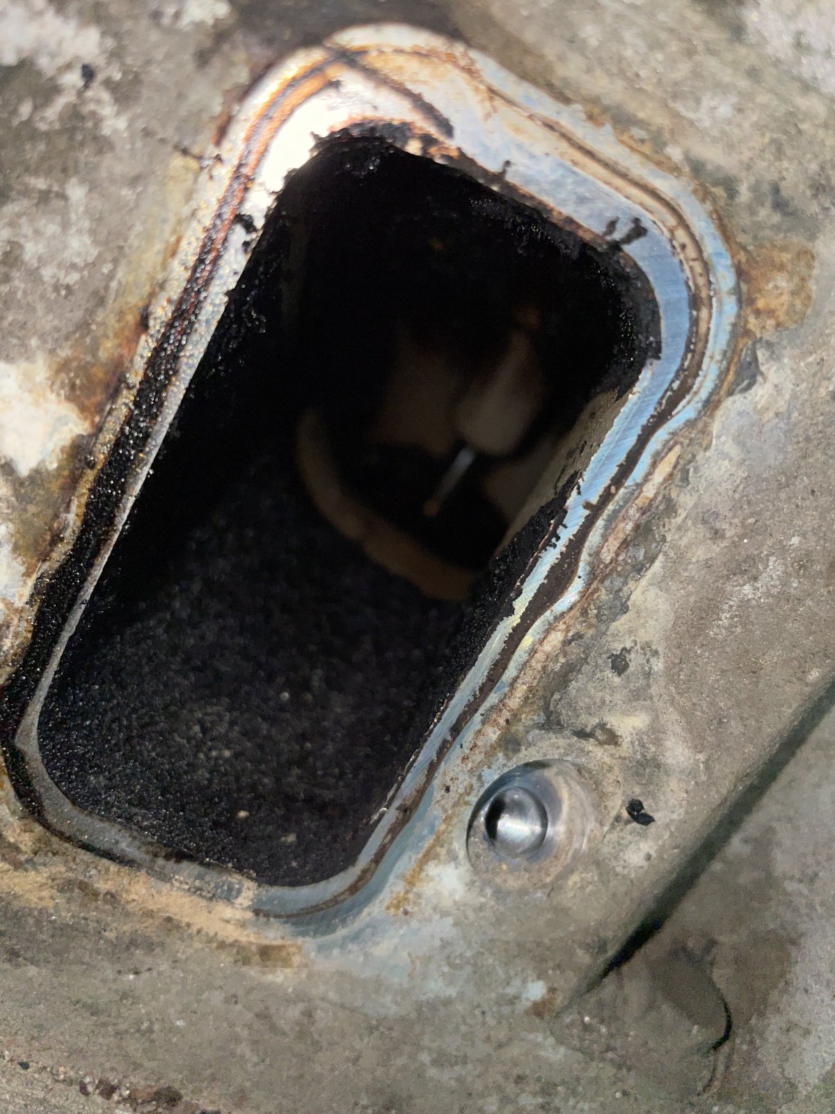

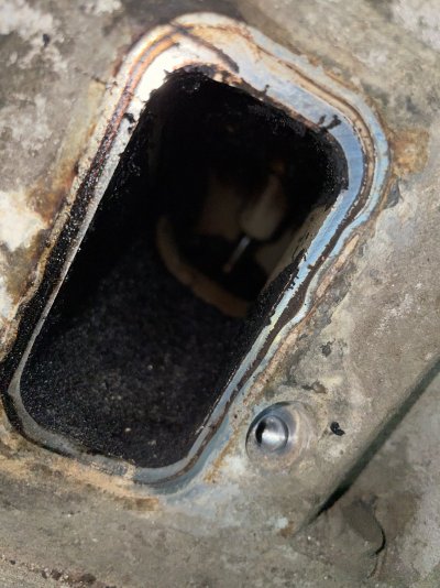

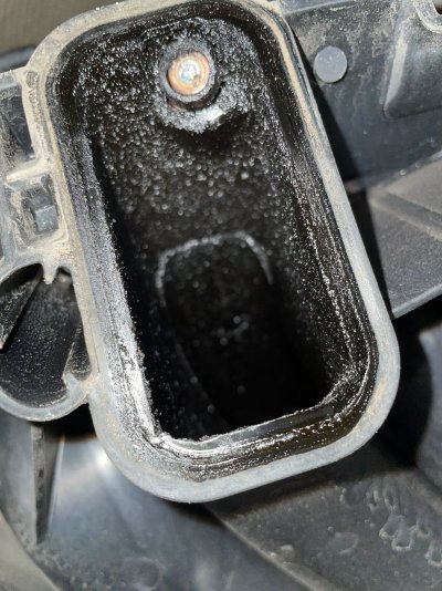

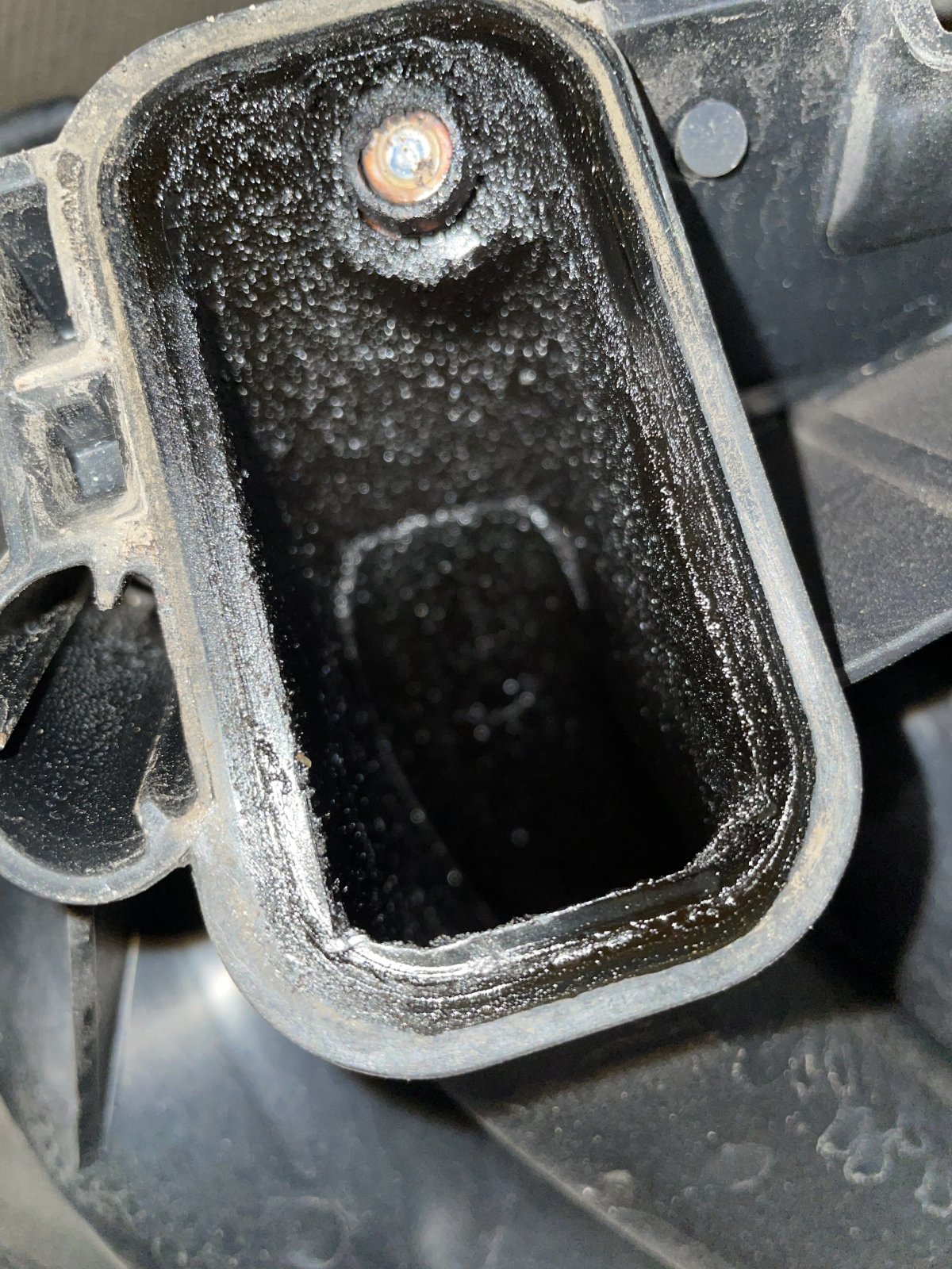

Pulled the intake manifold today. Found all this gunk… should I clean it out? And if so what do I clean it with?

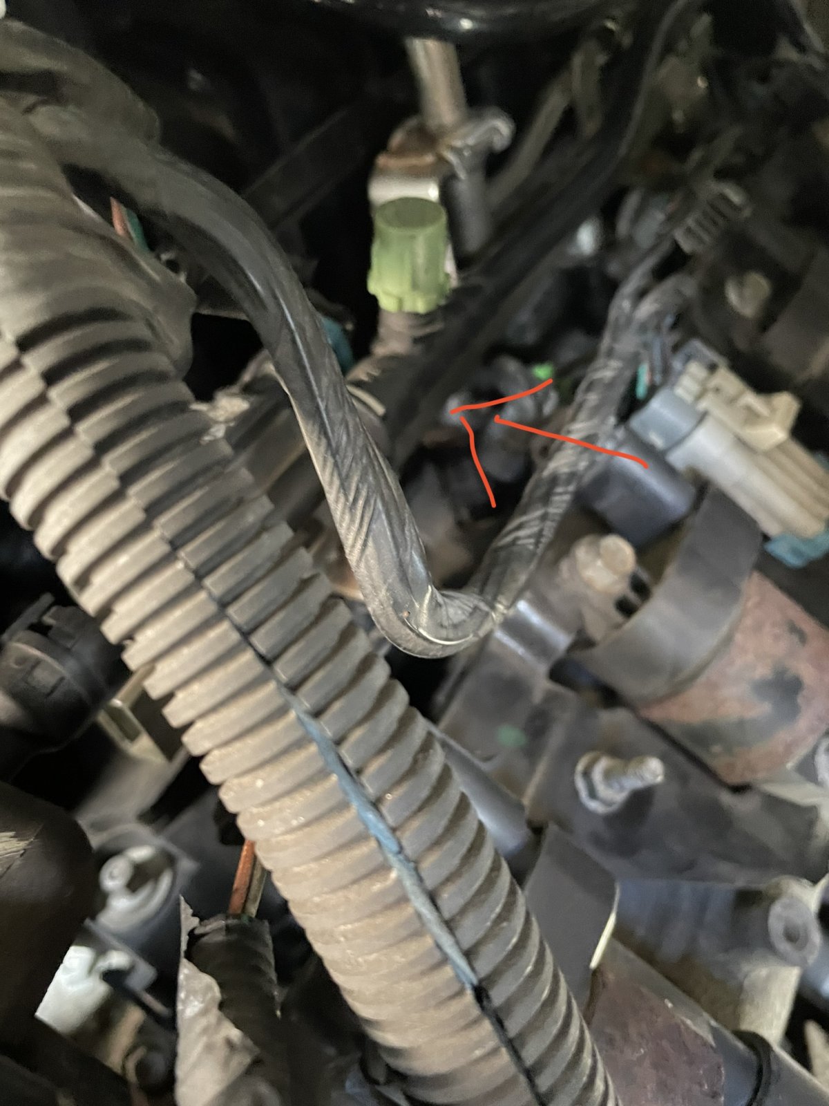

Months of headache may of finally come to an end. Replaced the intake manifold gasket on a whim. Then drove it for a day or so. Code reader picking up misfire 7 again and now a new code evap leak…. At this point WHAT THE F***!!! I was so close to throwing in the towel. I even called 2 local mechanics to try to schedule my van. Weirdly enough. Neither one called me back…. I popped the hood a few days later and noticed the evap hose was not connected to the purge cylinder thing! Hooked it up nice and secure. Cleared the codes and were we are about 2 weeks later nice smoooth idle. Hope I don’t jinx myself

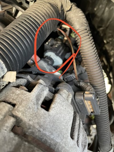

Can you post a pic what/where you're talking about.

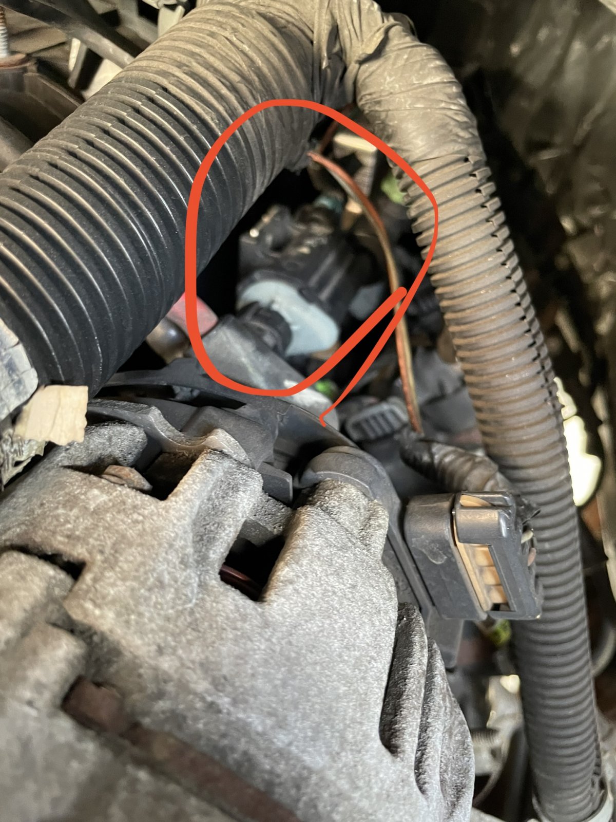

So directly behind the alternator is this vapor purge thing. I think. It’s mounted on the intake manifold. The hose wasn’t clicked in all the way and fell off. So I had to secure it.

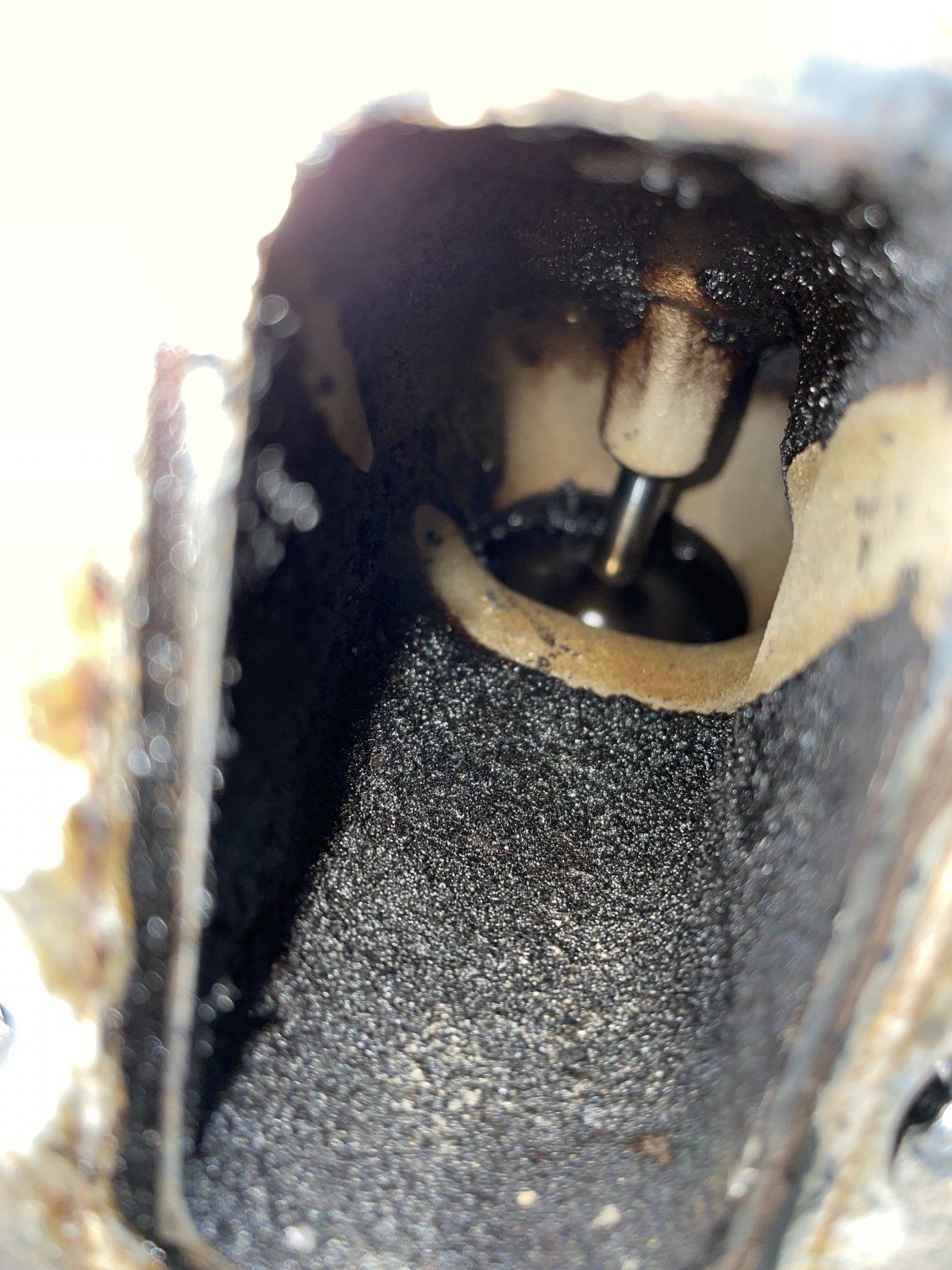

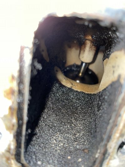

FINALLY HAVE SOME ANSWERS!!!

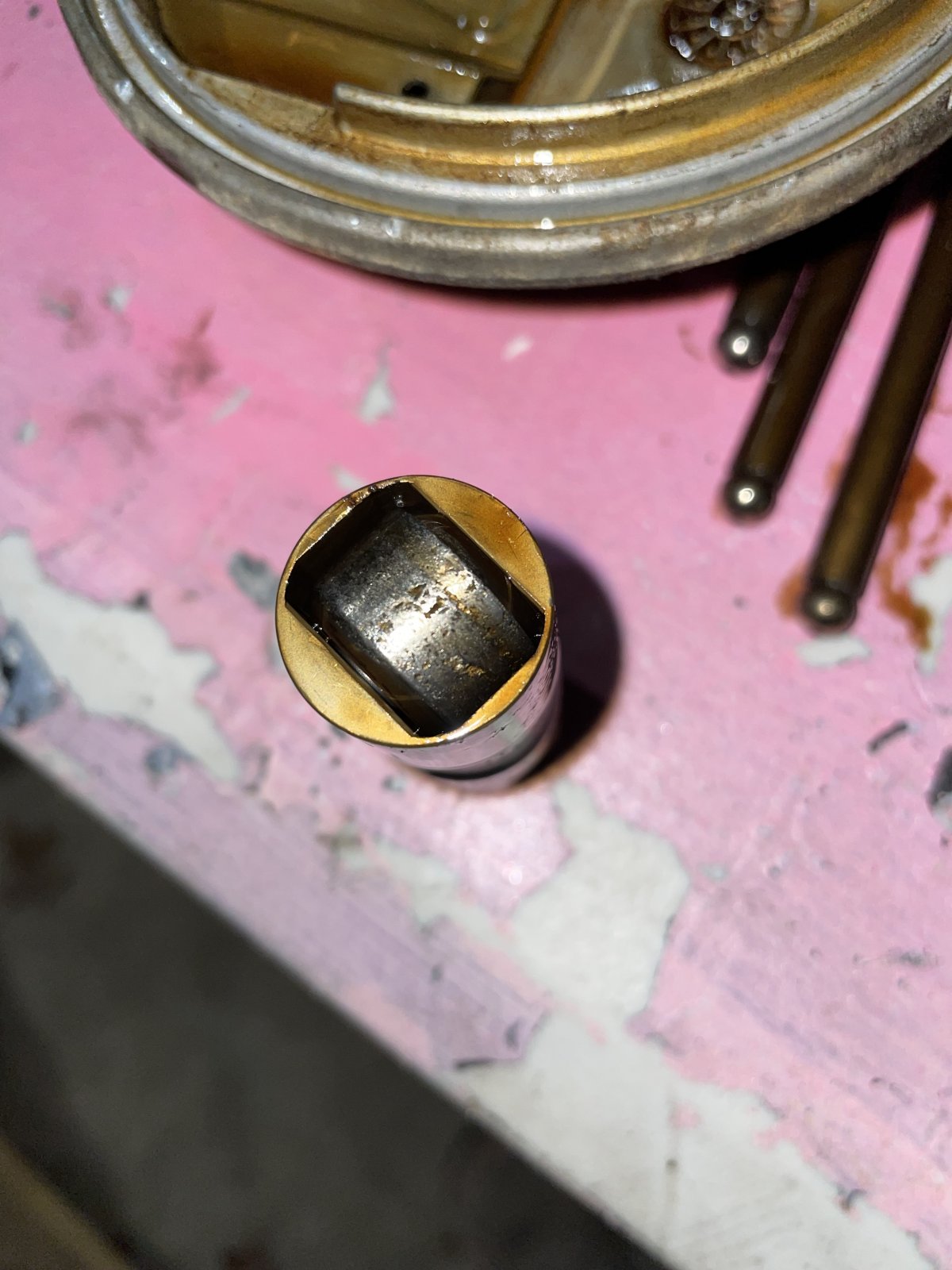

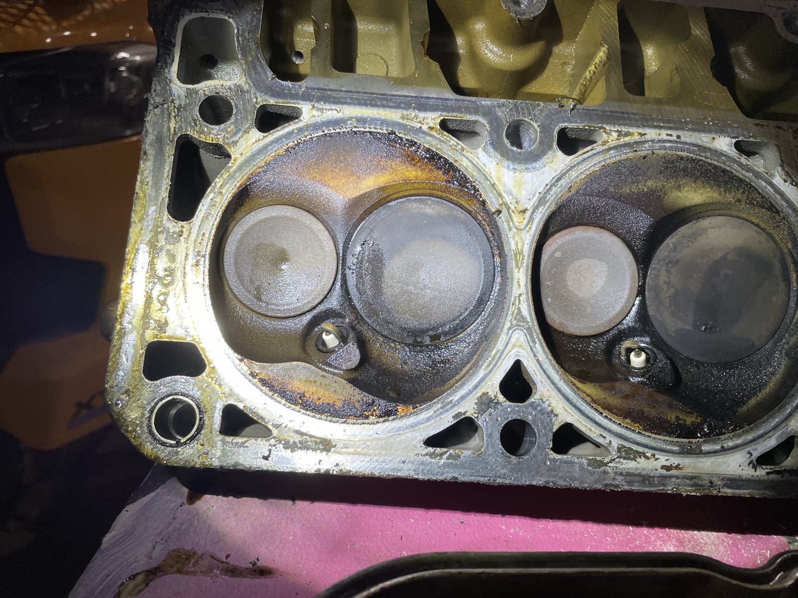

Caved in and tore the cylinder head off. I have an eaten up lifter on cylinder 7… so now I have to weigh my options.
Do I rebuild the top end while in the truck? Need some opinions on the valves? Do I just get the heads rebuilt since I have them off the truck anyway? Assuming the dead lifter is gonna cost me a cam? While I’m in there do I do the timing chain as well? Planning on doing a high output melling oil pump while in there since I have low oil pressure.. after I price this all out I need to consider if it makes sense to fix the top end and freshen up a few other things or do I just spend the money on a long block and replace the whole thing
Opinions and advice please.
The lifter pictured is the 2nd lifter from the back of the engine on cylinder 7. The valves pictured are cylinder 7 and the picture of the cam doesn’t show much

At under 60k miles I would redo the top end and do the cam, every time I find bad lifter(s). I would have the heads freshened up. IMO, I would drop the pan and check for any debris in the pickup and do the o-ring while in there. Also, a new oil pressure sensor with the filter, right.

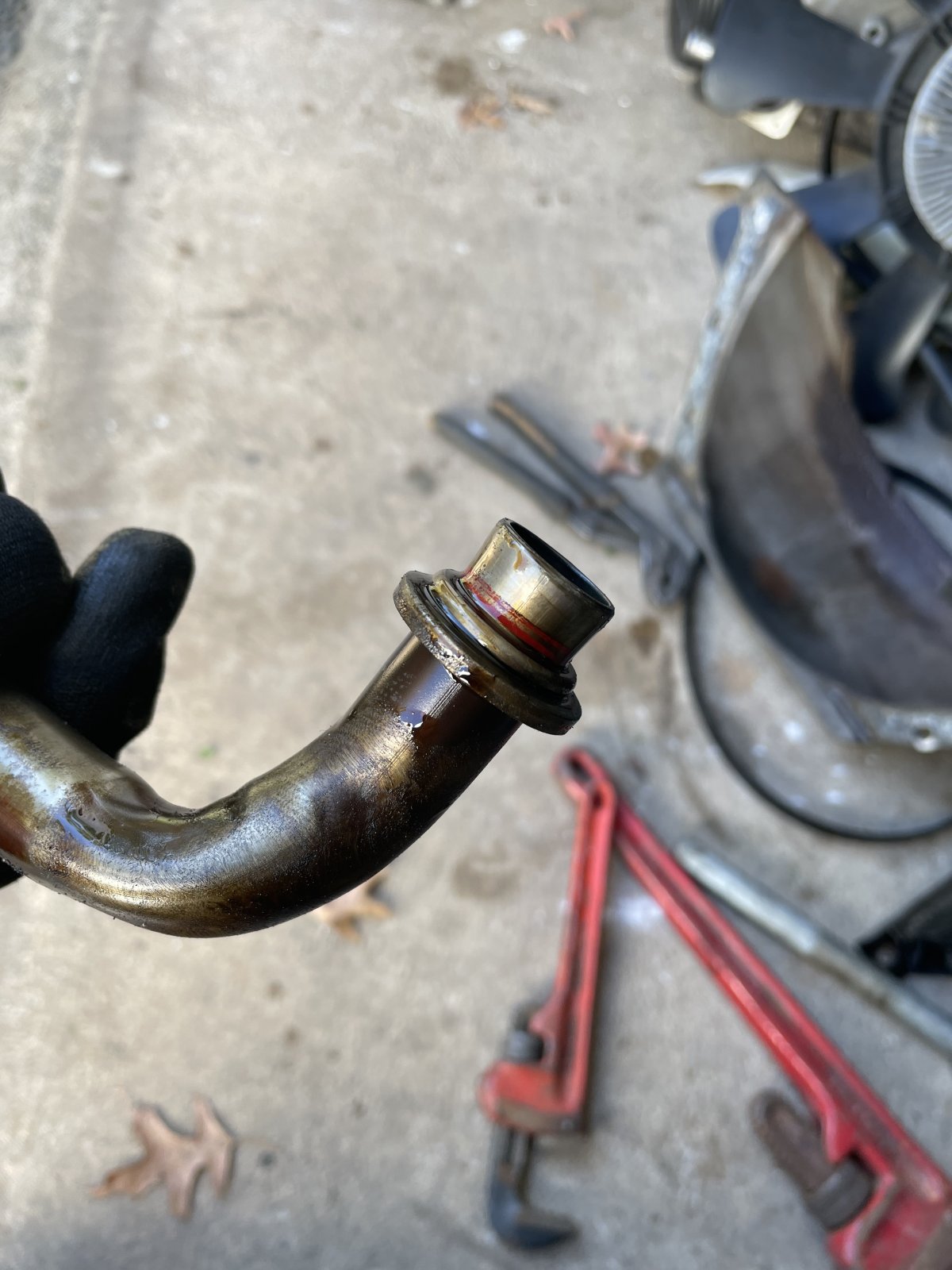

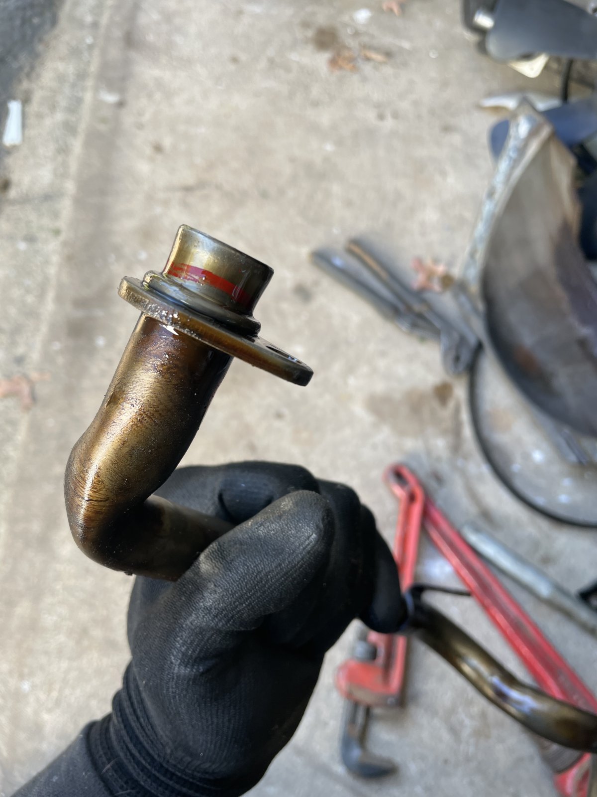

Thoughts on this O ring? Was it improperly seated? I can’t find any damage on the o ring itself. But the red marking on the o ring are uneven on the tube

I see no problems with the o-ring. Replace with new though and wash out the pick up tube or replace. Make sure the tube mount bracket is in great shape with no cracks. Check for ANY debris in the pan and clean as well. Do the oil sensor and the filter. When you do the heads, freshen up the valve seats and valve guides and seals. It is apart and is perfect time to do that, even with the low miles. GM or Fel Pro gasket kits, IMO. While you have it apart, freshen up anything that looks suspicious.
