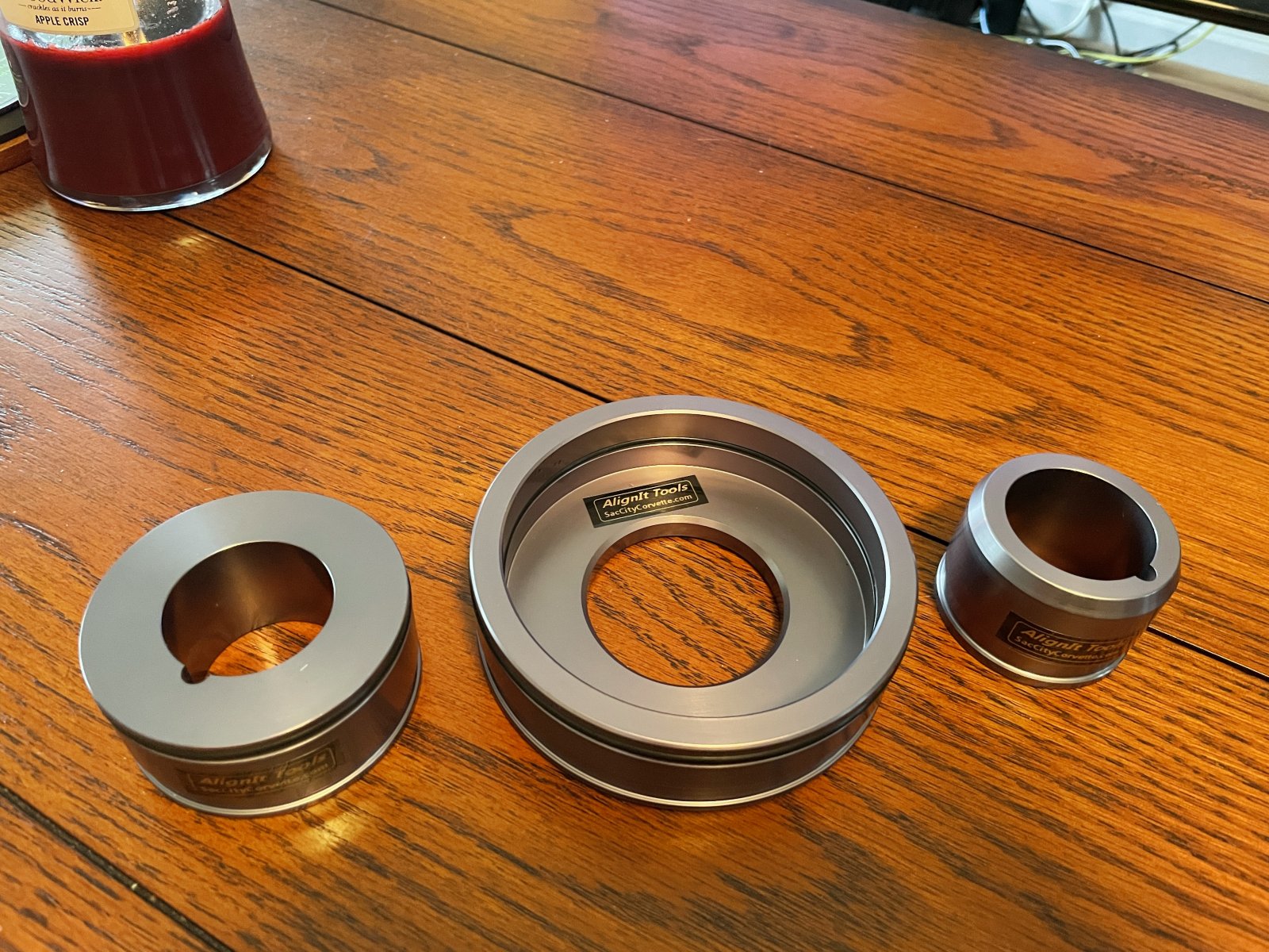

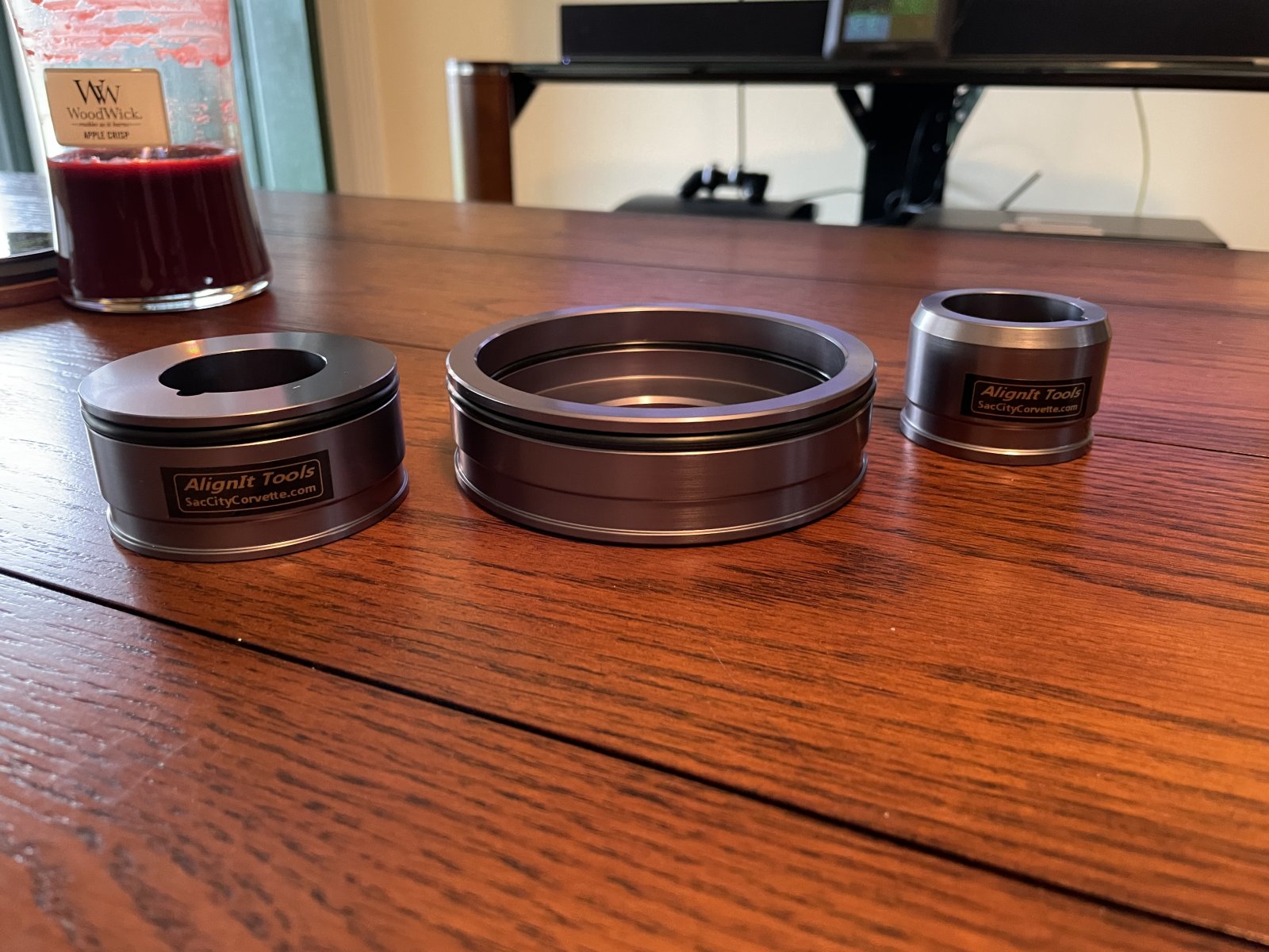

I have the Alignit tools from Sac City Corvette
I bought the pretty aluminum ones because, well, they're pretty. The plastic ones seem to work ok as well
Edit: here are some pics. They seem to be very high quality. Being they're aluminum, you'll still need to care for them gently so they don't get dinged up

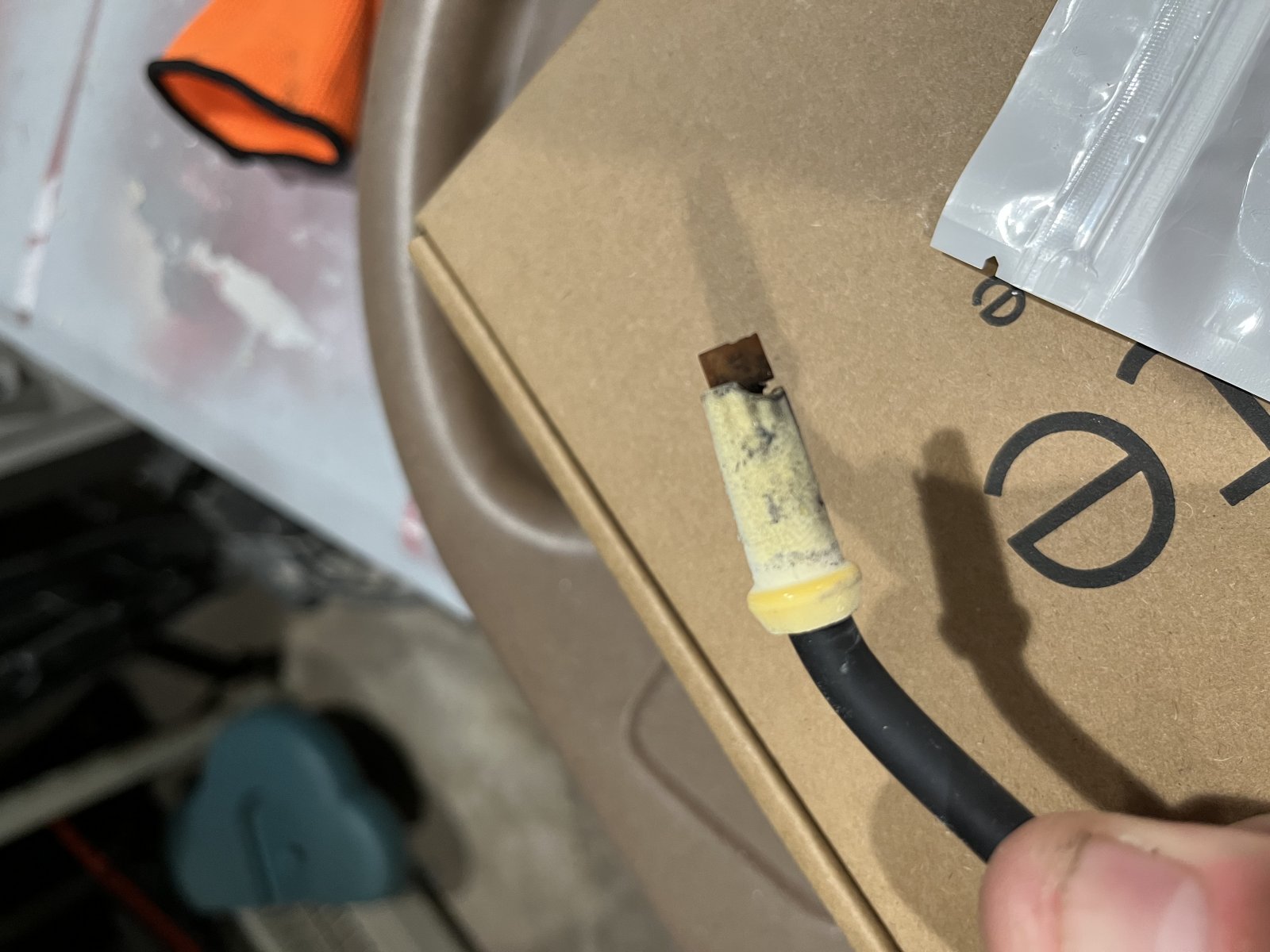

Symptoms: cylinder 8 misfire only in the morning. Literally only in the morning. I cannot reproduce the problem throughout the day even if the truck sits on the job for 8 hours. Won’t throw a CEL. It just reads cyl 8 mis pending on the OBD scanner. Then it eventually smooths out.

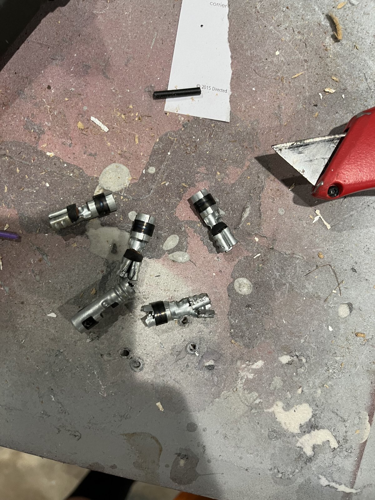

Tonight I got around to checking out the coil and wires and I couldn’t believe my cylinder 8 wire was pretty much deteriorating internally. The ceramic part that connects to the coil pack pretty much crumbled away and the connector that connects to the plug broke off.. the plugs are about a year old. So I ran to autozone unfortunately because I need wires now. Replaced all 8 while I was in there and 5 of 8 broke during removal. Total junk. I’m pretty hopeful that crap wire was the cause of the misfire and I got it under control again

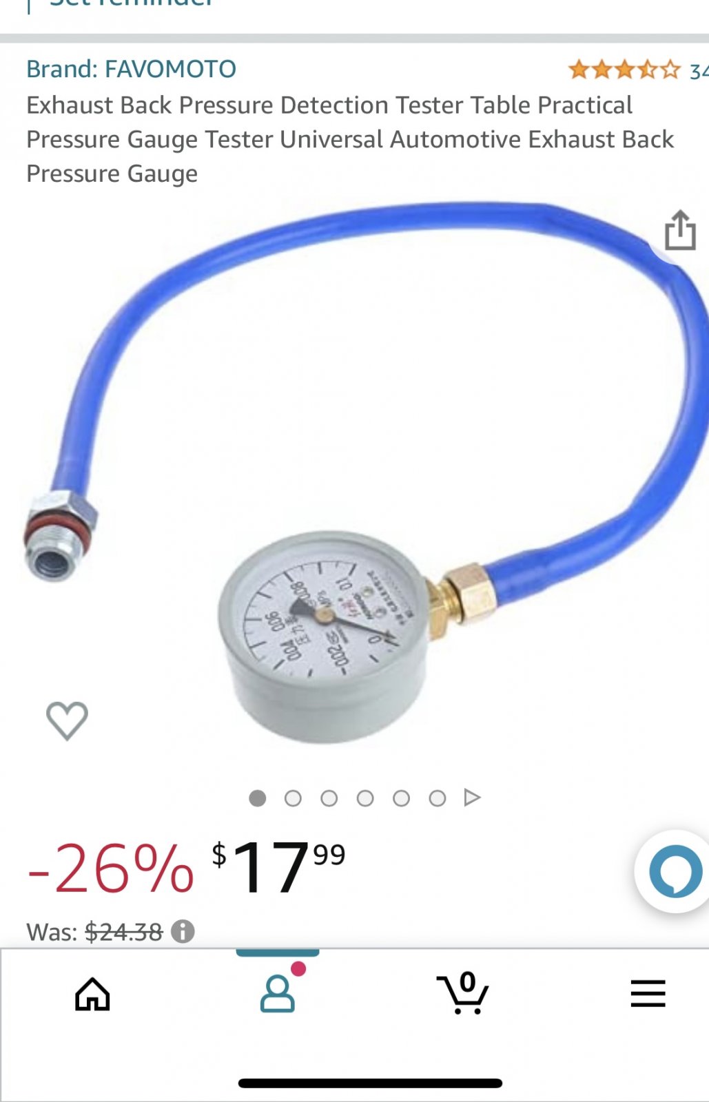

so before I tore the engine apart last year I definitely borrowed a cheapy tool like this pressure tester and it showed nothing significant to make me think there was a clog.. however that was a year ago. And earlier this year I definitely put a cheater bung extender on my downstream 02 sensor because it was throwing codes. The codes stopped after that.
I can order a tester for myself and try again. Or would 1 get significantly hotter than the other like if I used a temp gun?

You want the cat to show close to the same temp at front middle and back.

IDK. I paid a shop to test mine, cost me $60 or something.
