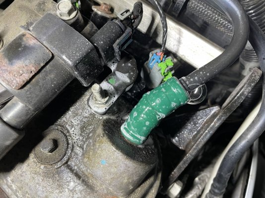

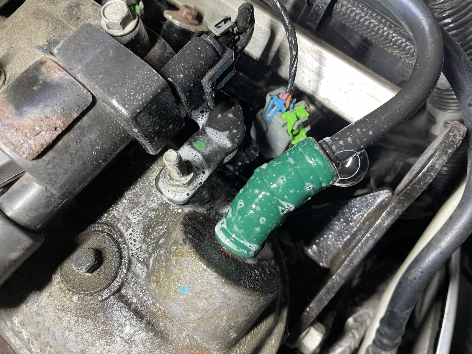

Found this tiny vacuum leak with a smoke tester. Could this be big enough to cause rough idle/misfire?
Right above cyl 7
