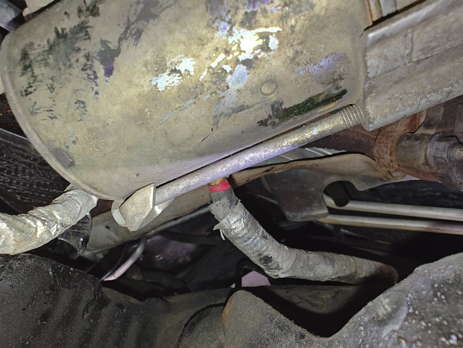

I did get under the truck and check the positive wire down to the starter. Though not the best picture, here it is. I wiggled it and it seems solid. Its the original starter and I have no issues cranking. Truck starts with ease. Is the fact that there is some bare copper between the insulation and the crimp an issue?
it's fine as long as nothing is touching it
