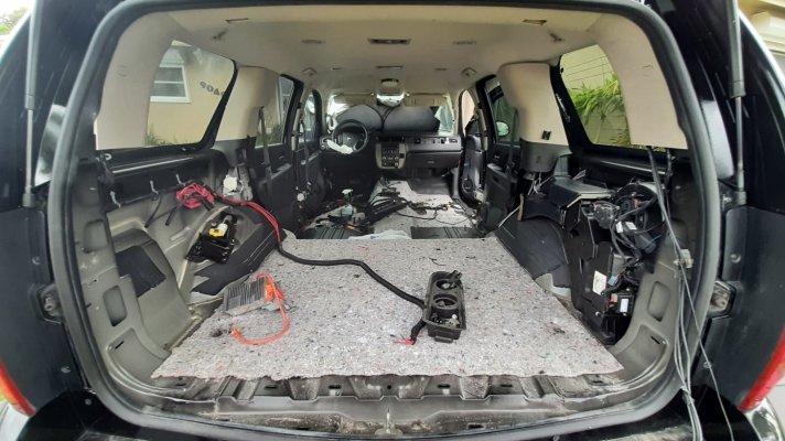

One of the projects I wanted to do was to replace the carpet, so I took out all of the interior, there were coffee or coffee like stains around the driver and passengers insulation. The carpet I ordered from Rock Auto, it came with insulation. I didn't know that and I had already gotten insulation from home depot to replace the bad spots. since the insulation that came with the Rock Auto order was not as thick as the original on the Tahoe, decided to leave both of them there. the rear insulation, I left it original, just replaced the front.
while I had the rear carpet out, I got the brackets from the salvage yard to add third row seating.
