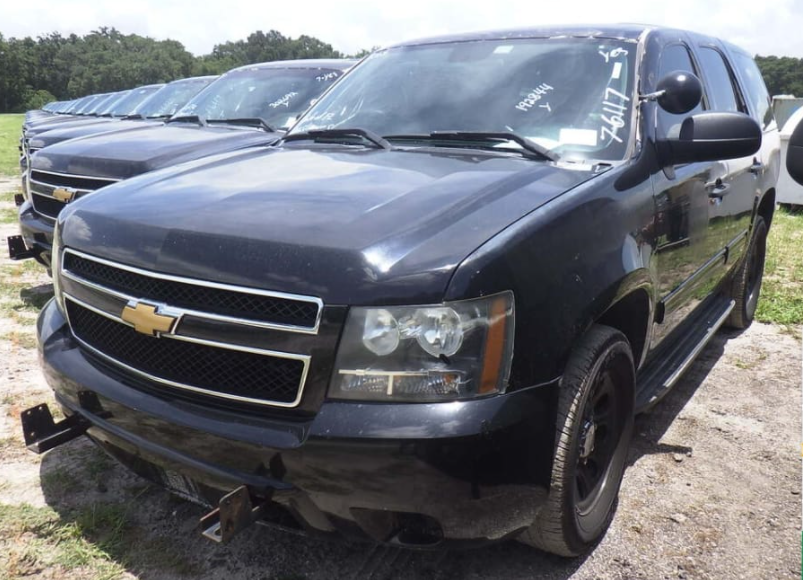

Hello, new to the forum, been reading alot of the threads here and gotten really good tips (Thank you) on these PPV Tahoes, after I purchaed mine. About a month ago I picked up a Black 2014 155Kmiles Tahoe from the Florida Highway Patrol straight from the auction.
So far what I've done to it is sent it to get painted black. when I received it from the auction, they had painted it with a roller or a paint brush over the beige-white part of the truck..
Very excited to take on this project. looking to do the whole interior, change out the rubber carpet, add a center console.. and extra details in the inside. Truck sounds great, but I think I want to add a flow master to amp up the sound slightly.. any Ideas on what the best performance muffler would be for this?
The engine has a slight lifter noise on the passengers side.. looked at a couple of videos on Youtube.. think will try to DIY it.. and see how it goes, hopefully is nothing major!
View attachment 346868 View attachment 346869
This is how I got it from the auction.. will post more pictures of the progress..
