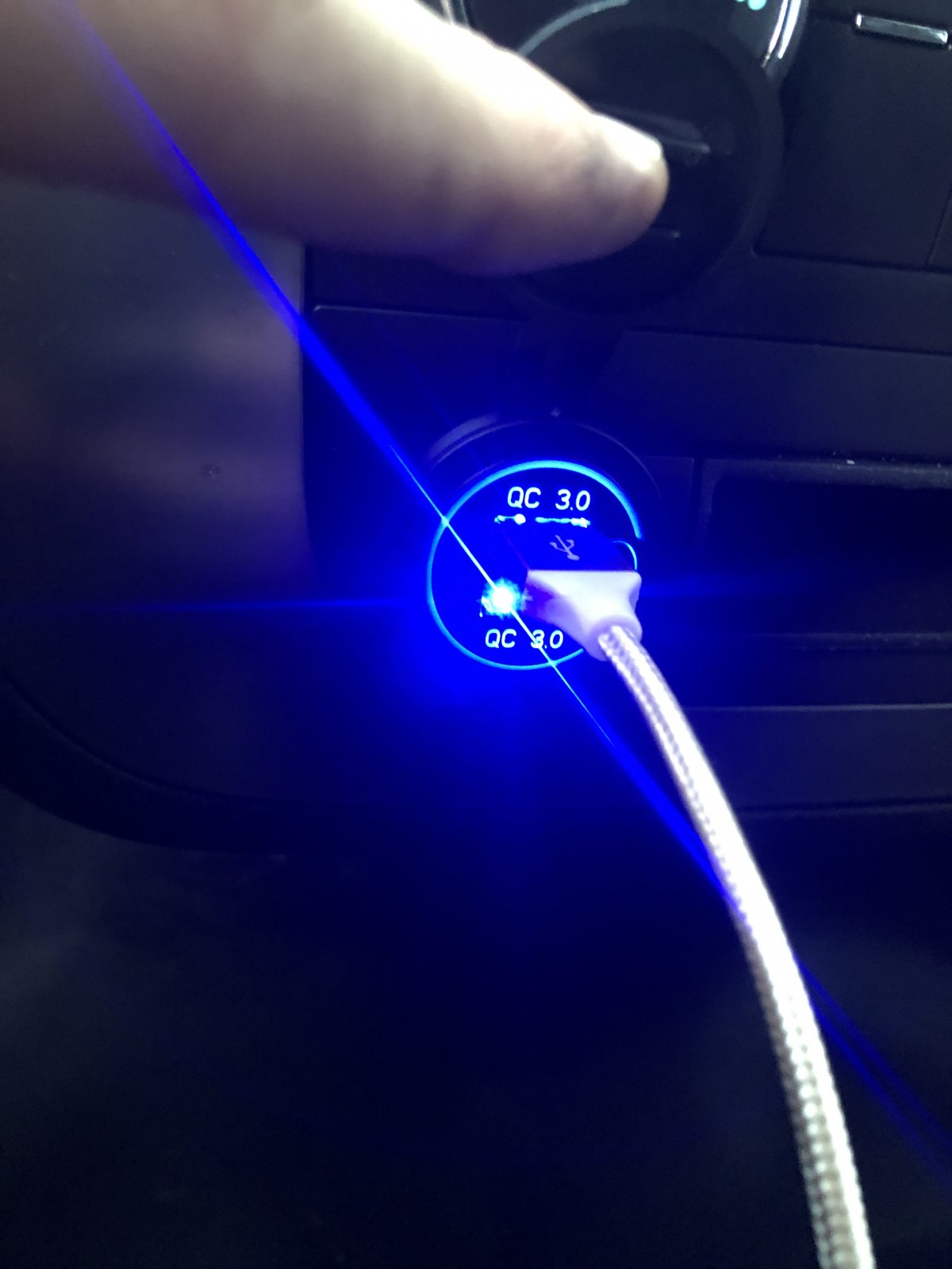

I got the DIC!! I read someones post on the DIC.. Funny stuff..so yes, its going to get the DIC.. Im going to cut out the hole in the aluminum panel, want to keep as much as the PPV look as possible.. at the same time I want it to be nice inside.. for example, changing the cigarret lighter outlet to double USB chargers. what else do you use these CL outlets for if you don't smoke... or want any one else smoking inside either..
That’s exactly what I did on my drivers side, the passenger side I do use for my car vac thou

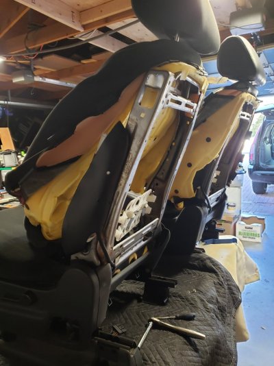

Learn from my mistake check your airbag connectors (turned a 1 day job to a 3 day job) in the world of GM trucks and SUVs not all airbags are the same, even pulled from the same year truck. See if you can test the seats plastic gears are known to break. Any questions on seats PM me your vin number.

Found out today that the front seats I got, do NOT have airbags!
I got two options, 1. Short out the airbag connector with a resistor and leave it unplugged so it won't show on the dash board as a fault. 2. swap out only the top of the seats.. leave the airbag like it should be, I just don't know how difficult or if I need special tools to to this swap.

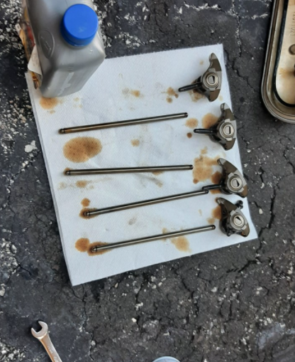

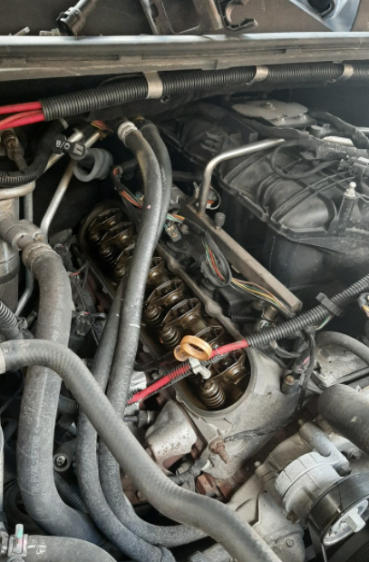

Today I got to work on my lifter noise, took the valve cover off, used carb choke cleaner.. Worked great! knock is almost gone, I would say 90%.. probably should have used more carb cleaner. here is the you tube video I followed to do this.
Will follow up wit an oil change and add Marvel Mystery oil at 20% and it should be gone 100%.
I did 4 at a time, followed instructions in the video.. all good! btw I'm not a mechanic, just like to work on these projects..
Main issue since your Tahoe has airbags and the seats you bought do not have them. The issue is the airbag seat is made a creation way so when the airbag blows the seats rips or the thread used breaks away real easy. They even sell airbag seat covers for this reason. Have to ask yourself will you be driving this car only or will you have wife/Gf/significant other will your kids or grandkids riding in a seat without a side airbag in the seat. Also have to think if your auto insurance find you removed a safety device and someone is injured based on this they might denied coverage (just overthinking it).
2 things before you begin this 1. careful taking the back panel off the seats the bottom hooks/tabs bend easy. 2. Airbags are dangerous you are dealing with a explosive device, Make sure to unplug battery and cycle the key couple times and touching anything metal to discharge yourself before unplugging the yellow connector (all it takes is a 9 Volt battery to set it off). Then when swapping the airbags touch something metal before handing the airbag cover the airbag connector in electrical tape, Keep airbag away from your face, place the airbag face up on wood or anything that will not conduct electricity.
Good video to start
The easiest was I see doing this is to swap the leather cover to the old seat Foam and frame and not remove the airbag.
If you do want to tackle this project contact local car upholstery shop on advice and quotes.
View attachment 347814 View attachment 347815
I use Motor medic Valve medic first before I do any valve or lifter work have fixed a couple cars with DOD and couple 5 cylinders volvos.
Good video to start
Soo, I did contact the upholstery guy I usually go go for seat repairs.. He told me the stitching is the same on all seats, the nylon mesh and the rip on the foam are what guides the bag out on impact. So I went ahead and took the airbags out of the old seats, placed them in the new seats along with the ripped foam.. had to drill new holes on the metal support to fit the airbags, the new seats did not have those holes cut out. Could not get the nylon mesh since it is sewn into the old cover itself, so just left it like that. I feel it will be safe , the airbags will pop when they need to with out problems, if I would have left the old foam, the bag would have nowhere to go when it did pop. Took me about 6 hours 4 for the first seat (tinkering, Being careful), then the second seat was much easier, 2 hours, fixed the lumbar support that was damaged.. Thank you for the video, it was very helpful.
