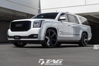

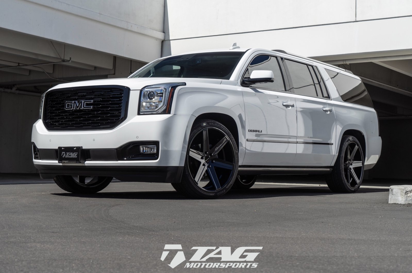

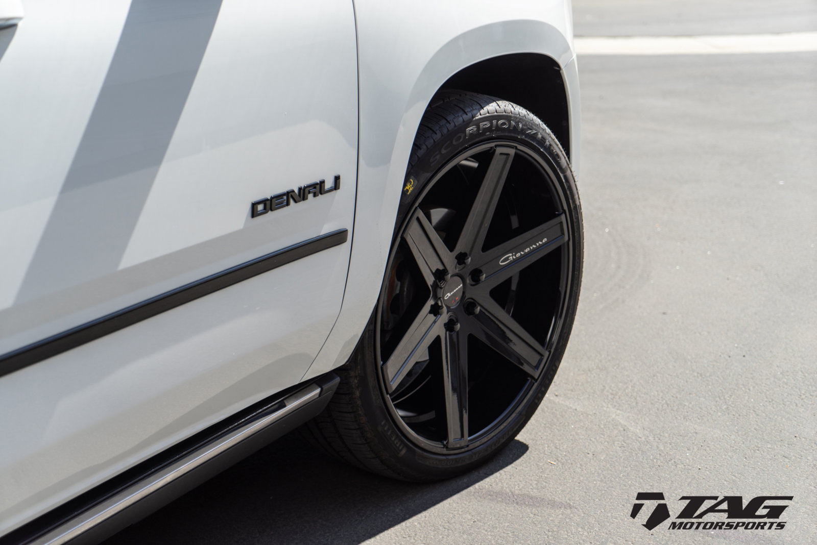

A quality tire makes a big difference. I have 24’s wrapped in 285/35 Pirelli Scorpion Zero’s. The Mag Ride is flawed by design in my opinion. But my new set up is still smoother than the oem 22” denali wheels on whatever the factory puts on them, I forgot.
My big quedtion is, does AC Delco have an airshock to replace the rear MagRide airshock? And what is the part number? It should be the same for 2015-2019
