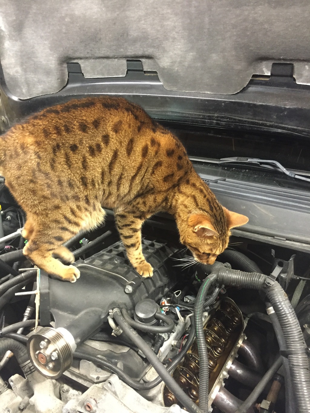

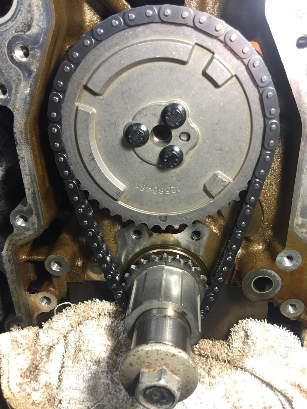

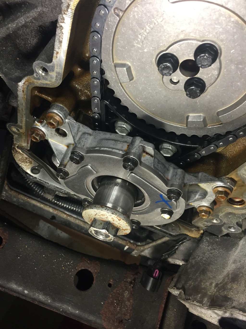

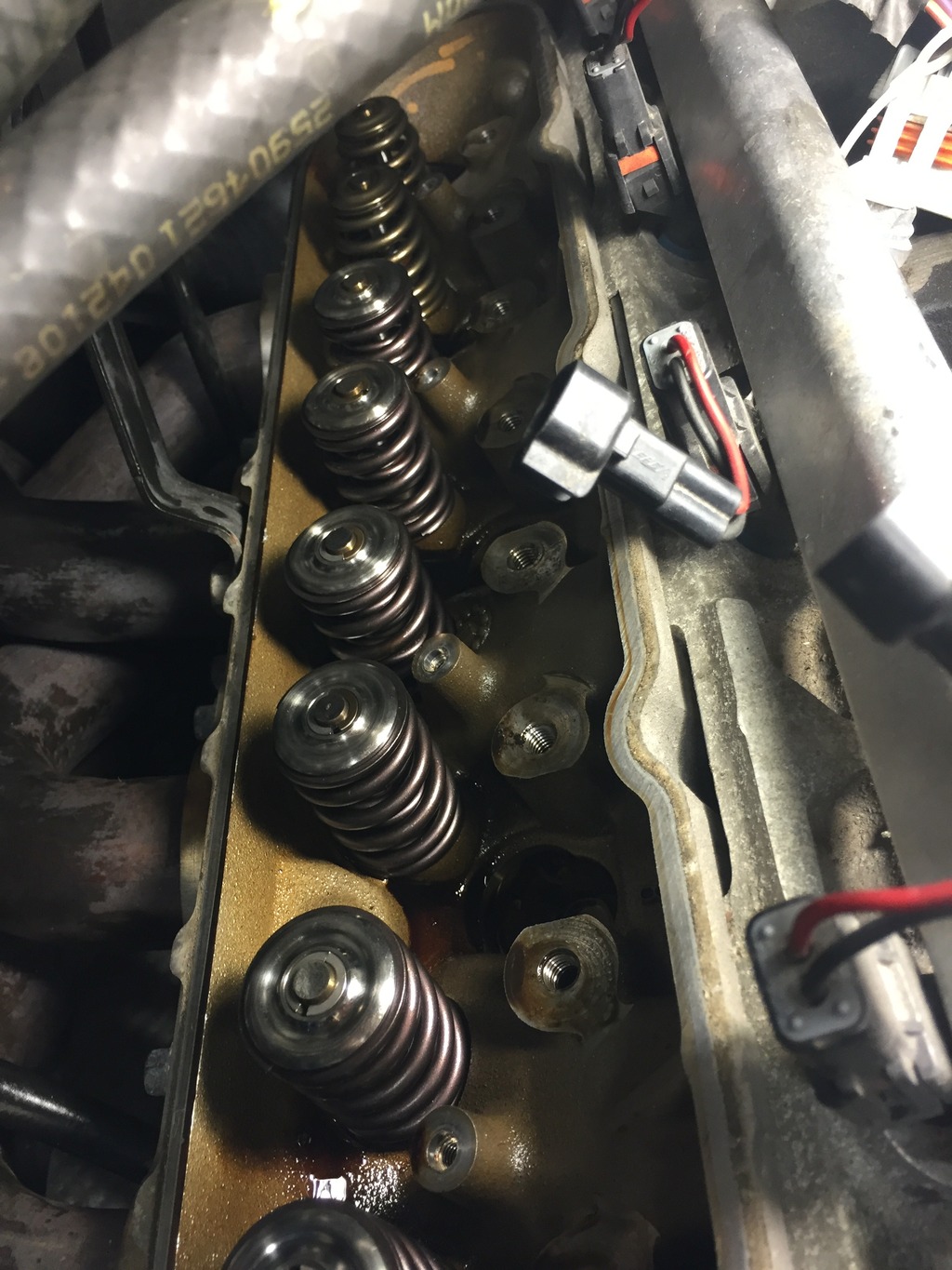

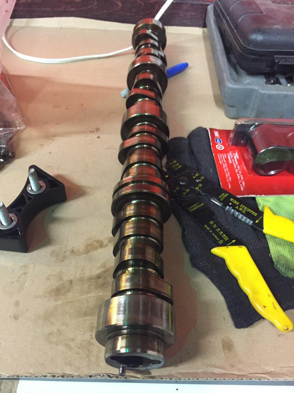

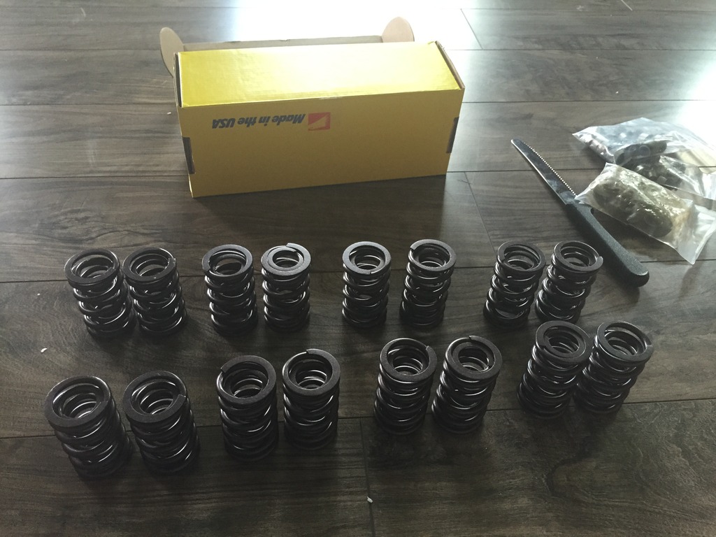

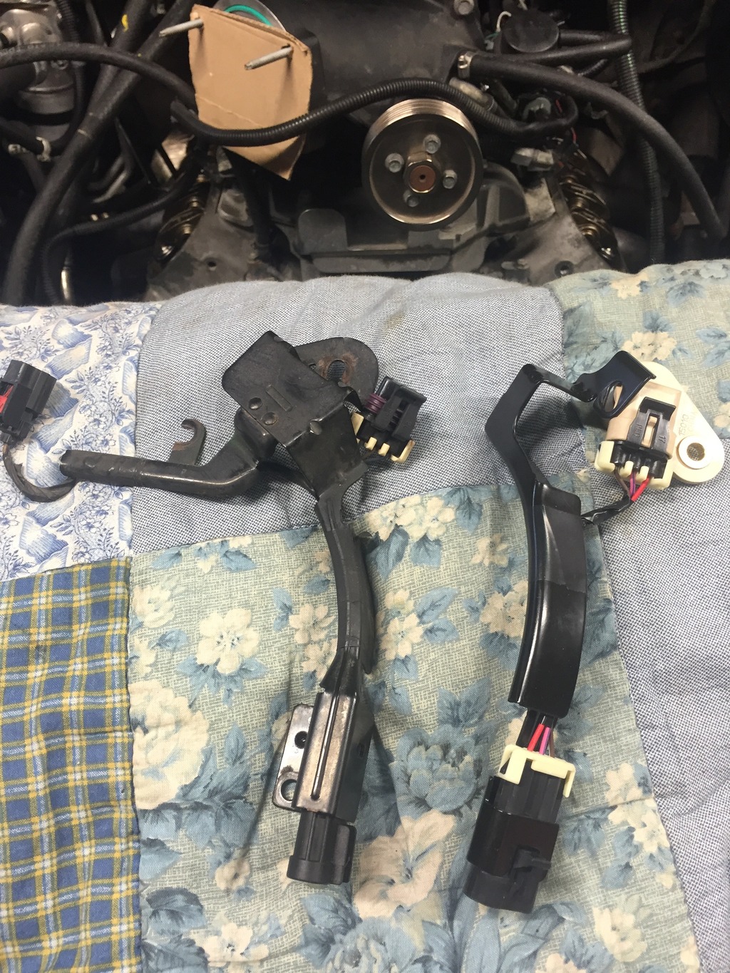

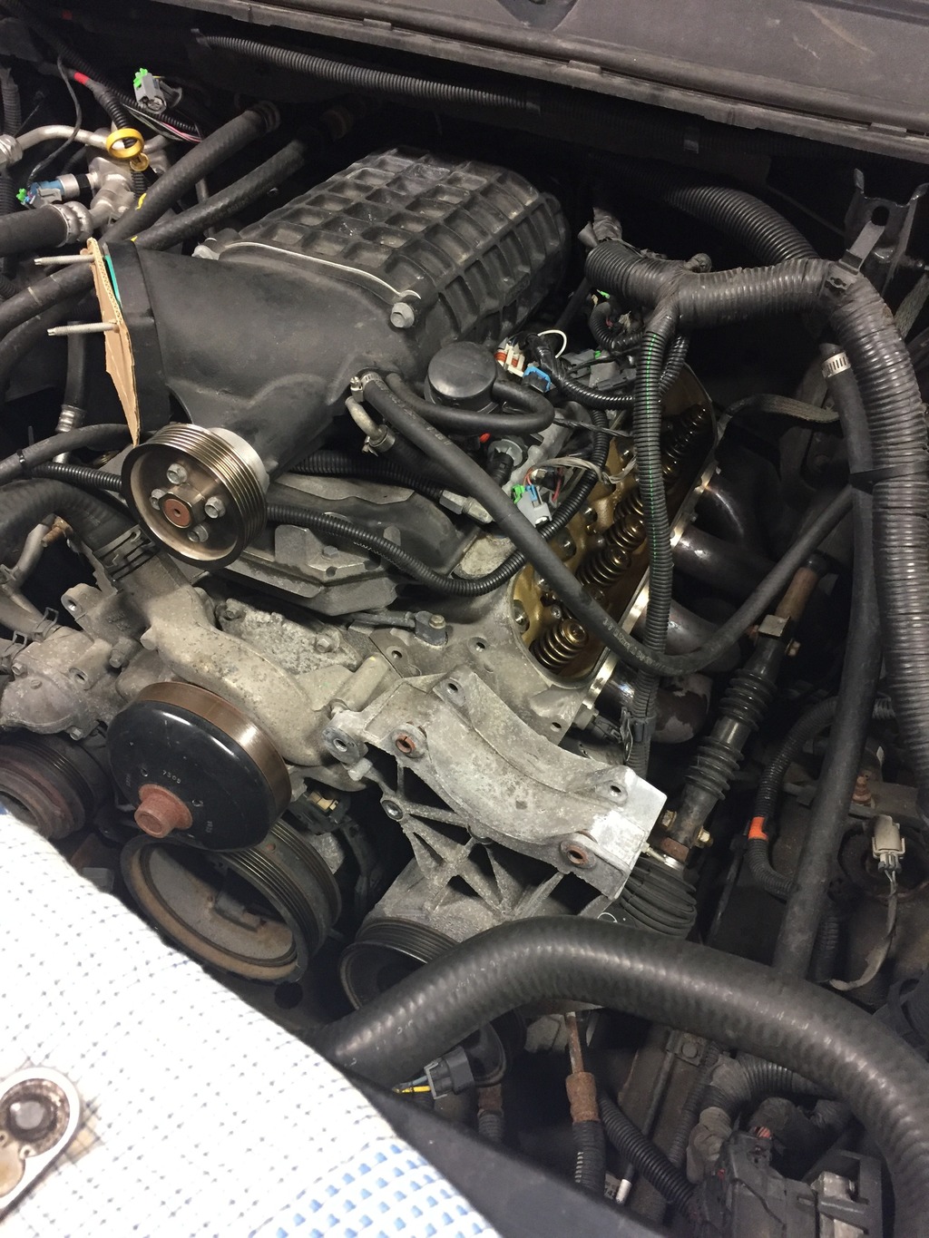

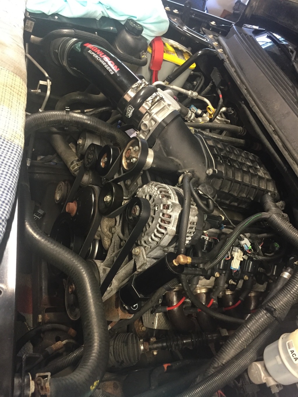

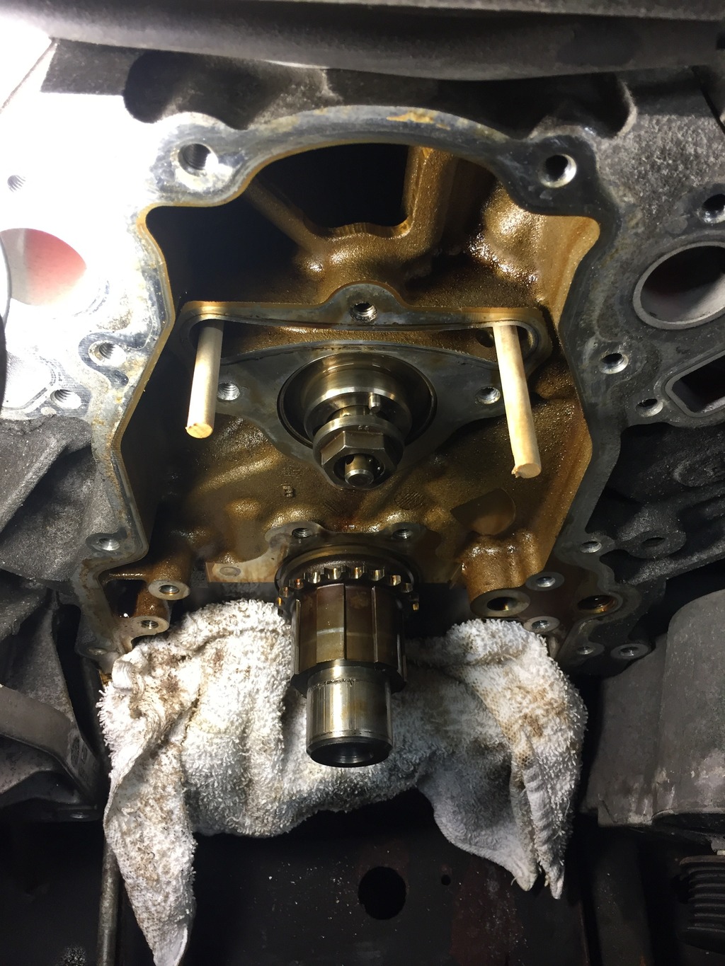

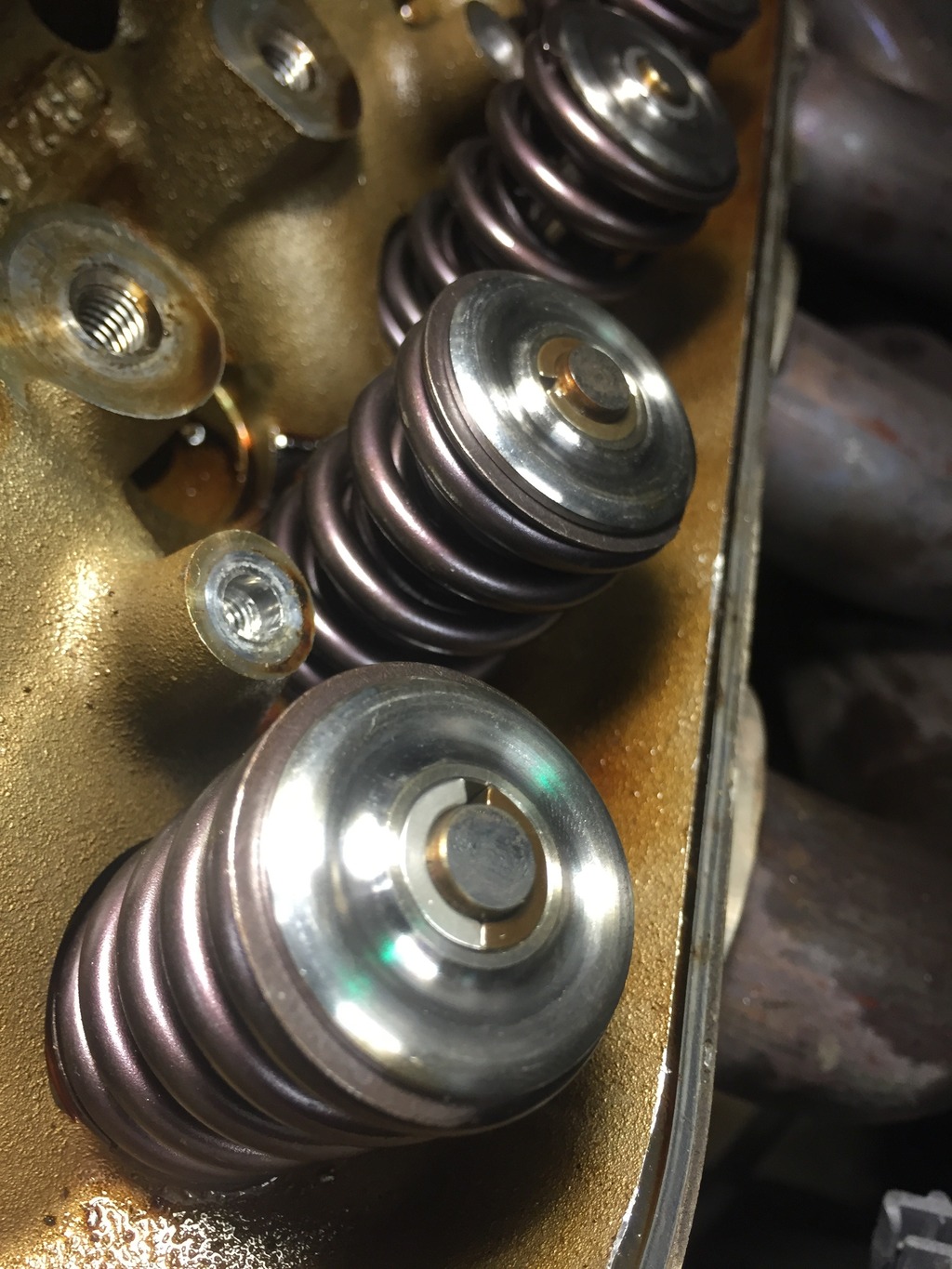

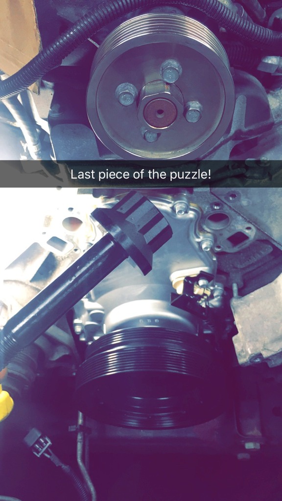

Lil updates on whats happenin w the old lady...went HAM on it this weekend after having the parts lay around for a few months...too bad i didnt plan things better to get a few more things that are still in the mail or it would be done this weekend...Waiting for the OD 8 rib crank pulley, new oil pump and the pin kit to come in, then shes ready for the tuner...
Parts list includes:
VVT delete
Cam Motion custom ground blower cam
Dual Springs
Titanium Retainers
HD belt tensioner
10% OD 8 rib crank pulley (starting to build my 8 rib setup)

Looks like you added one mini tiger power in the process...bad dood! Color me jealous, that friggin tvs1900.can't come soon enough! Lemme know your thoughts on the 8 rib as I'll be looking that direction once I bolt my blower on. Also, I thought the newer Maggie's came w the hd tensioner??? I was magnusons first case of broken tensioners back with the radix on my 6.0 SSS.... Was a nightmare, always had to keep a spare tensioner, belt and tools in my truck at all times... Roughly a 2 to 3 tensioner a month habbit... Got old fast, really hope I'm not stepping back into that situation... Anywho, Looking good and exciting, be sure to give me a ride when you finish up... Def need another motivator pull soon!

Will do...no mine didnt come w HD tensioner...

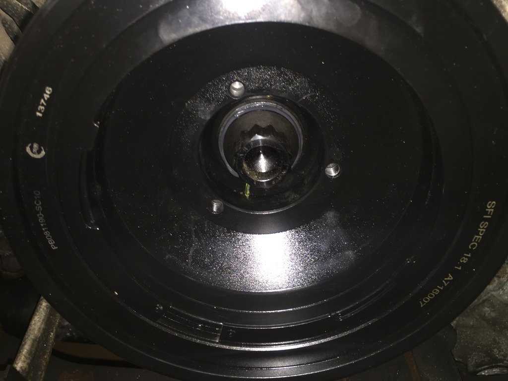

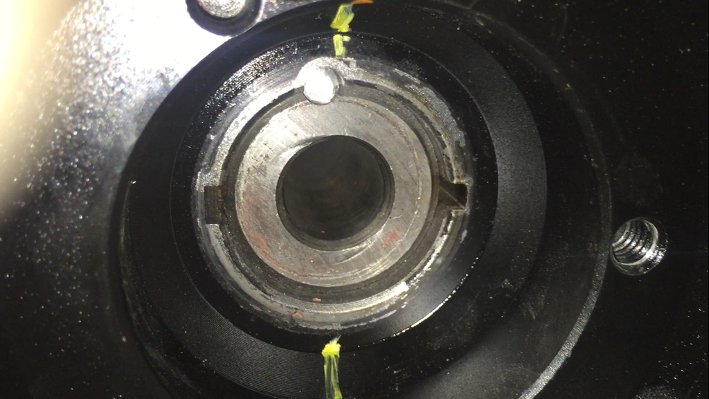

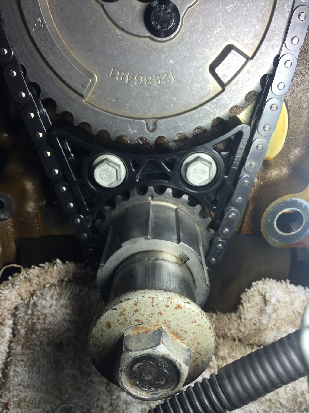

8 rib isnt necessary unless u get some crazy spin...number one thing i learned is to key that crank..key that crank...key that crank...my crank shaft has some scar marks from it spinning as well as my crank bolt came off super easy...

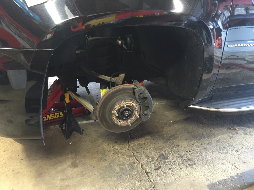

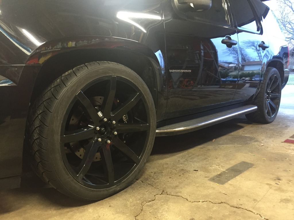

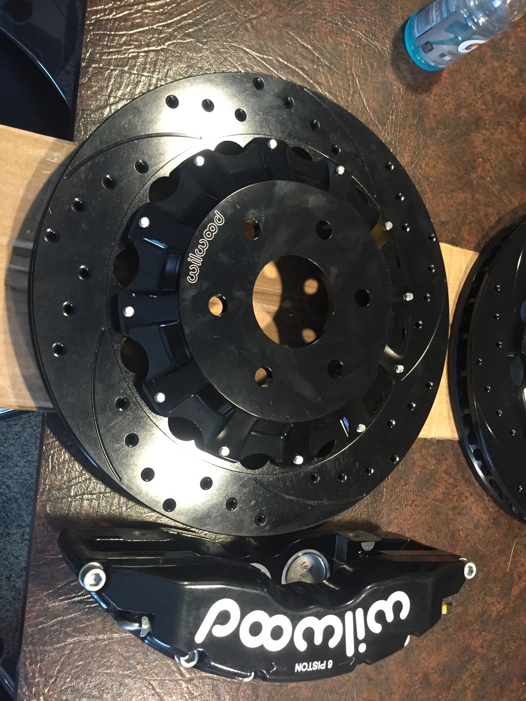

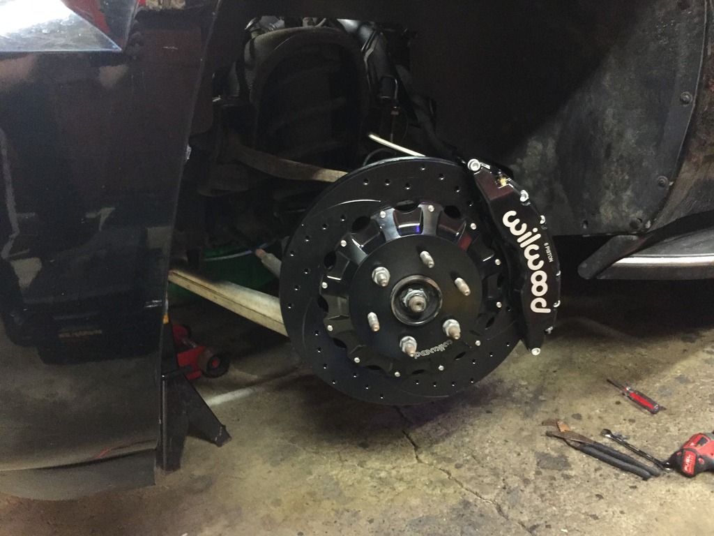

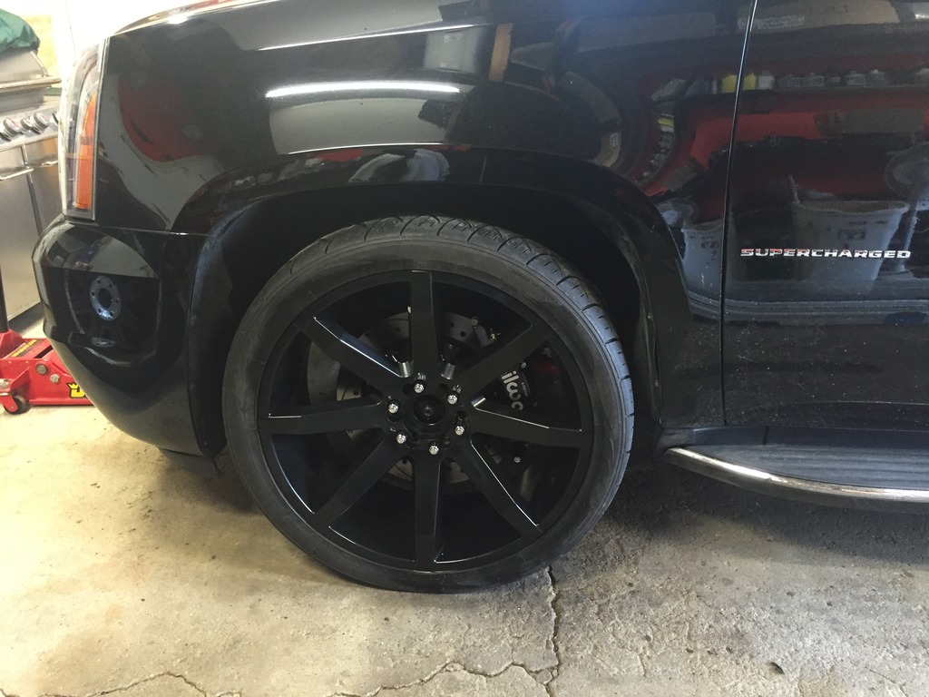

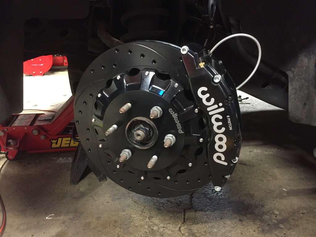

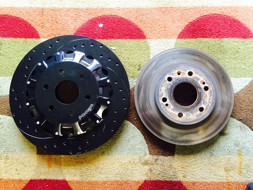

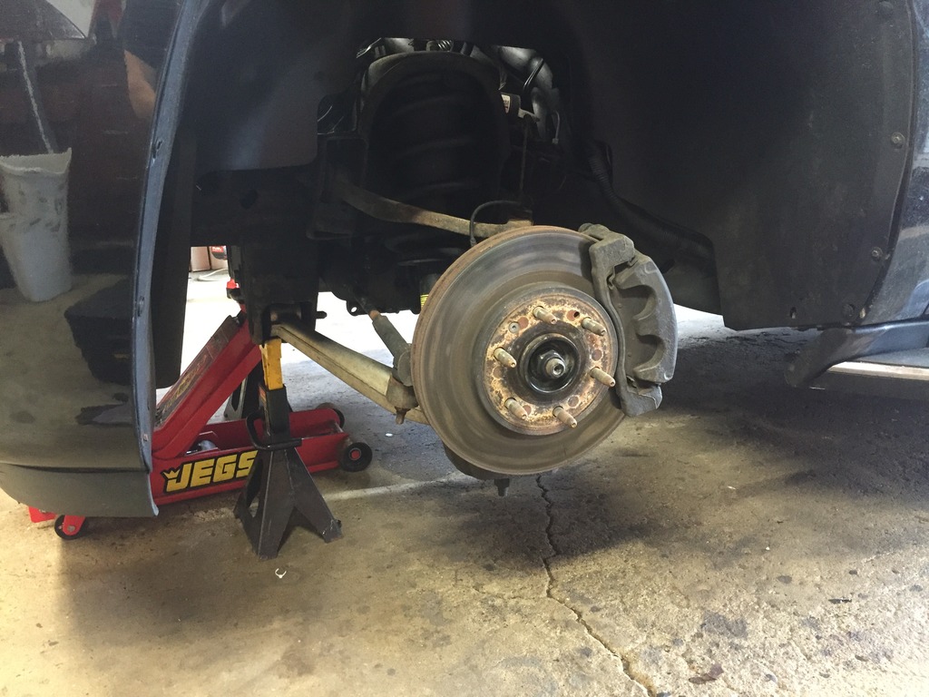

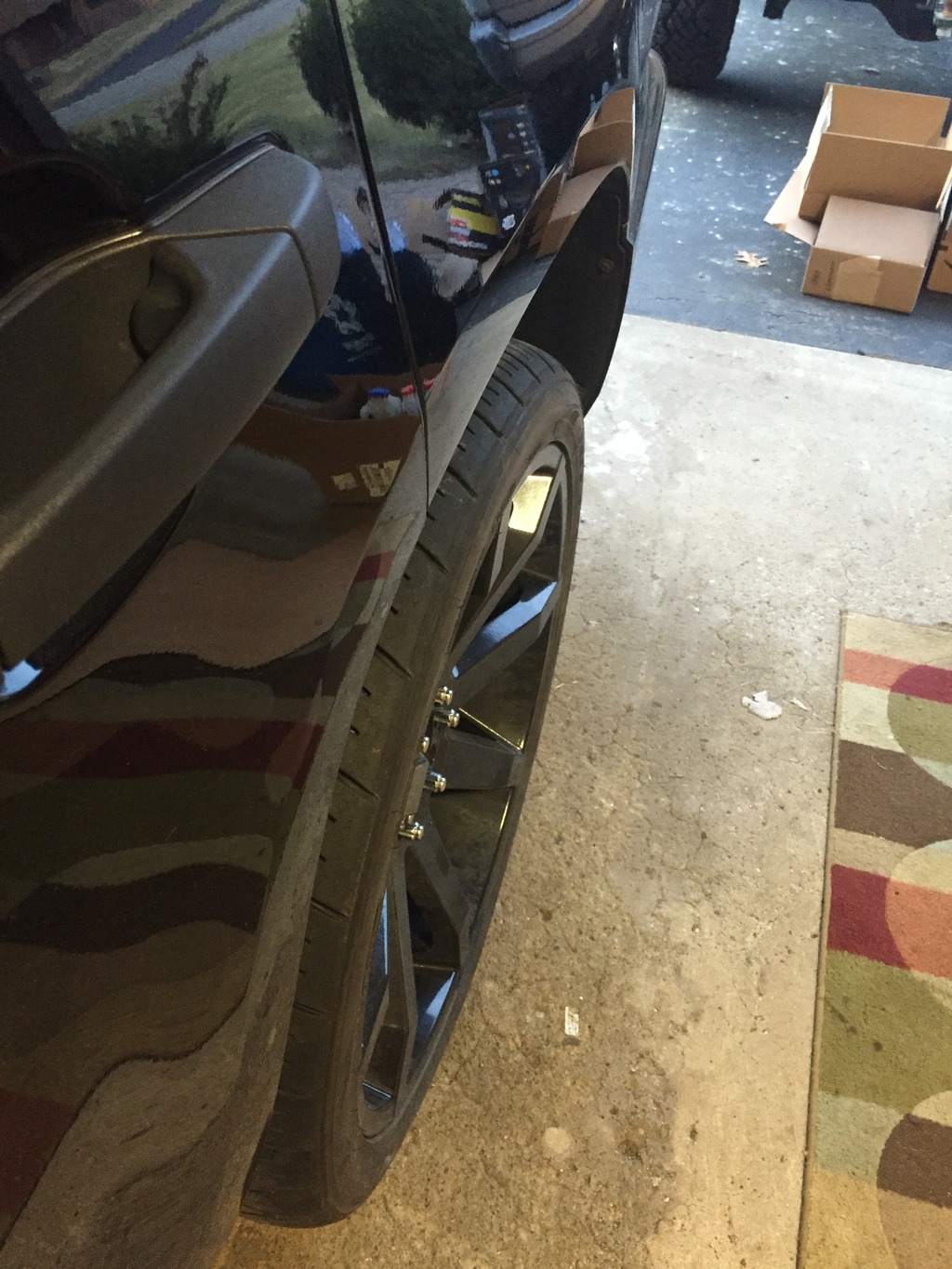

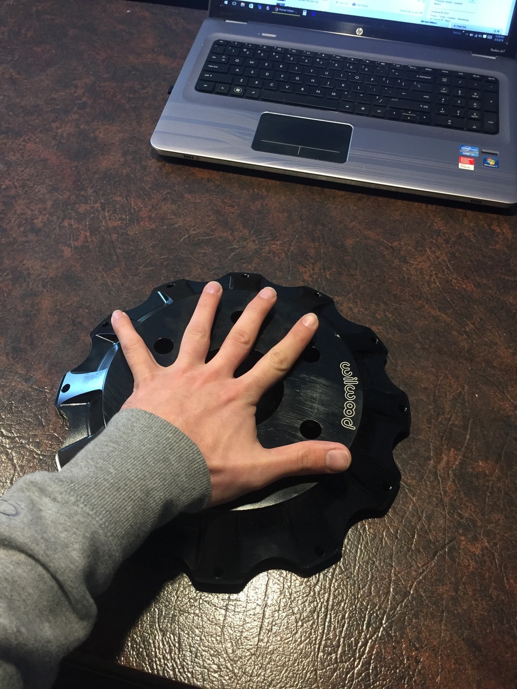

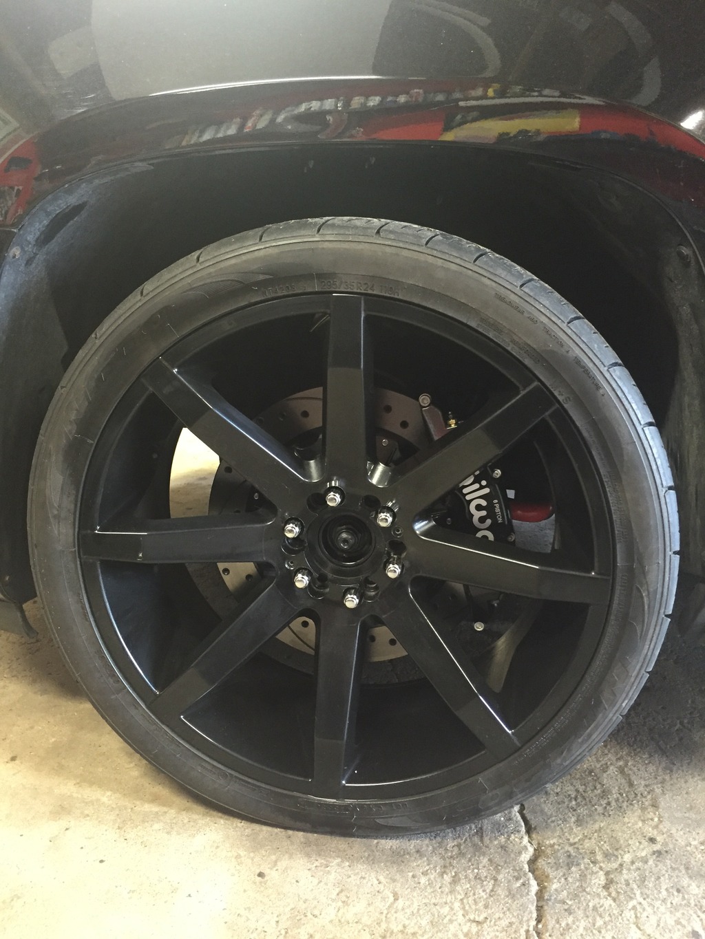

This is how i spent last week. Ended up purchasing the kit from here...16" wilwood 6 piston ....makes the stock rotors look baby...i need to get the rears now as they look way small...sorry for the pic overload
Also finally adjusted the rear panhard bar to center rear axle after the drop...installed last year but never really got to adjusting it
Fosscore
Apr 16, 2014
10,885
19,845
Sounds so good. I am glad you bought those damn Wilwoods!! I saw them as soon as he listed them but just couldn't pony up. Perfect for that supercharged beast to stop her down. :thumbsup:

Thanks guys. Yea she needs black and shorter lugs nuts. She deff needs them. U can tell I heat cycled those stick rotors a few times. Now I need to find some rears!!
