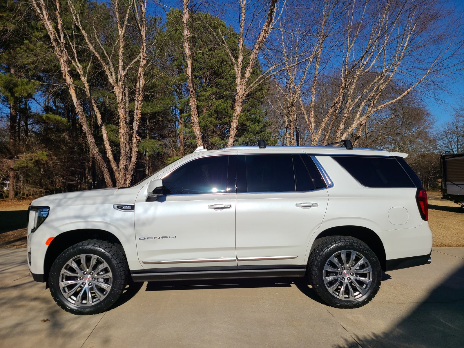

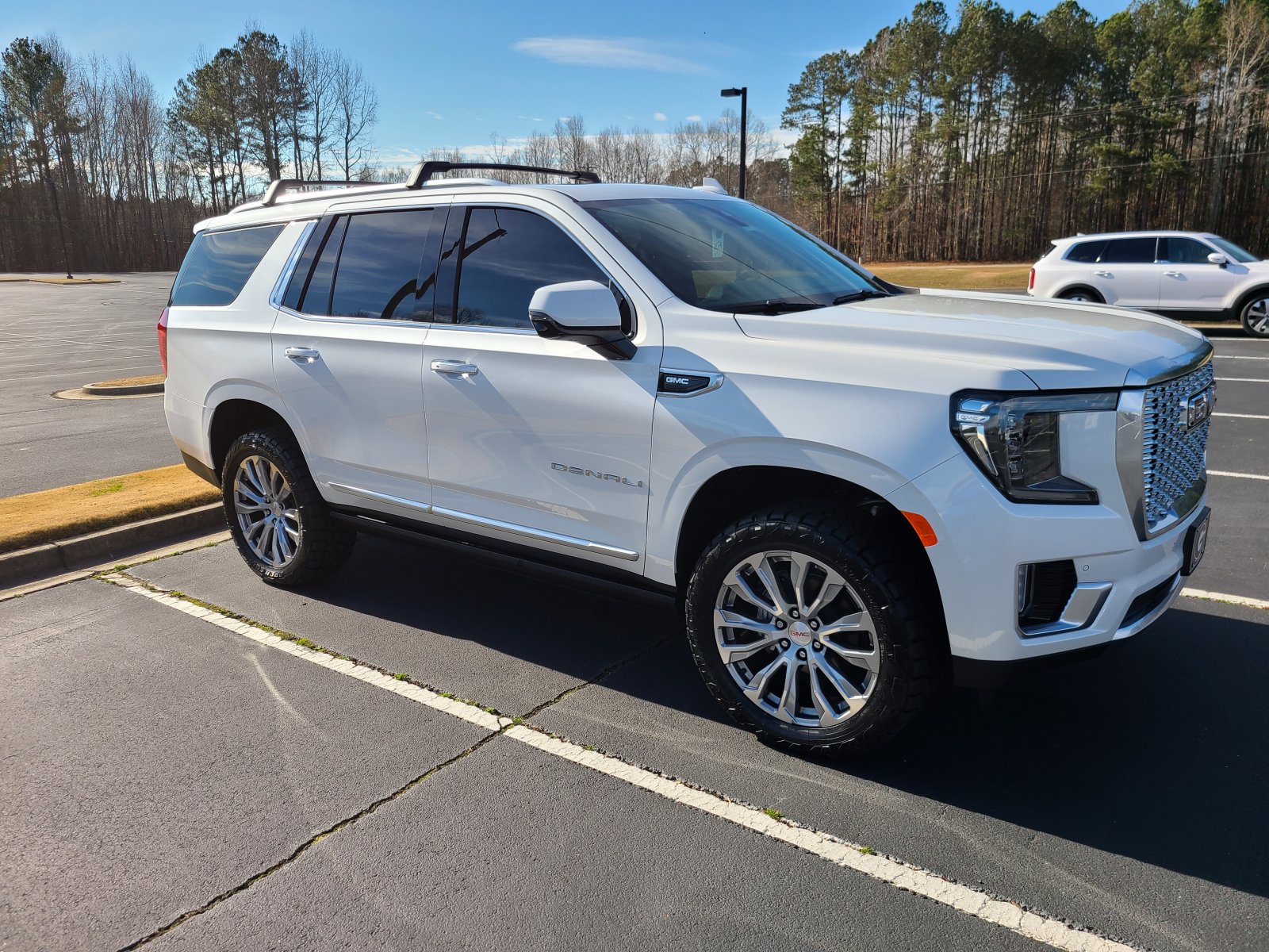

285/50/22 Toyo AT3 completely stock 2021 Denali. I did have to pull back the front inner wheel well liner just a bit and zip tie it. It barely touched the liner at full lock and flex so this was really not needed but I did it as a precaution. You can't even tell unless you crawl underneath and look.

Welp, that looks fantastic.
