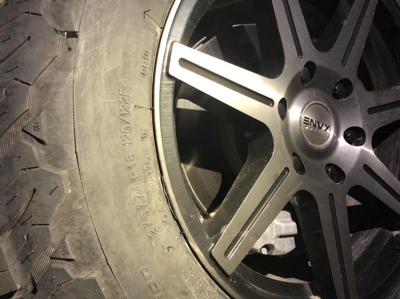

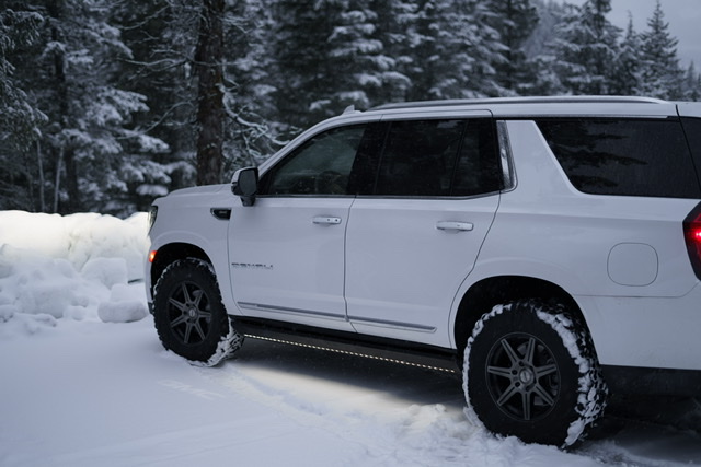

You can run 275/70/18 without lifting or leveling. It’s just a fraction of an inch larger than stock Denali which is already 33” at 275/50R22. And the spare tire is 17” so 18” fits over the brakes without issues.
That’s exactly what my Denali is running:
Awesome buddy!! You have saved me a ton of work!! And also...seriously, the spare is still a 17”?? How does it even fit!!
Beautiful truck btw!! So let me get this straight, you are running 275/70/18 in this picture?
