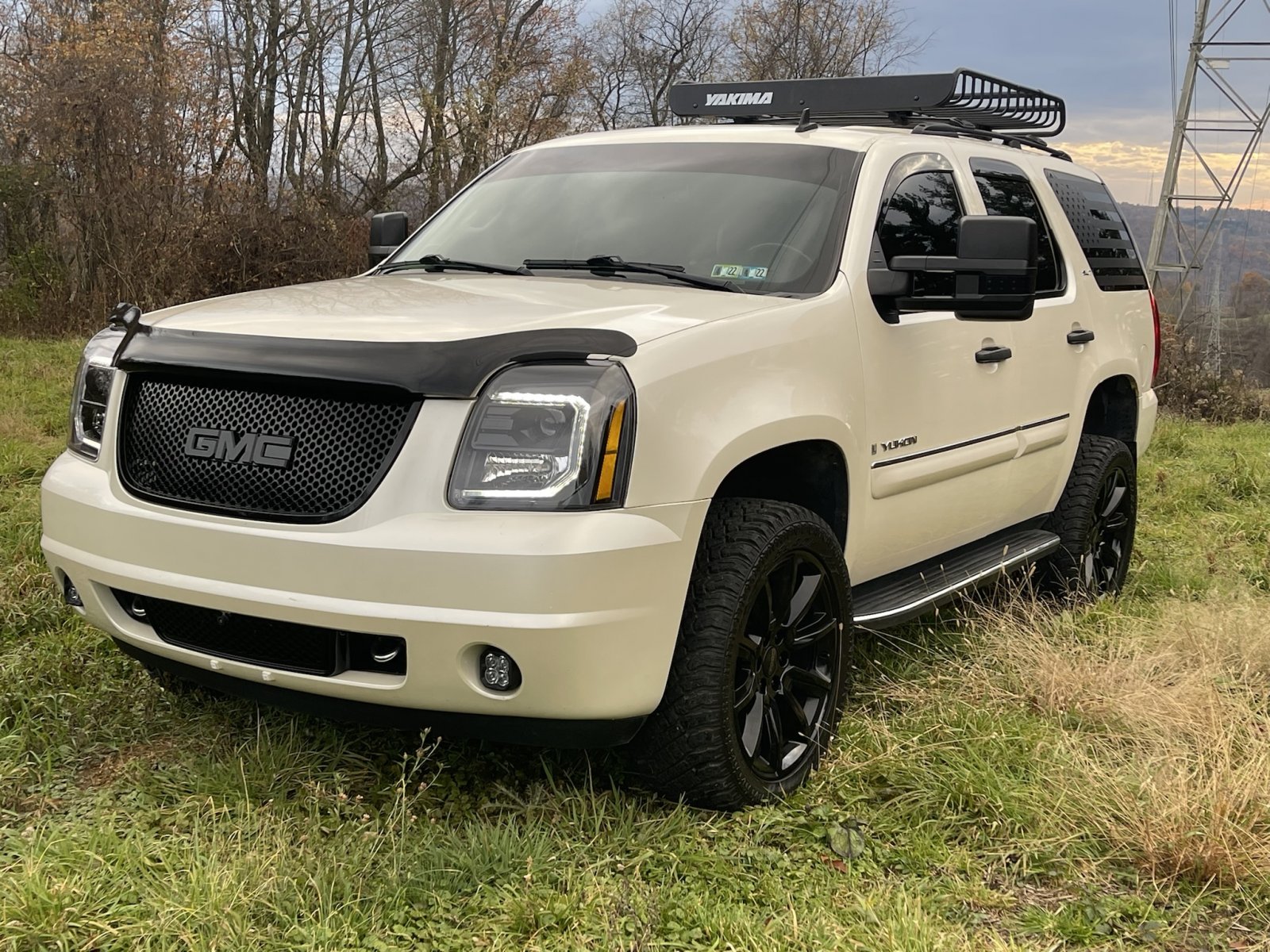

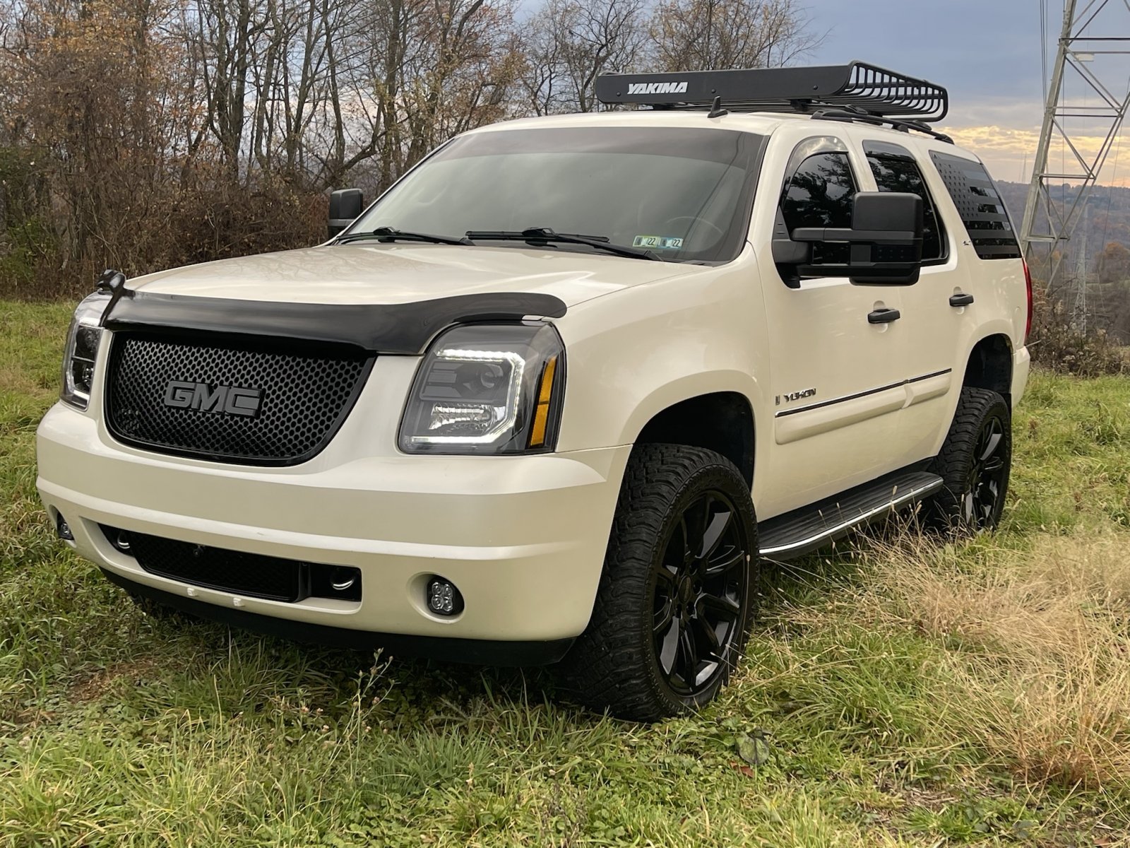

I'm getting a slow crank when starting as if the battery is low. Battery was a few year old so I replaced it but still getting the slow crank. I checked battery circuit for parasitic loss and I getting nothing showing up on the meter. I'm thinking worn out starter ? Any advice ? 170k miles.

Probably, unless the wiring from the battery to the starter is corroded and needs replacing. Truck looks great!
