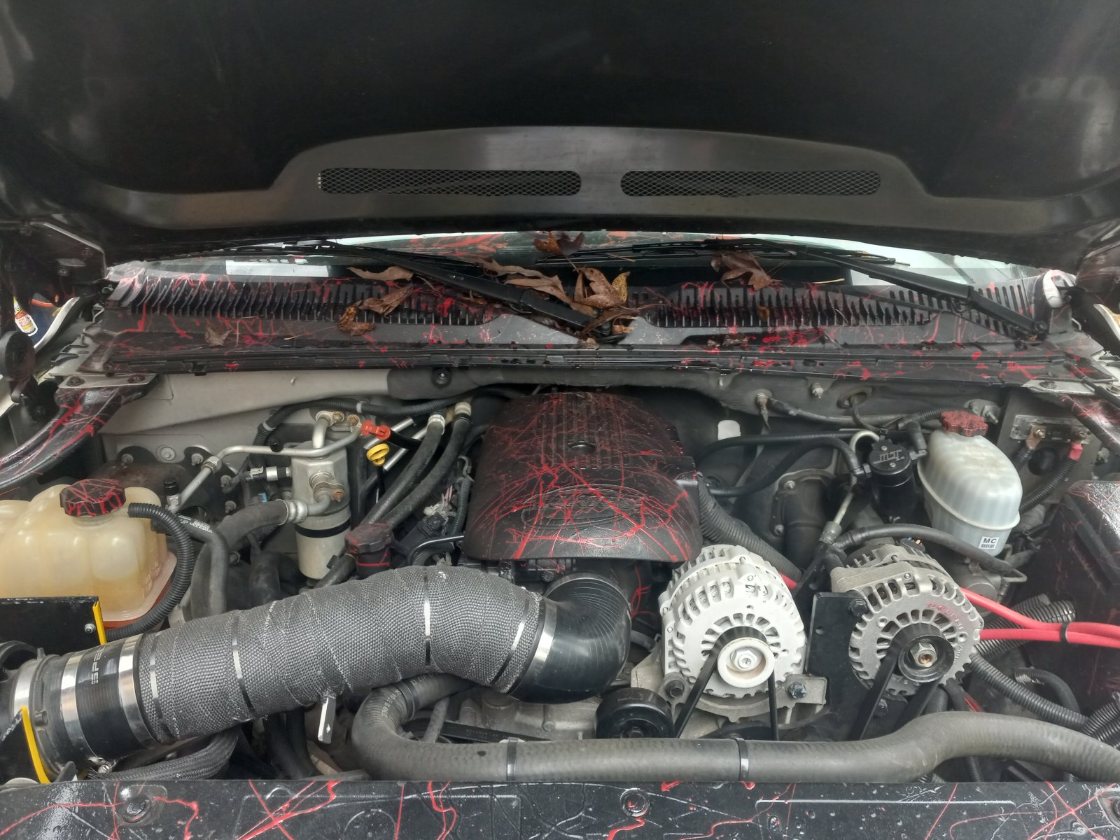

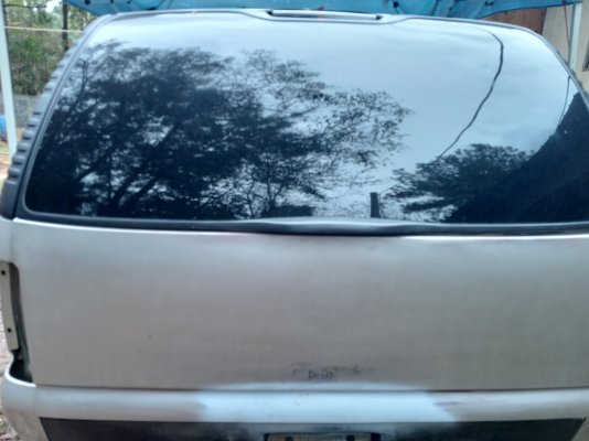

This build has definitely taken a while.
Here's what I've done so far
Mcgauhys drop spindles
Dropped tourqe bar keys
Djm uca
Lca stock
Spohn adjustable pan hard bar
Spohn adjustable lca
Spohn adjustable uca
Free travel mod
Nitro drop shocks front/rear
Fiberglass rollpan
Decenti 24" wheels wrapped in lexani 275/25/24
Mcgauhys drop coil springs in rear (modified)
4.8 ls with BTR 224/230 .553 lift cam
Double beehive valve springs new seals
Ported polished throttle body
Longtube headers
FlexaLite electric fans
Oil catch can
Optima red top battery
Circle D 3200 stall converter 4l60e tyranny
Eye of Megatron led headlights smoked headlight assembly
Led turnsignals
Dual brightlight mod
Black honeycomb grill
Double alternator bracket with alternators
Pcm programmed by Casey Texas Speed
No interior airbags
Grant gt steering wheel
Black/red stiched racing seats with Tanaka 4 point racing harness
Center console I made from Fiberglass holds switches for stereo it also holds extra optima yellowtop battery a skar 1000 watt Amp and autoloc accessories for door poppers.
3 Rockford Fosgate amps
4 rf 6.5 mids
2 rf 8 mids
6 rf supertweets
4 skar 4" tweets
Harwood Fiberglass cowl induction hood
Shaved door handles,rear hatch,roof rack and xm satellite
Drilled slotted brake rotors
Stock calipers
Things left to do include
Paint
Wall for 4 15" subs
Probably left out few things

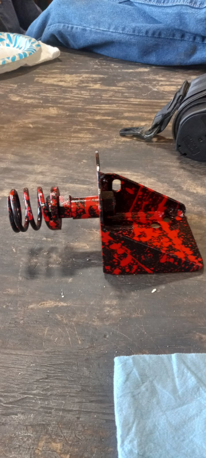

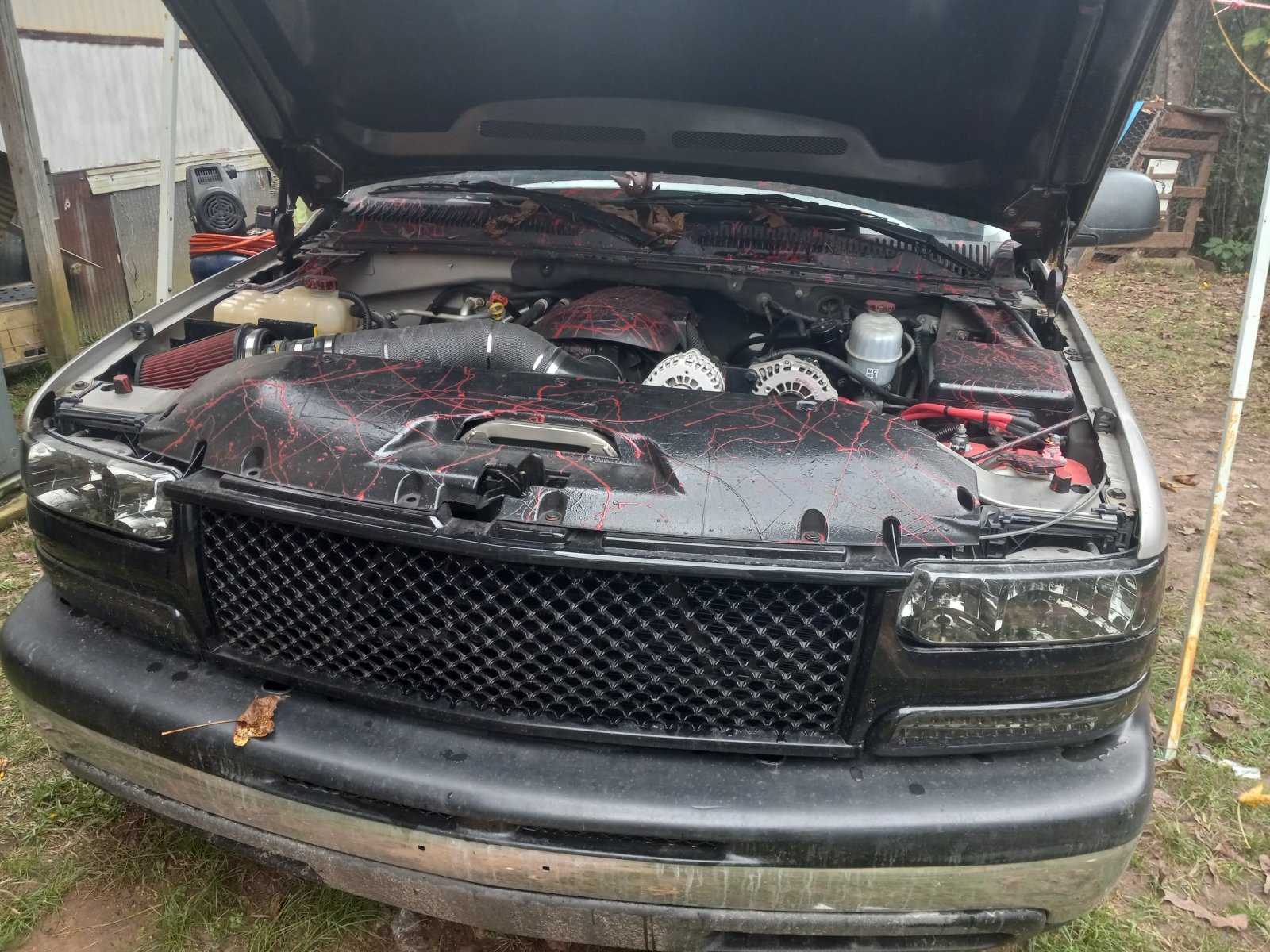

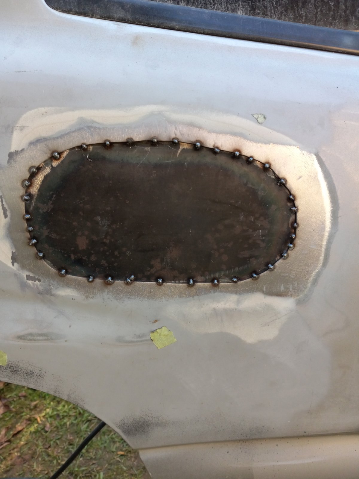

More pics otw
