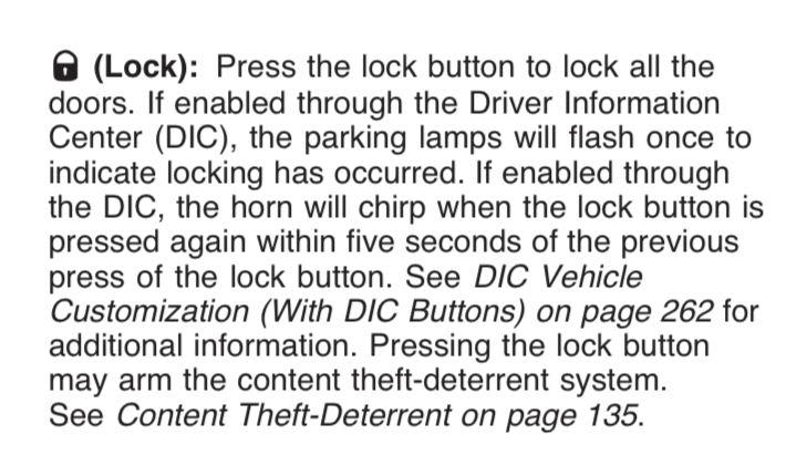

Did you confirm that your settings on the DIC are correct?
Also, if it thinks a door is open, it will act differently as well.
EDIT: I confirmed that on our Yukon, if a door is open, the horn will not chirp. You might have a bad door-open switch. Do your dome lights stay on?
