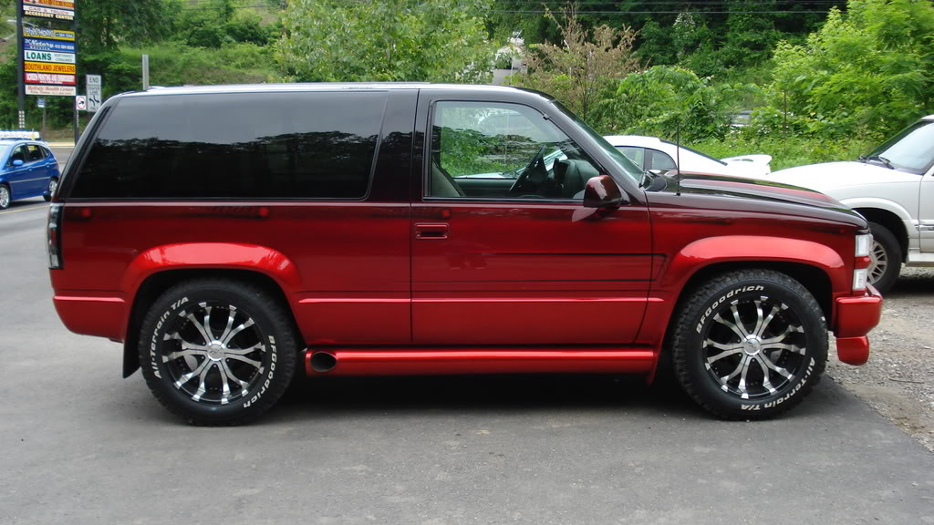

Wow that's a sick tahoe, thanks for the find destroyer. That's exactly what I want except not painted/covered. Would look so much better too if mine was a damn 2 door! I hate having a 4 door. :(

Nice, looks good. I think it would look better if the pipes were exposed like the SD above.
