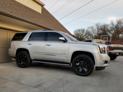

Pre and post with motofab 1.5" level...

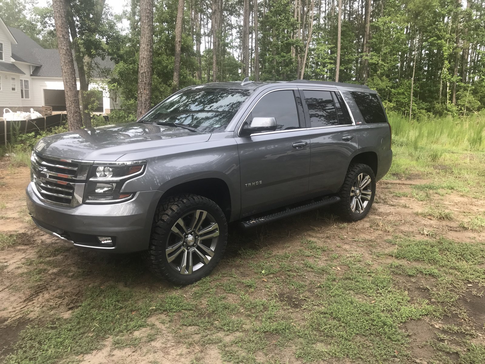

ended up going with 285/60 toyo ats and 2” suspensionmax leveling kit. only rubbing was on right rear inner fender liner, a little heat and massaging and it was good.
Are those 20” knockoffs of the oem denali 22’s?
Looks good!!
