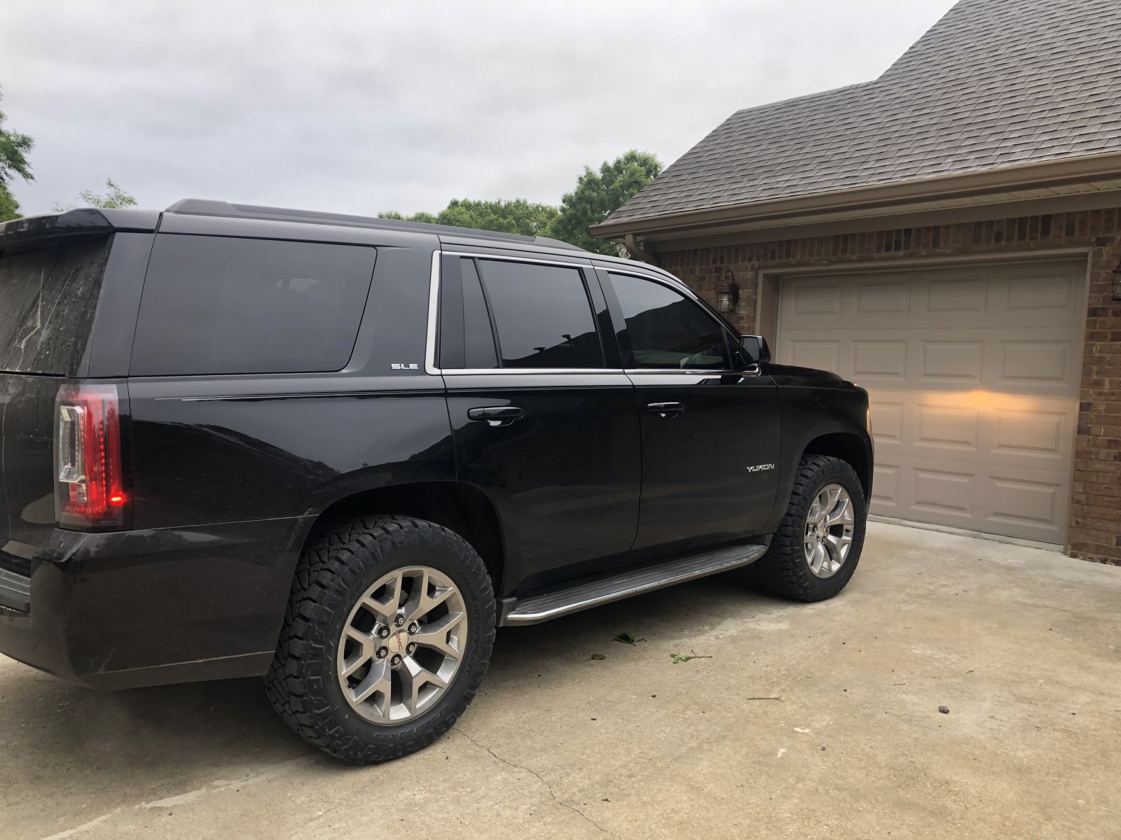

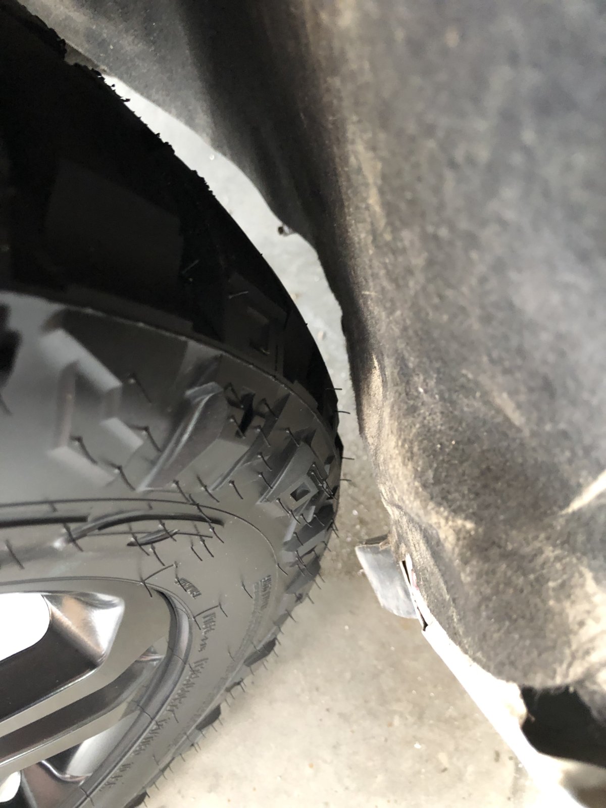

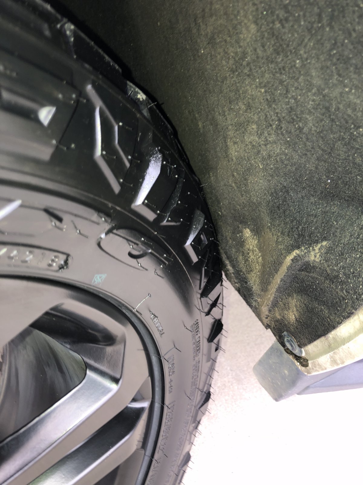

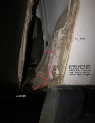

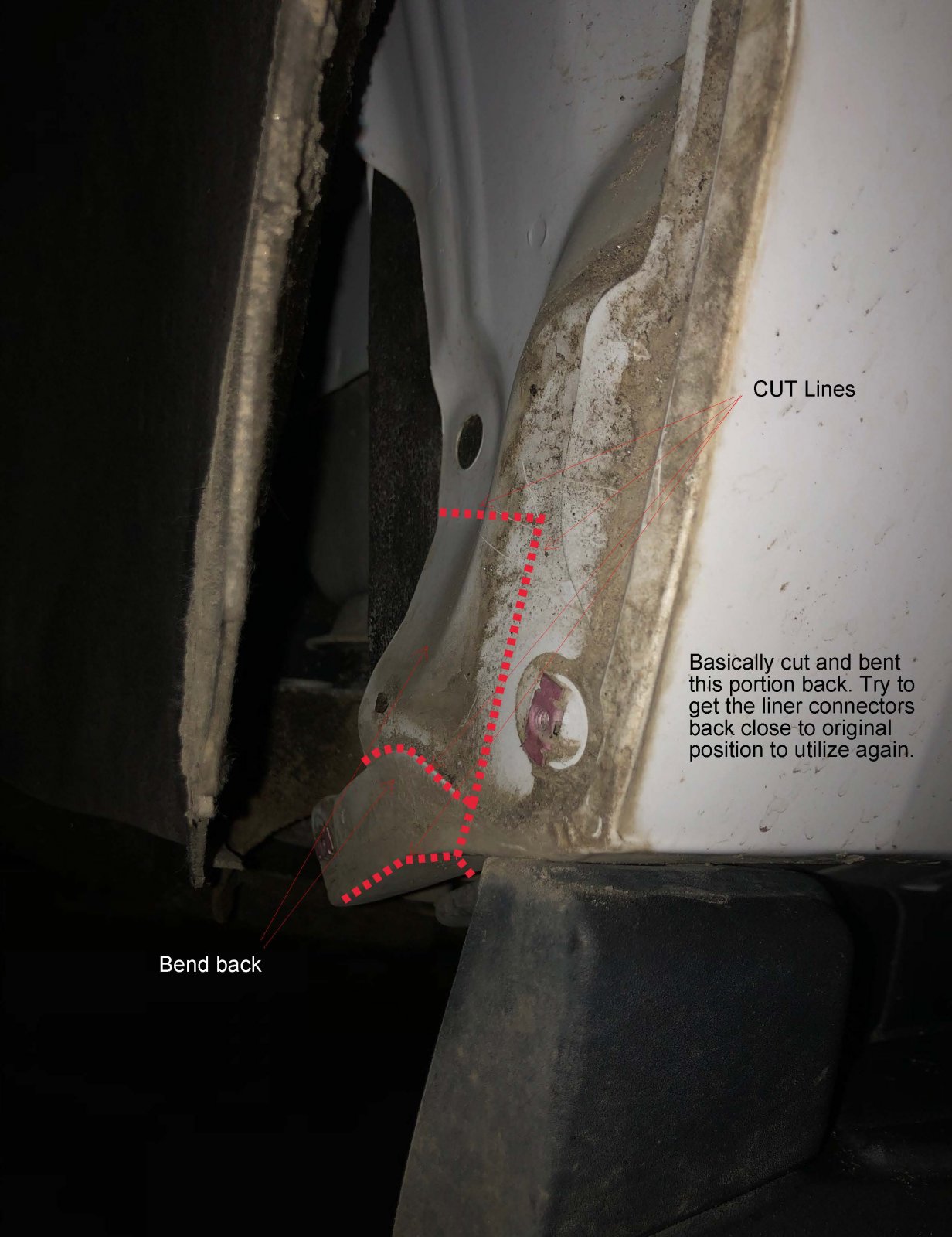

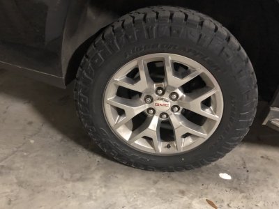

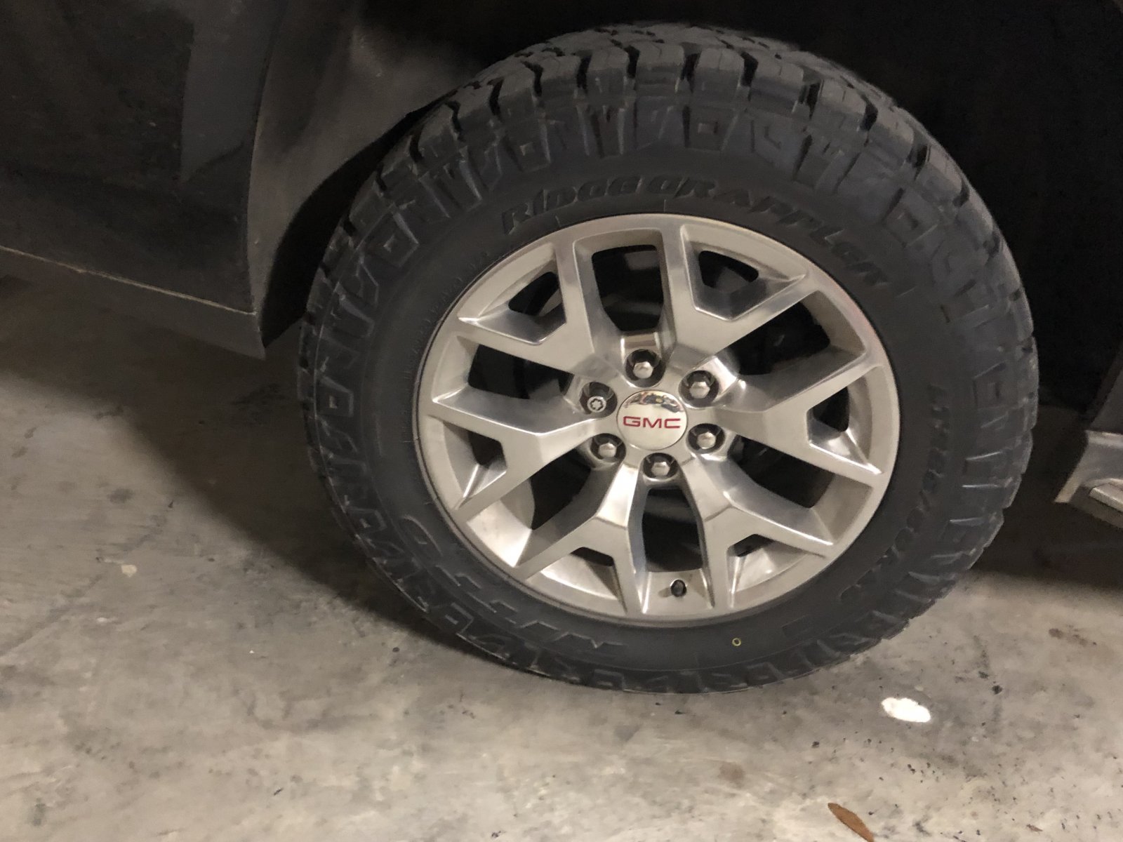

What'd you do to gain the clearance? I have a minimal amount of rubbing in this exact spot and need to do something about it.
I was considering picking these up and seeing if I could make them work on my Yukon.
http://zoneoffroad.com/blog/zone-new-product-announcement-135-gm1500-fender-trim-plates/
Pulled the liner back and cut/bend the bottom metal back with metal wheel. Just takes some time. Do some research - Norcal fender tuck, probably wont find video on Tahoe but several on trucks to give you an idea.
After making cuts with metal wheel, bend/beat back the metal with a mallet.

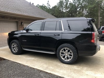

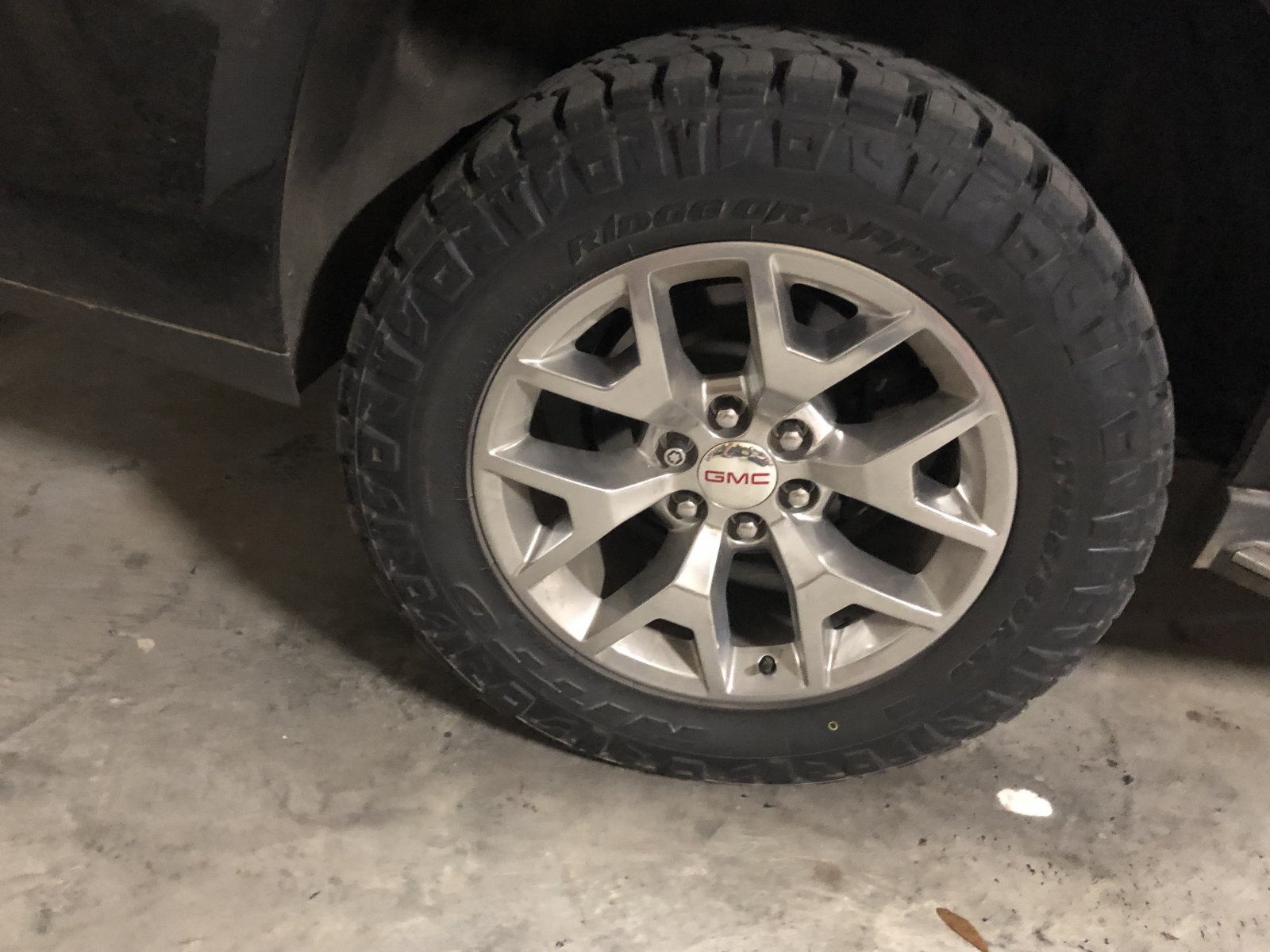

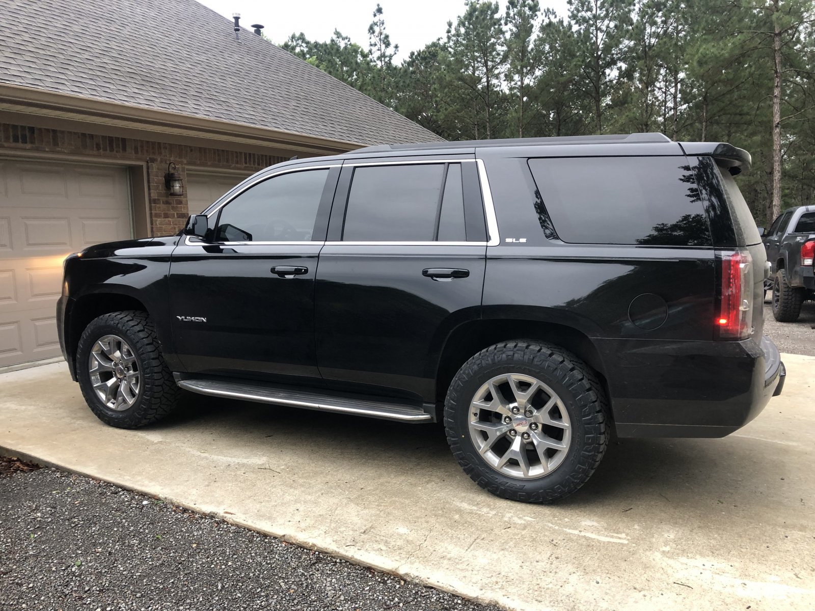

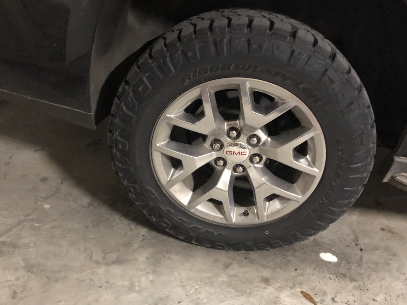

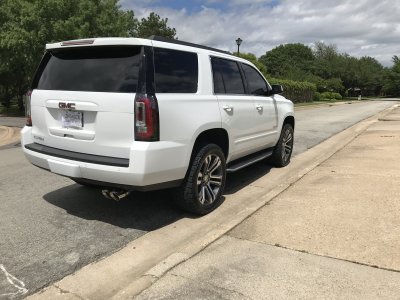

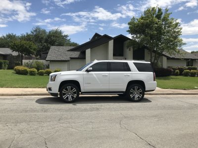

Very nice. Any issues with rubbing on your setup? I'm getting my 2" leveling kit on next week and am leaning towards that same size ridge grappler on fuel maverick D538's.
There is slight rub at full turn. But I’ve been driving almost a week now and no rub with normal driving . Even turning into tight parking spots

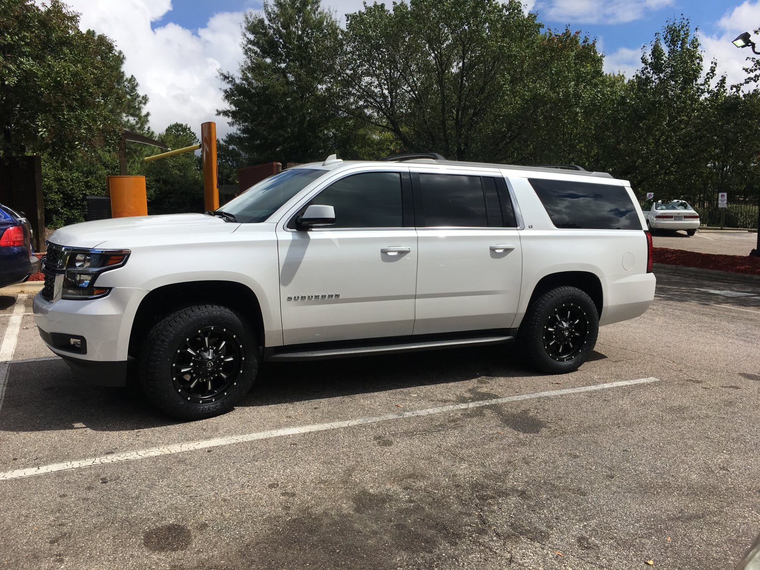

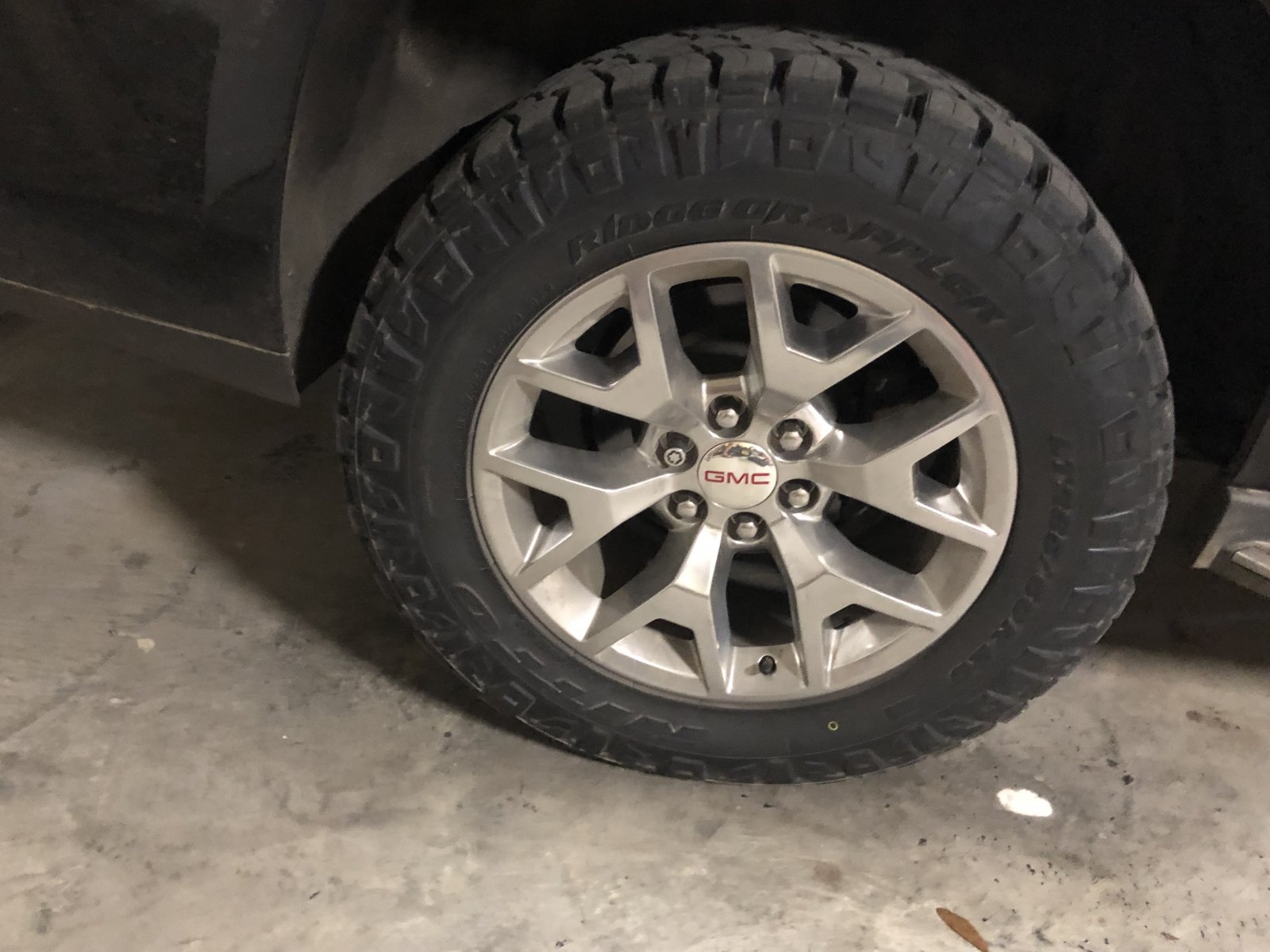

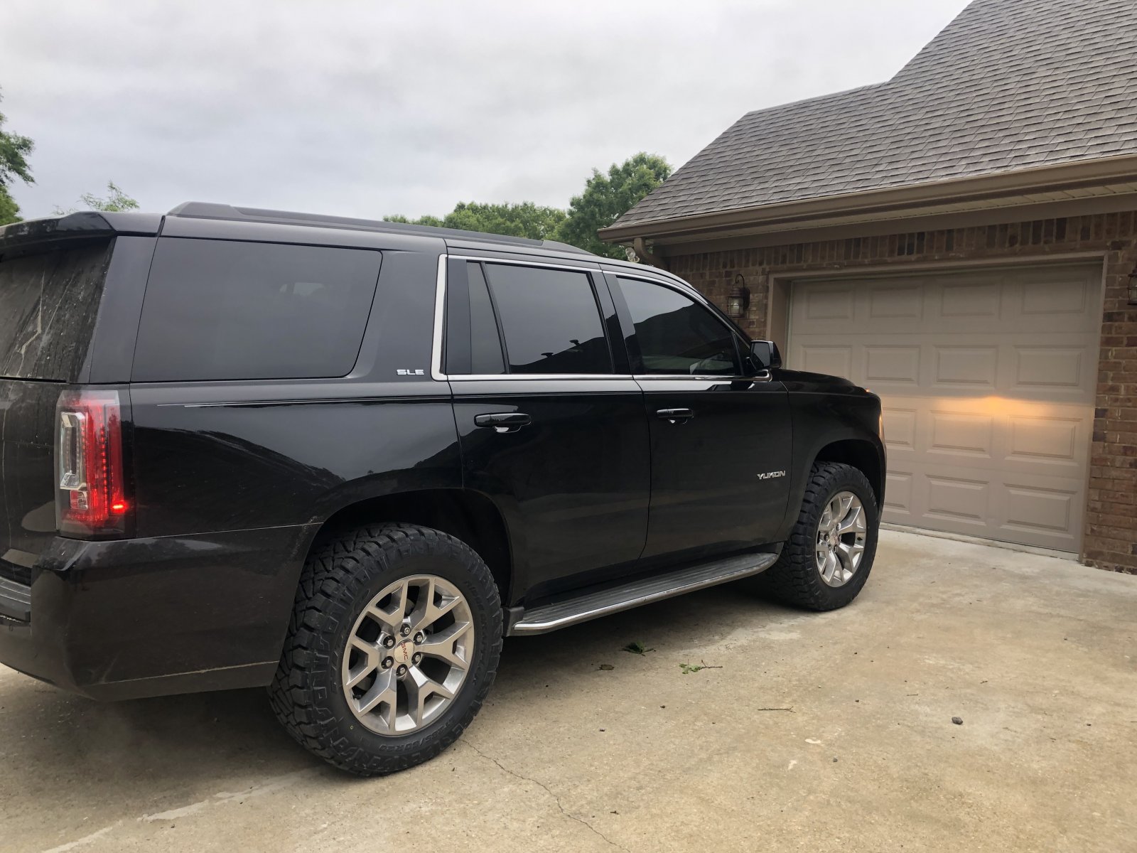

Is anyone running a 2.5"/1.0" level with stock 18's? I was going to wait and install my level after my 22's arrive but my patience is lacking.

What offset on wheel? Less rub on fender well if you stay closer to stock offset.

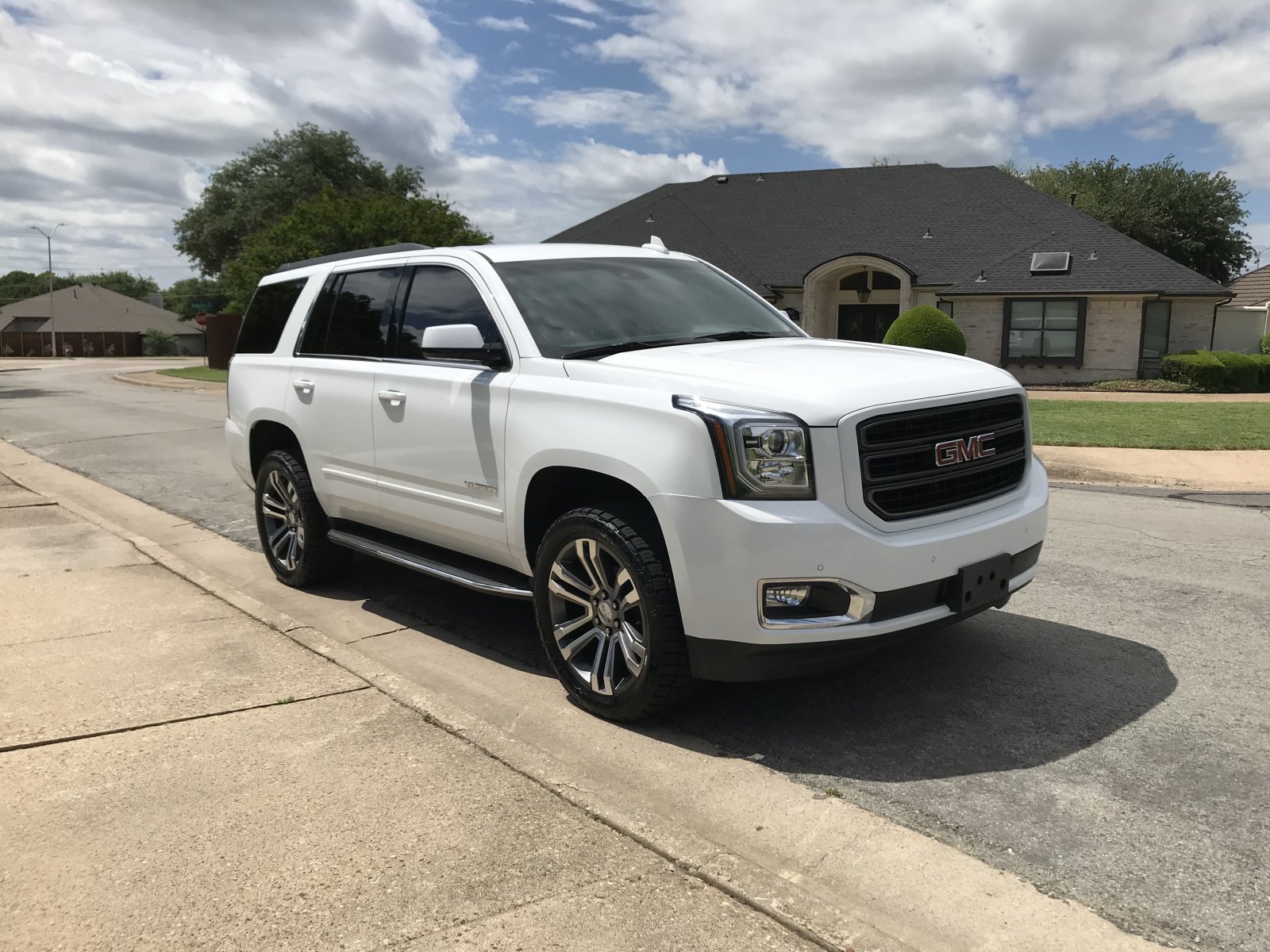

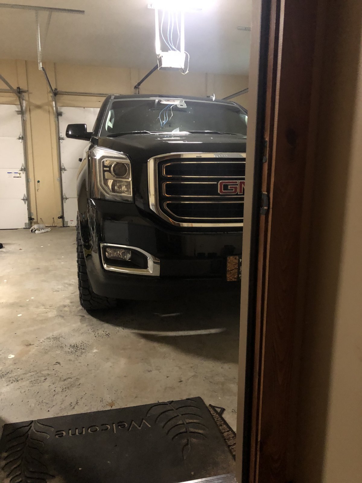

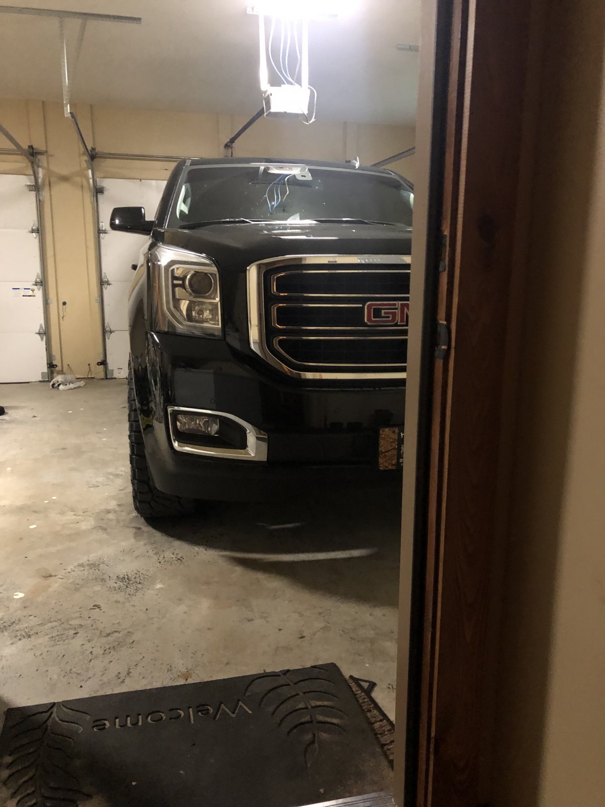

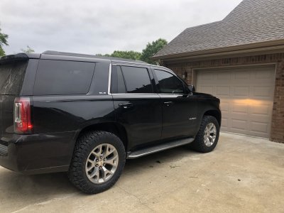

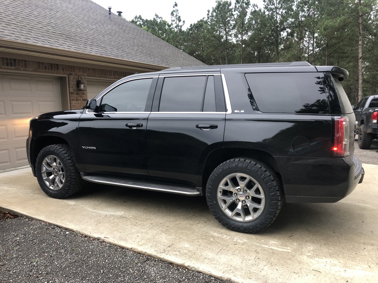

Jumping in on this party. Well, like many of you I spent sleepless nights and countless hours debating between 304/45r22, 285/50’s, or 33x12.50’s. I had a 1.5” level left over from my Sierra so I pulled trigger on 305/45r22 Terra grapplers today with the level install.
This is a 2019 slt 2x4. For mine the 1.5” is perfection. There’s no perspective where it looks nose high and the nose down lean is gone.
Let me know what you think about the Corsa tip and the graphite edition grill. Didn’t like the sparkly white which the graphite’s come in so I’m making my own.
Midnight chrome fog bezels and blacking out the trim soon.

That looks clean. Is that grill outer frame painted or wrapped or are my eyes deceiving me? Looks like it’s white.
tenminutes
Jul 2, 2014
59
72
I ordered the oem grill off the “graphite edition” Yukon’s. Came with a paint ready outter trim and the inserts are called “midnight chrome”. So it’s painted, no wrapping
