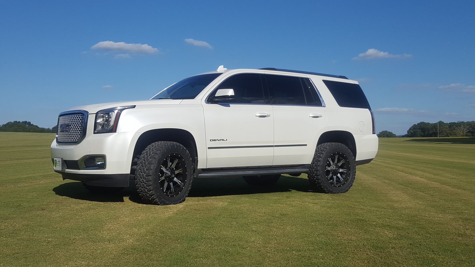

My '16 Denali XL with Fabtech 4" kit, 20x10 Fuel Tritons and 33x12.5 Fuel Gripper M/T's.

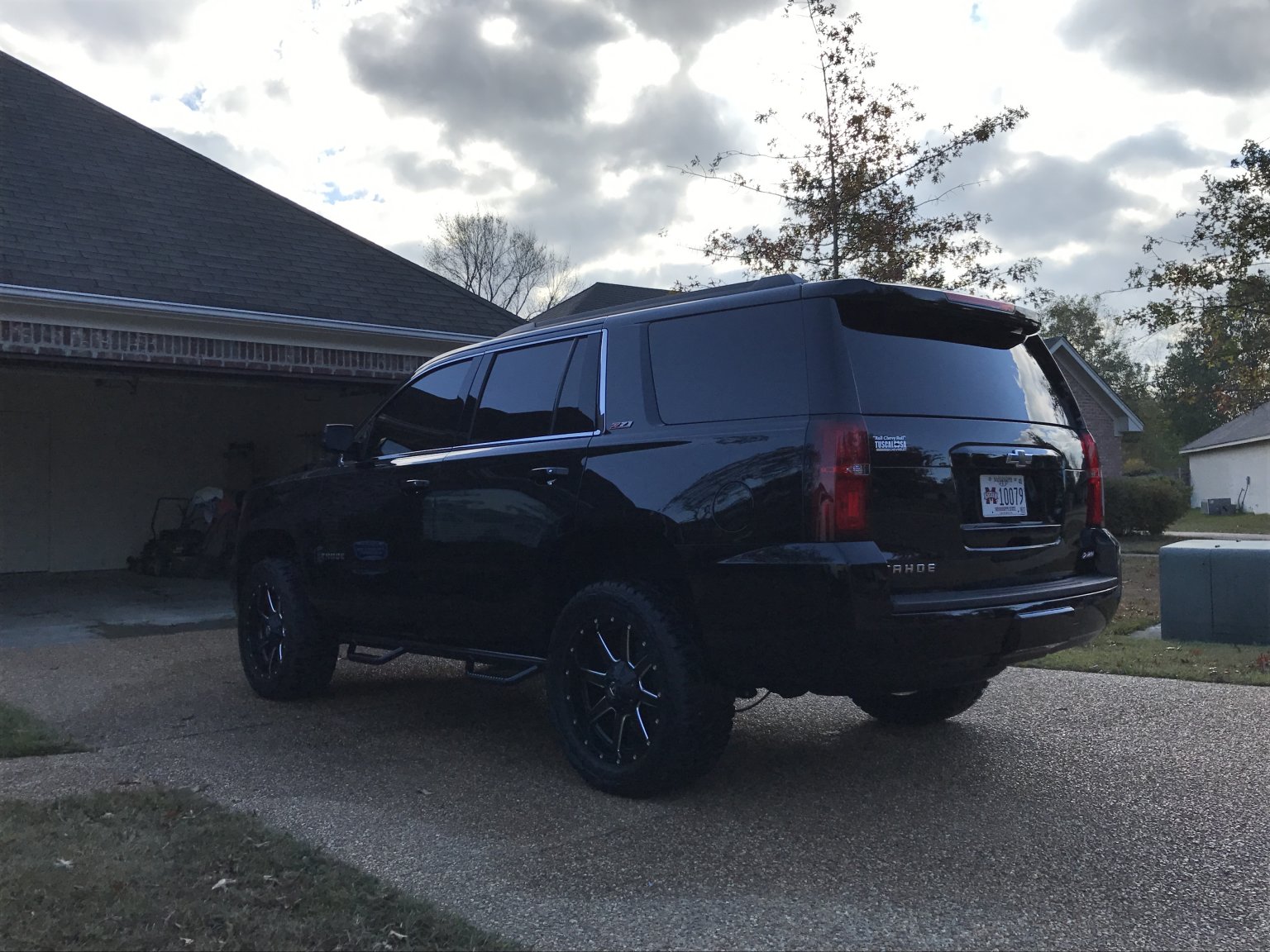

2.5" SuspensionMaxx leveling kit
285/60/20 Goodyear Duratracs
