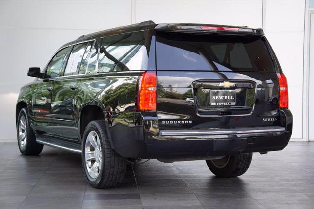

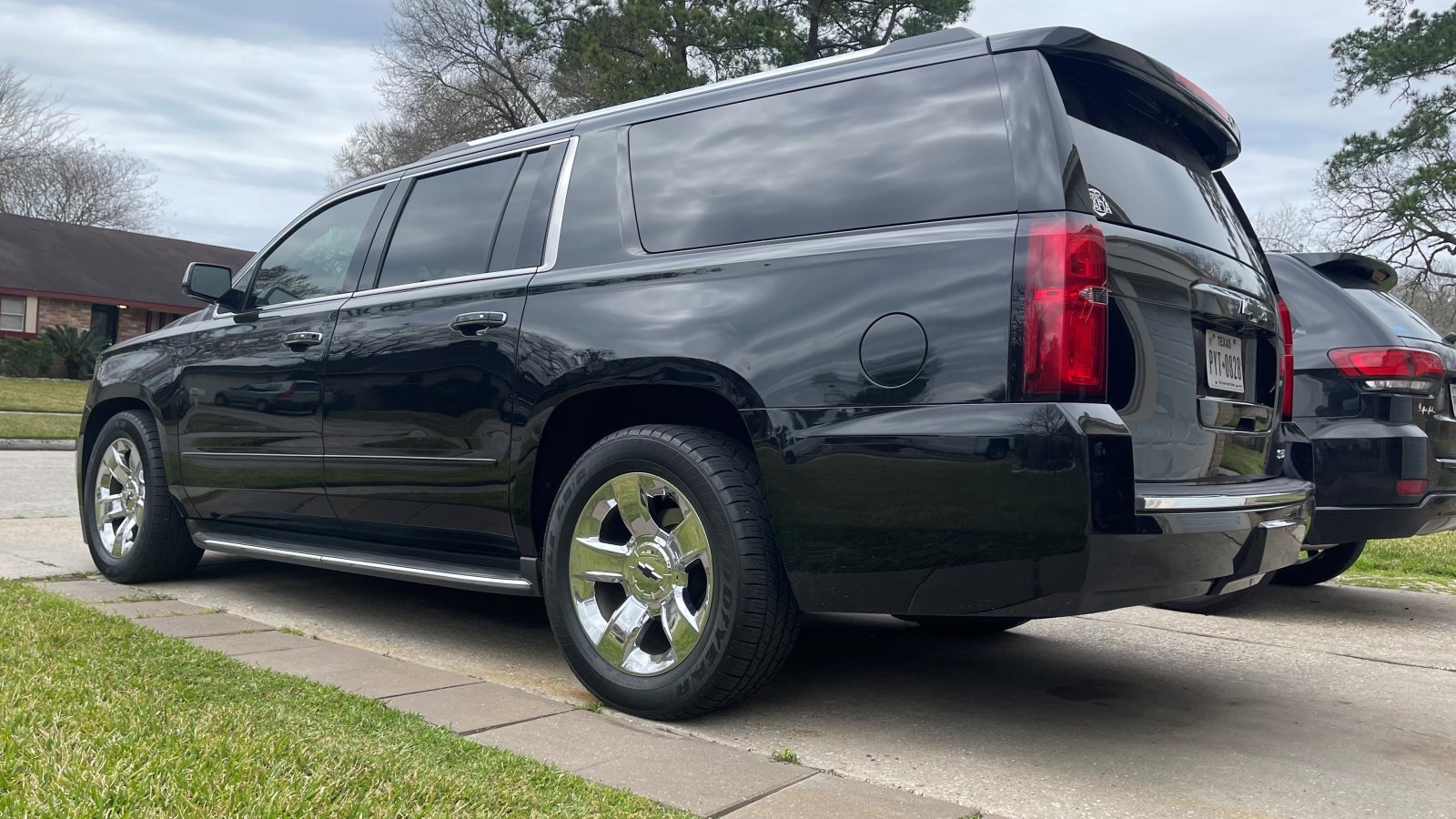

Got my drop installed.. I had the Eibach pro coils laying around that never were used on the 2012. Perfect fit for the 2015. Bought Belltech drop spindles up front . 2514 part number. Got the Belltech Shock extenders, and DJM sway bar relocator end links.
Notes, worse part of the job is the free travel mod. My plasma cutter failed a tip half way through second side, then my sawzall broke the blade, I had been holding off buying tips or blades till I could get my bulk pricing from a supplier but here we are so Finished with a death wheel and prayers. ALl in all not terrible.. Before and afters tell alot. I still think the rear autoride links may be a bit too long but Ill toy with that later.
Ride is very comparable, Maybe a bit tight in the rear due to autoride pumping up a bit. BUT handling is a very noticeable difference. Fuel mileage average up 1.5 mpg already. I was cruising 51 mph the other night at 33 mpg... INSANE...
The Eibach Pro coils are progressive rate coils, I had them in my 03 and they were very good. So far very pleased other than I want another 2" down already but for ride and what I use this for, I think staying here at 2/3 is about where it needs to be.
NOTE.... If you are over 6' tall and open the lift gate, be prepared to DUCK>>>>>> Shit hurts.
Before....
After
Before
After

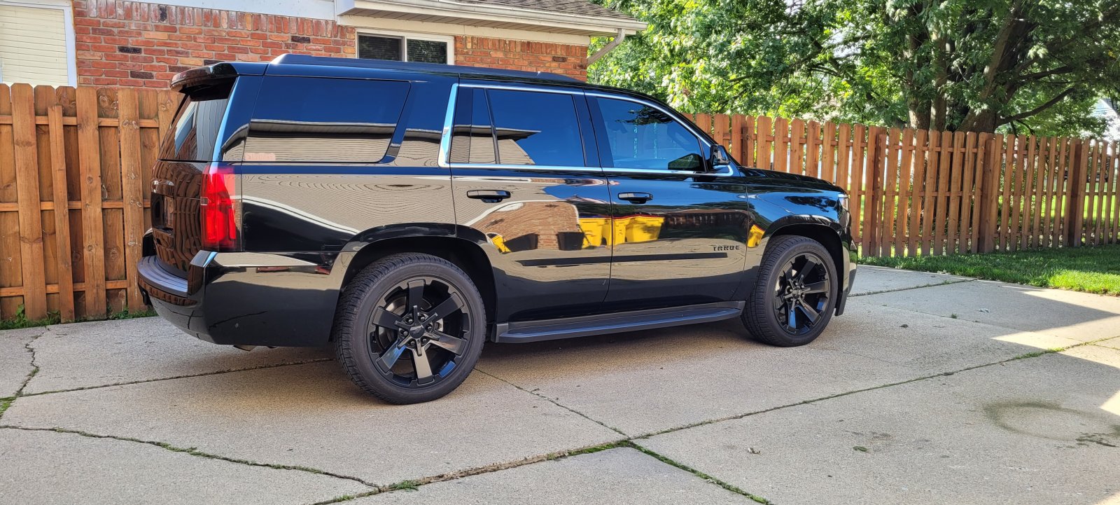

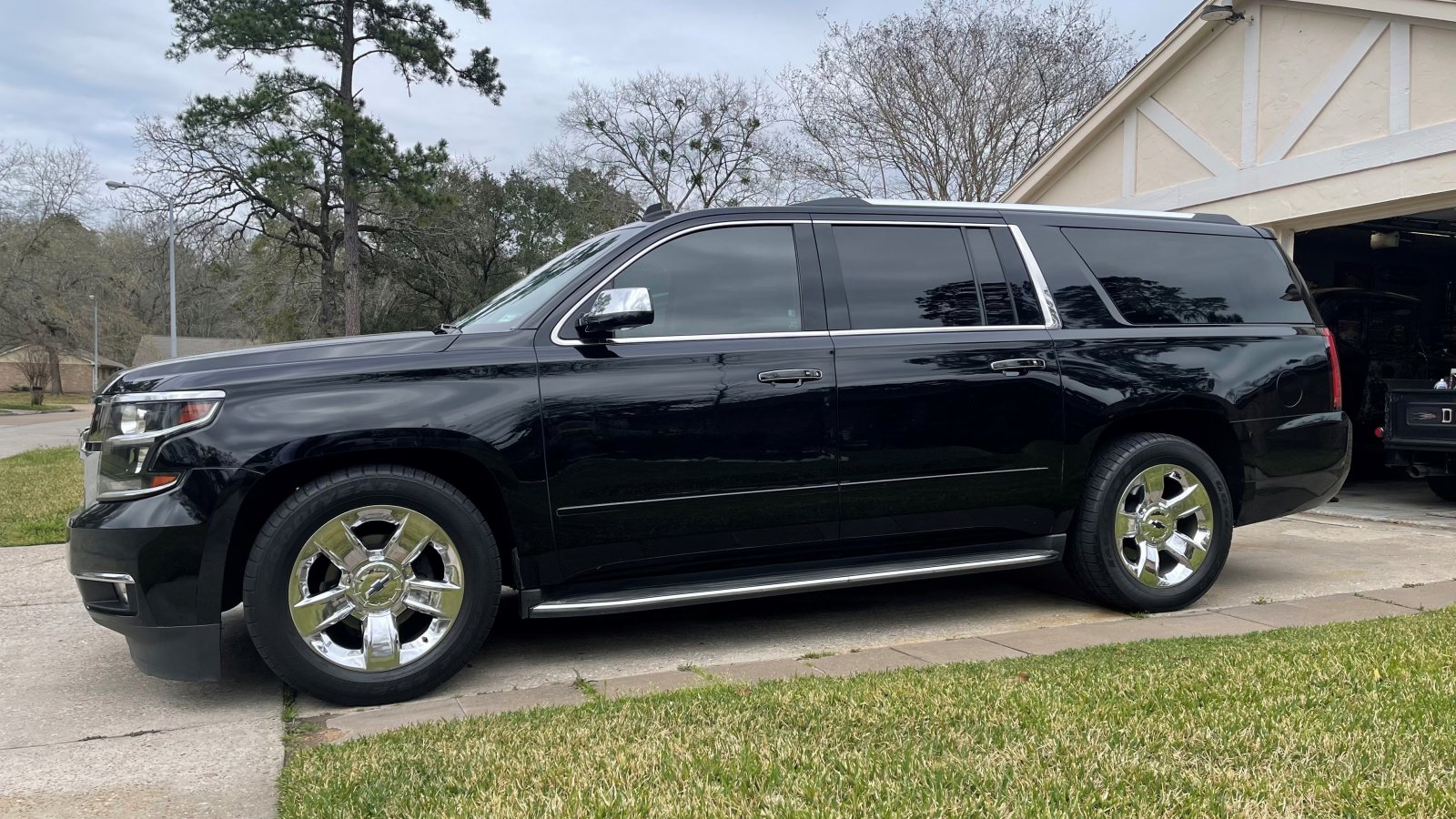

2018 Tahoe ls trim on a 2-3 beltech drop with 22" stock wheels/tires. Corsa exhaust (waiting for my Corsa cai).
