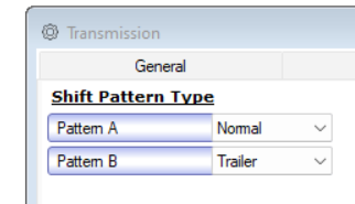

Did it have a tow button before? Just a hunch, maybe it needs to be turned on in the TCM.
It did not have a tow button. Most PPVs don’t have a tow button. I replaced the shift lever with one from the dealer that had a button and a connector and plugged in the connector. No tow light on the dash. It appears that it doesn’t have power.
How do I turn it on in the ECM?

I would think he needs to verify he has the MYC or MYD or M99 or MW7 on his build sheet in his glove box. If he doesnt, it is something he will need a HPTuners to turn on that feature.
