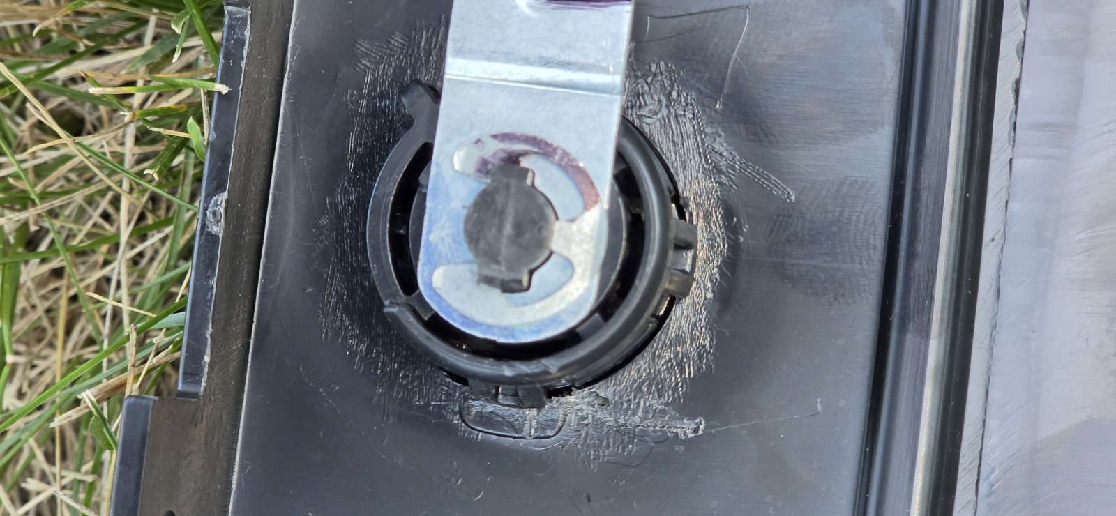

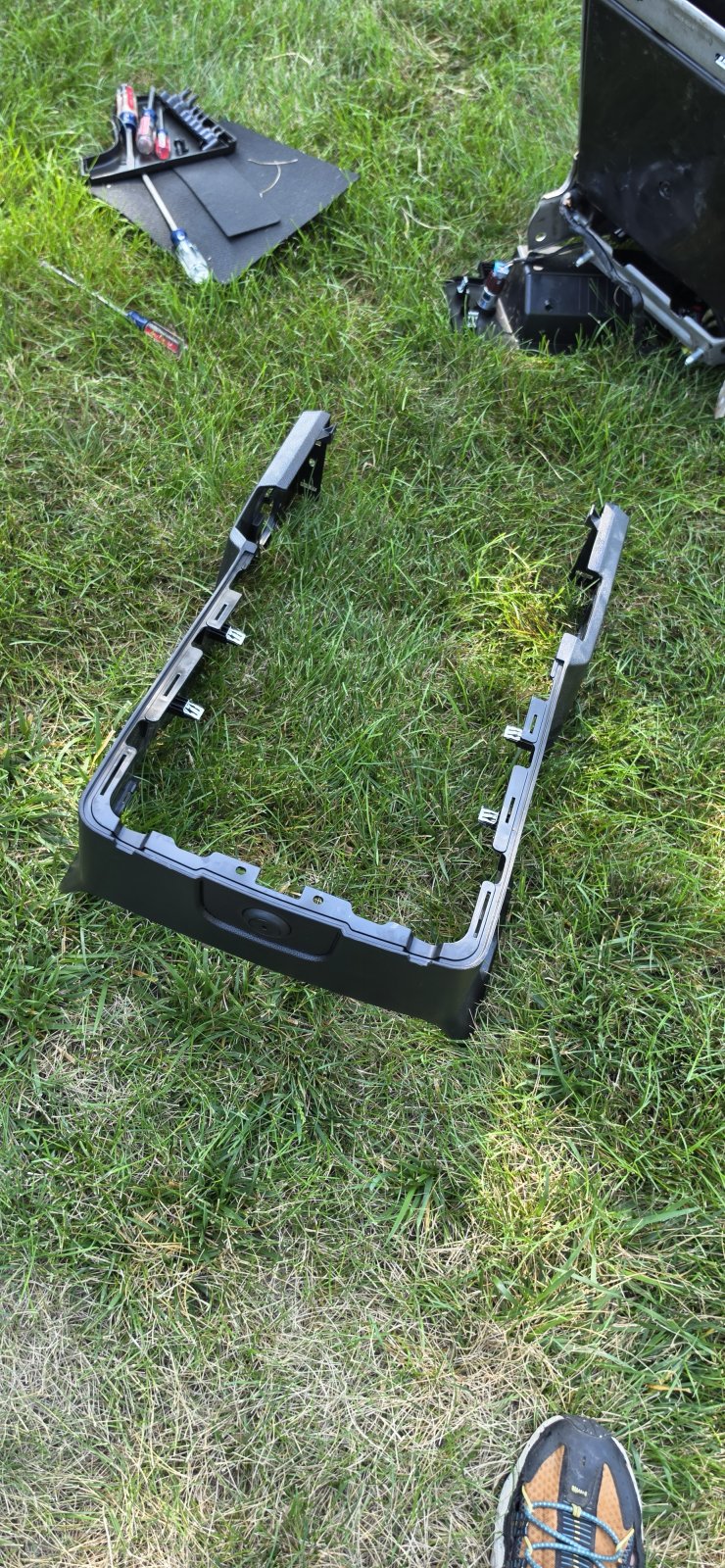

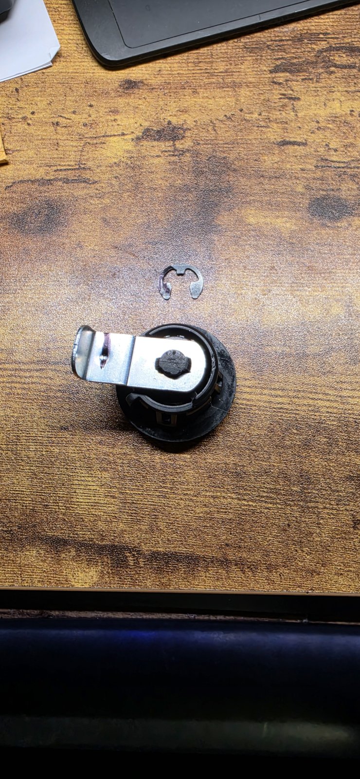

I had the console out over the weekend for another issue. And I was able to get the lock out of the console itself. For those wondering, this is NOT the most secure lock in the world. It wouldn't take much to bash that out of there.
While I had the console out, I was able to remove that lower cover for the console and get better access to the lock. A big pair of channel lock pliers and a screwdriver made the job easier. I clamped the pliers for on two of the tabs and press another with the screwdriver. Given there are four of these tabs, I don't know how a person would get the lock out without taking the console our and apart.
Anyway, the lock and a key are now in the hands of a local locksmith. They weren't too confident that had the....wafers(?) to do this style of lock.
We'll see what they come up with.
