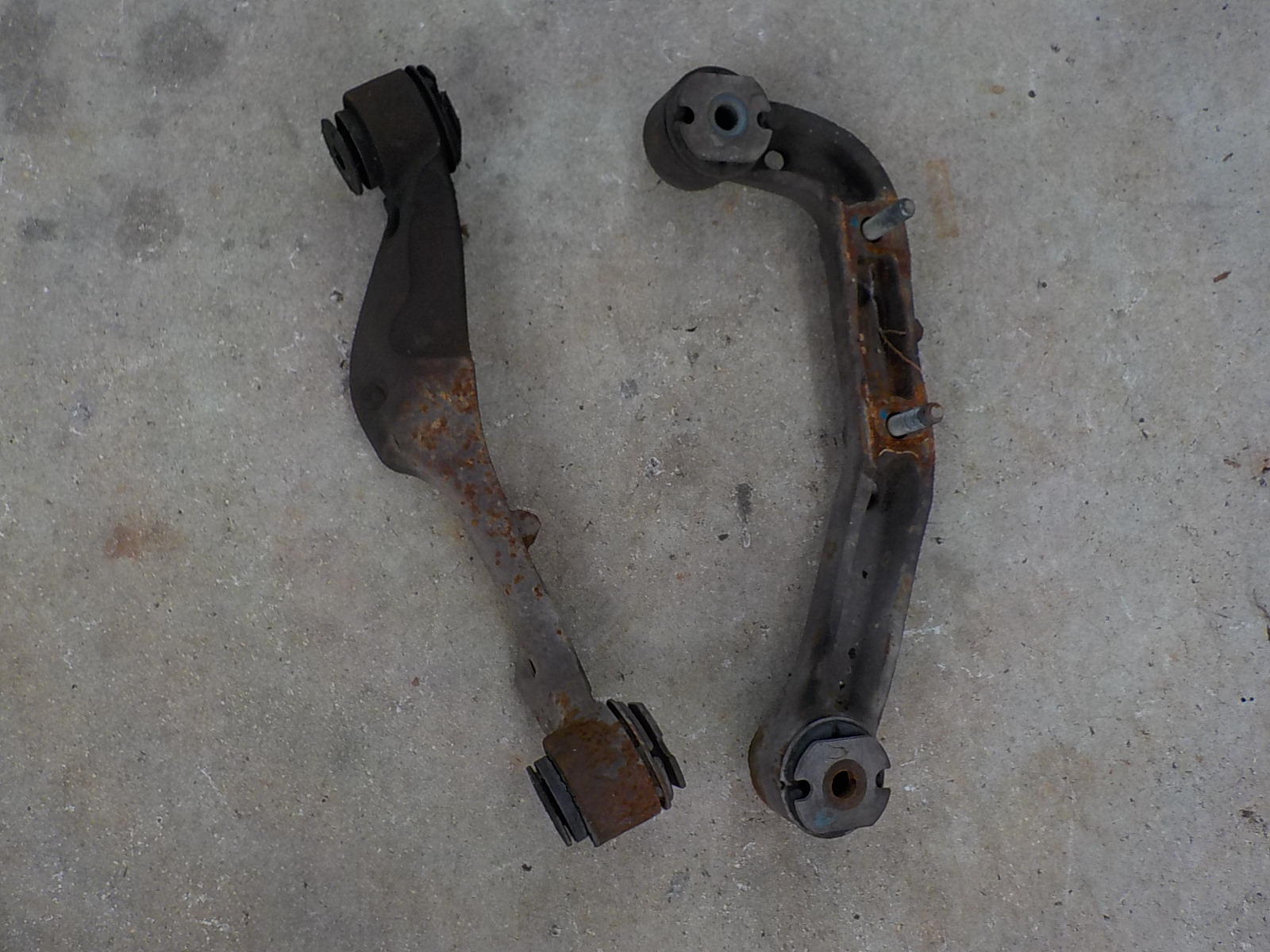

Also check your frt differential carrier mounts: AC Delco Pt# 23104736 for the driver side, and 23104735 for passenger side. The ole rubber bushings in them get wornout.View attachment 379619
I'll have to crawl under there and take a look. This is one of those things I've never thought of to check. Thanks alot. Weirdly the truck had struts replaced at 35000 miles. The truck sits now with 55000 miles. Makes me wonder if a curb was wacked hard enough to damage something. Could be wrong but I've never seen struts fail at 35k miles. Unless really abused. Truck shows no signs of abuse either, but we all know, it's easy to hide some things.
