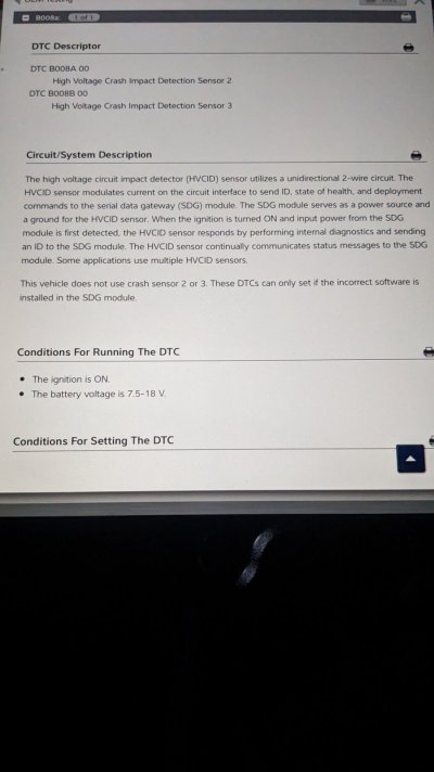

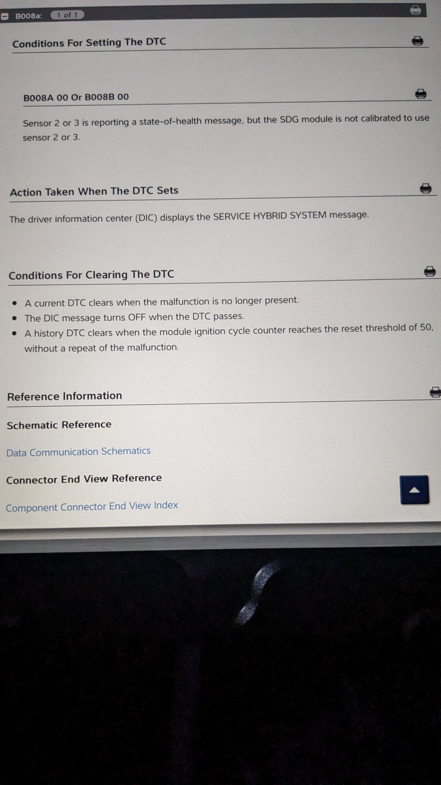

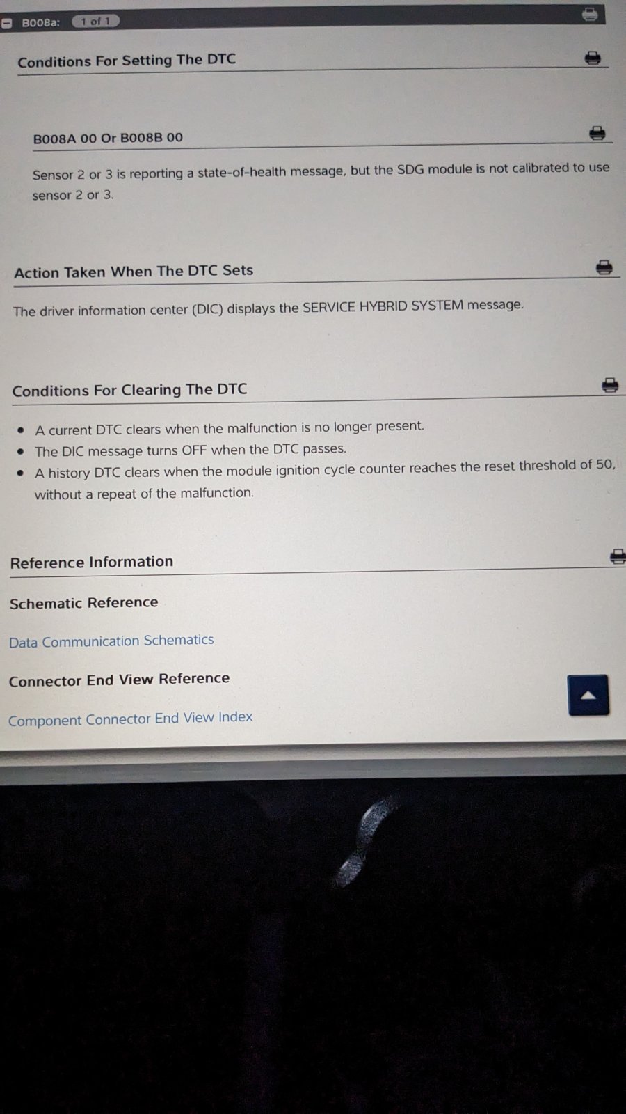

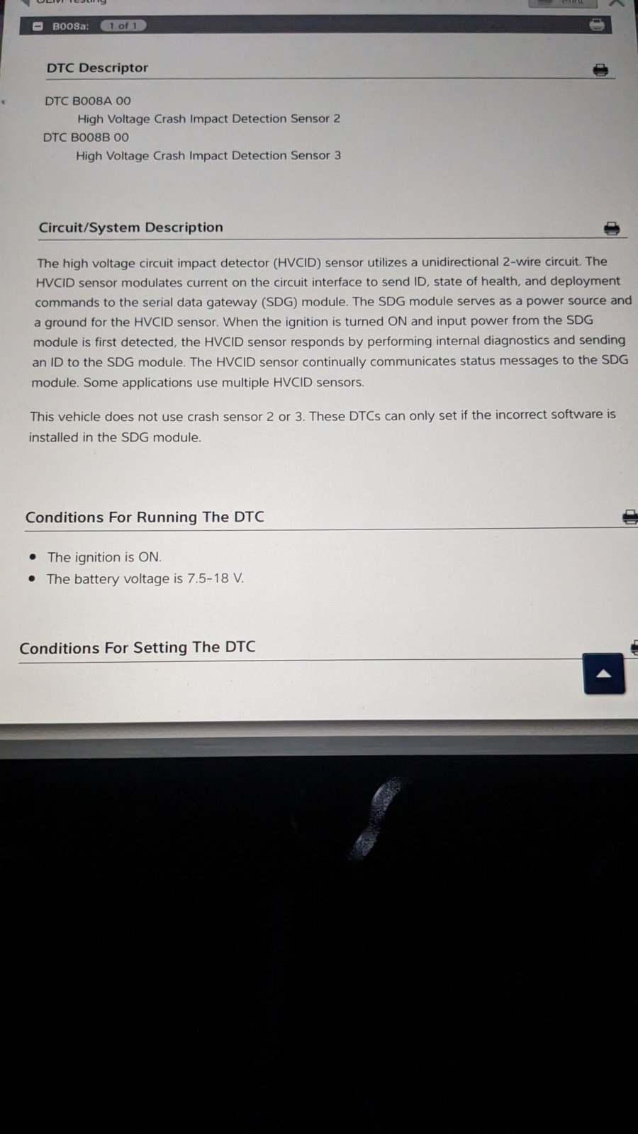

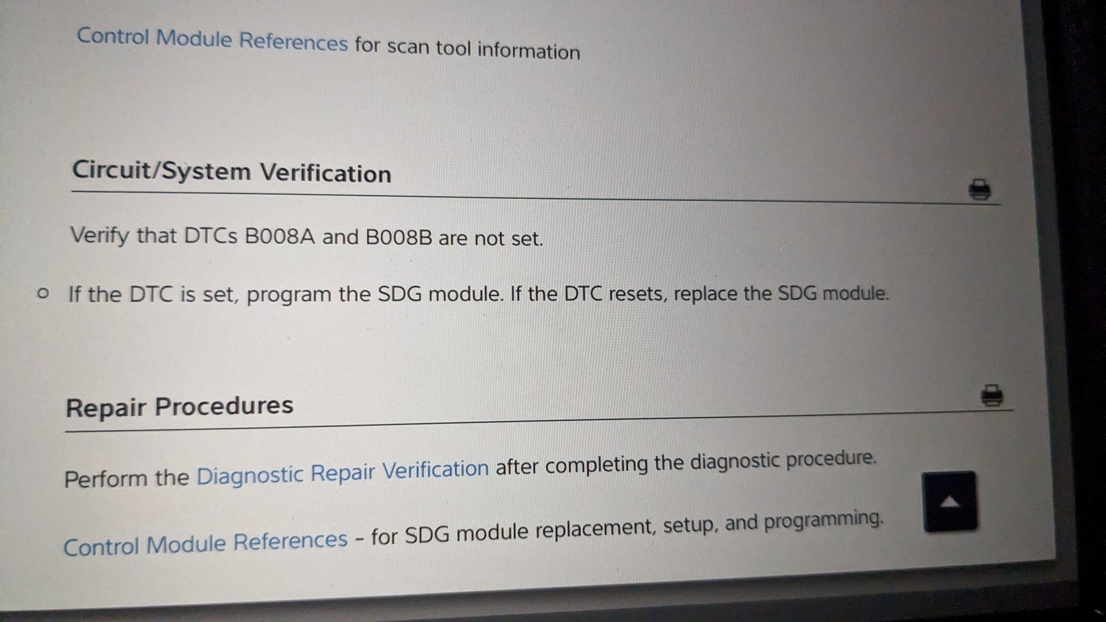

Yeah, that’s what I thought, I need to program the SDG somehow, then the Sevice Hybrid System message will disappear. Thanks a lot for your time and help. Really appreciate it. Thank a lot.
