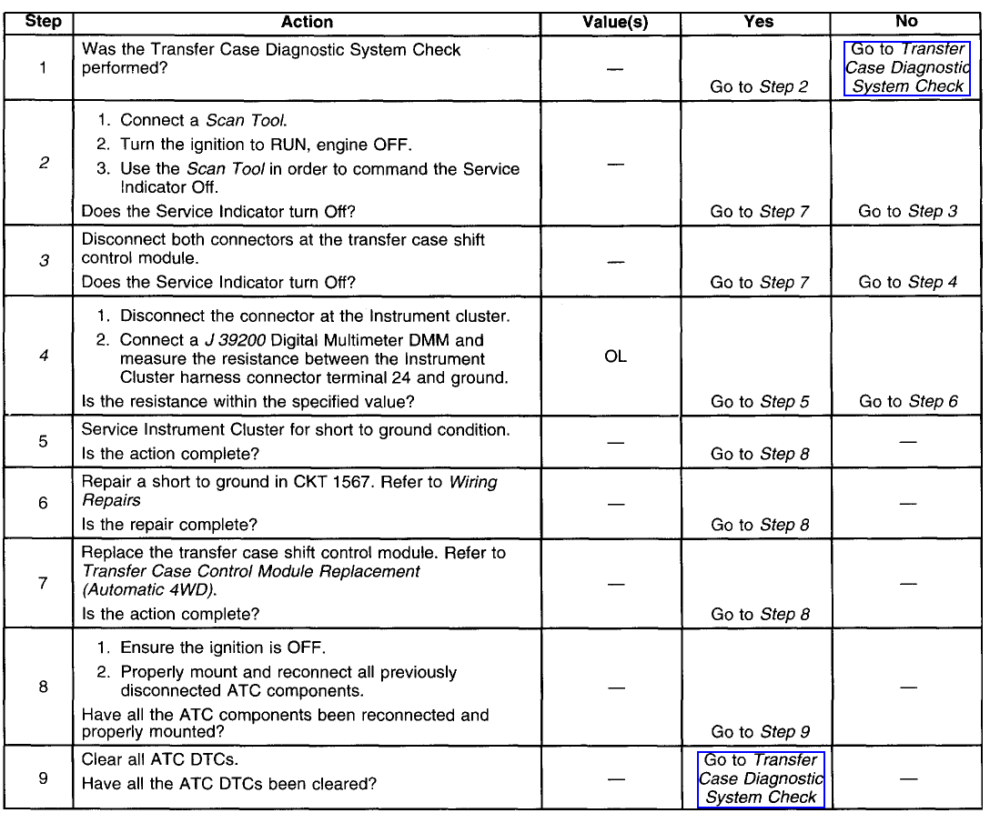

i believe there is a way to put into self diagnostic and it will blink a code back at you. i cant remember or you could get an advanced scan tool capable of talking to the module.
east302
Dec 21, 2016
1,687
1,685
Mississippi
It looks like a good scanner is going to be needed here, but maybe you can rule out a few things...

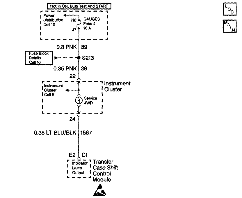

Yea I’ve looked through most of the vids but haven’t really found anything useful that doesn’t involve a scanner. I do remember that it didn’t start doing this until I jiggled some of the wiring a while back, before changing the tc, so maybe I should take a hard look at my connections and the harness.
