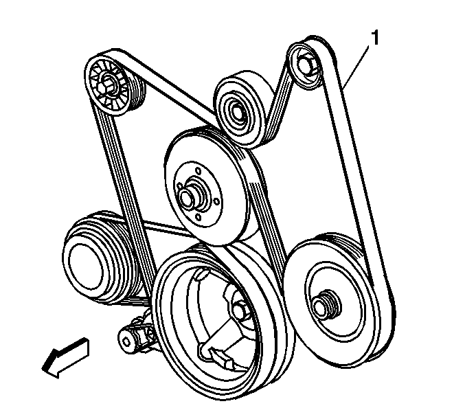

I'm trying to replace my Serpentine belt on my 04 Denali 6.0. I've tried 2 belts and they both are really close but just a bit too tight to get on. Any Idea how I can find the correct belt length?

I would suppose the 6.0 got the 145a alternator?

What part number belt are you using? Old belt number, if you can read it?
Any chance the alternator has been changed? Is the AH rating stamped on the alternator?

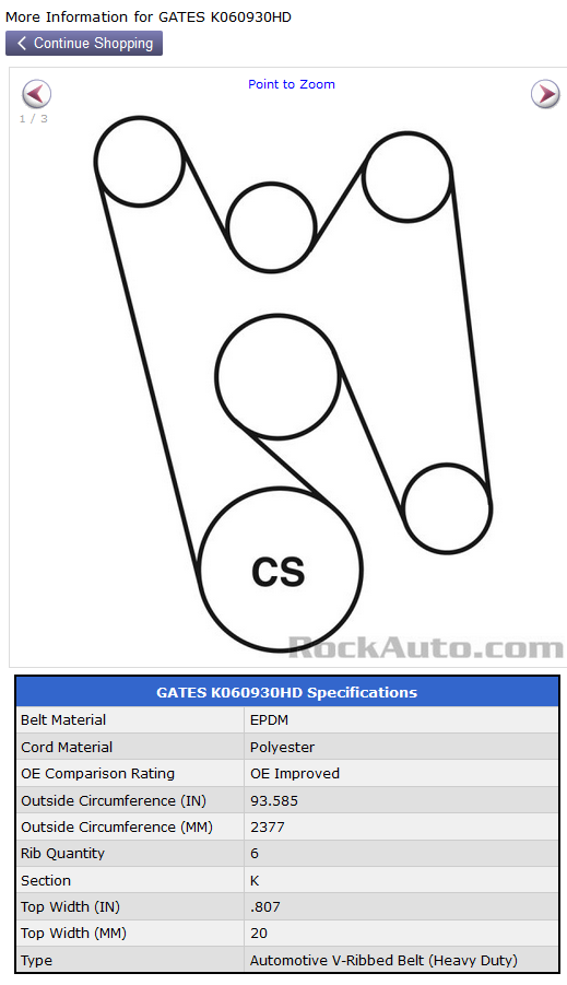

I tried 3 belts After 2 that I couldn’t get on I looked for a belt that was slightly longer. The 6k930 has an effective length 93.02 inches The belts they gave me at the store were just a bit shorter 92.5 or so
Continental Belt 4060930 did not fit.​

For the 145A alternator the Gates HD belt is a bit longer than the others, at least it has a longer outer circumference, as does the Gates non-HD belt. Not sure if that would give you just enough...
EDIT: also wondering about the condition of the tensioner.
