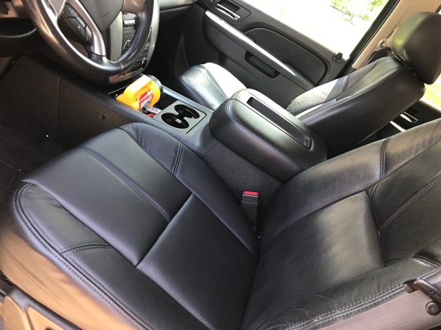

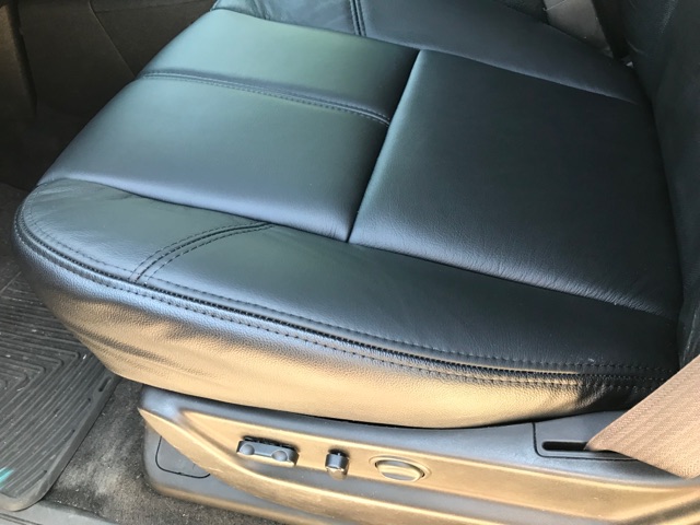

I just did a Drivers seat OEM Leather Cover and foam replacements on my Cadillac and used an Amazon supplied / Non OEM Leather Cover and Ebay supplier foam on the Tahoe.
https://www.tahoeyukonforum.com/thr...er-and-pad-install.109322/page-2#post-1352003
Same great results for both. No difference in Quality. Fit is the same Quality, Stitching the same quality, foam backing the same quality, foam durometer BETTER Quality on the non OEM. If you look into it you find that all the ebay covers and foam are made in USA in Texas border-towns that supply Lear and Faurecia seat makers who build the seats for the OEM.
In actuality, I might have used the OEM on the Tahoe to be on the safe side, but I couldn't get them fast enough, and they were a lot more $. In the end, it would have been a total waste of money. They are NOT Crap Quality.
Here's the evidence of 2 installs I did a week apart.:
Cadillac (OEM Cover and Foam) Different style but its the look and feel of the Leather, fit of the leather and support of the foam that is important.
Tahoe (Non OEM - Ebay / Amazon) Different style from Cadillac, same or better leather quality and fit as the passenger side (Factory), Better durometer foam and support than OEM foam)
Very happy with both! Great use of a couple hundred $ and Couple hours!

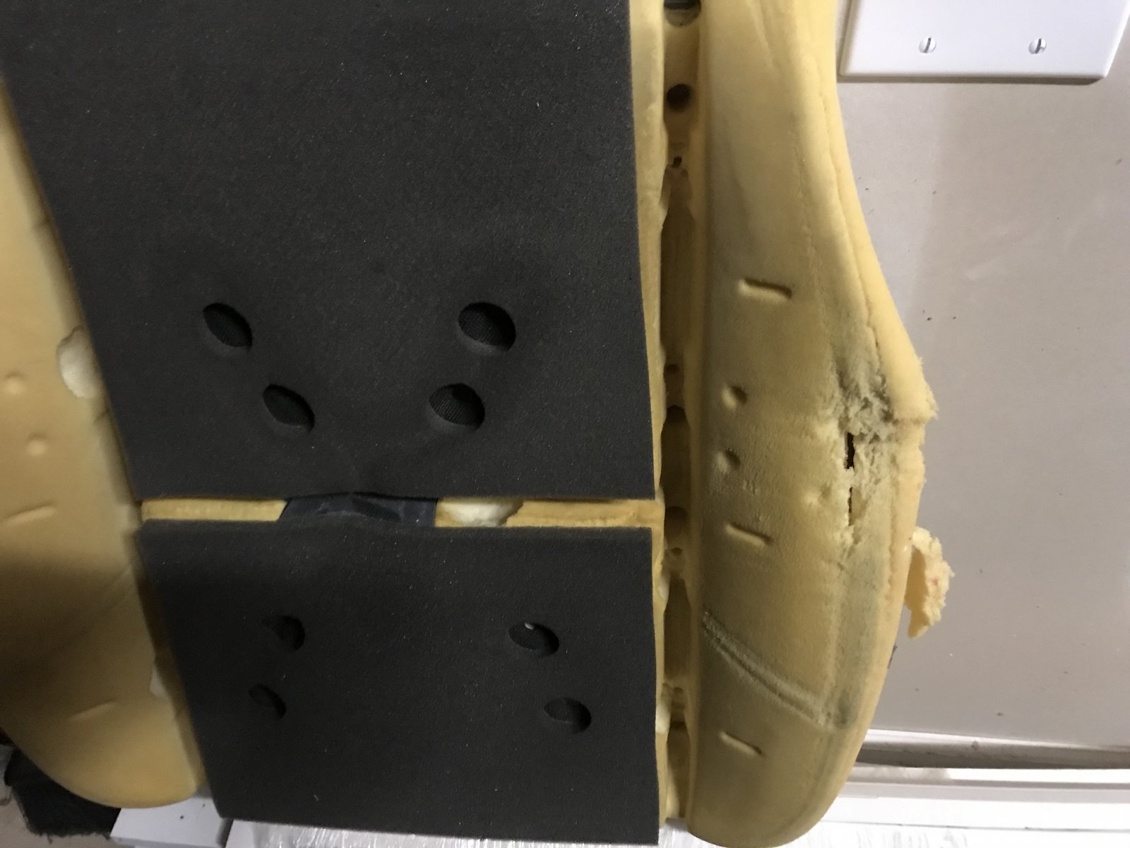

I forgot I kept the cushion from mine to use as a knee pad. This was mine with only 140k. The one from my wife's looked even worse.

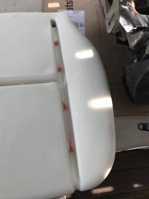

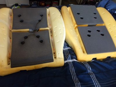

Just purchased new seat foam from a company called “The Seat Shop”
Higher density foam for the drivers seat as mine was shot from 100,000 miles of officers butt sliding in and out of the truck.
Cover is worn a bit but will have to wait a bit longer as I have other things to tend to on this truck.
Cost was around $150.00 for the foam. Their website has a YouTube video on how to remove,replace, reinstall the seat cushion and cover.

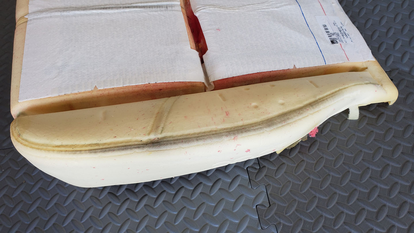

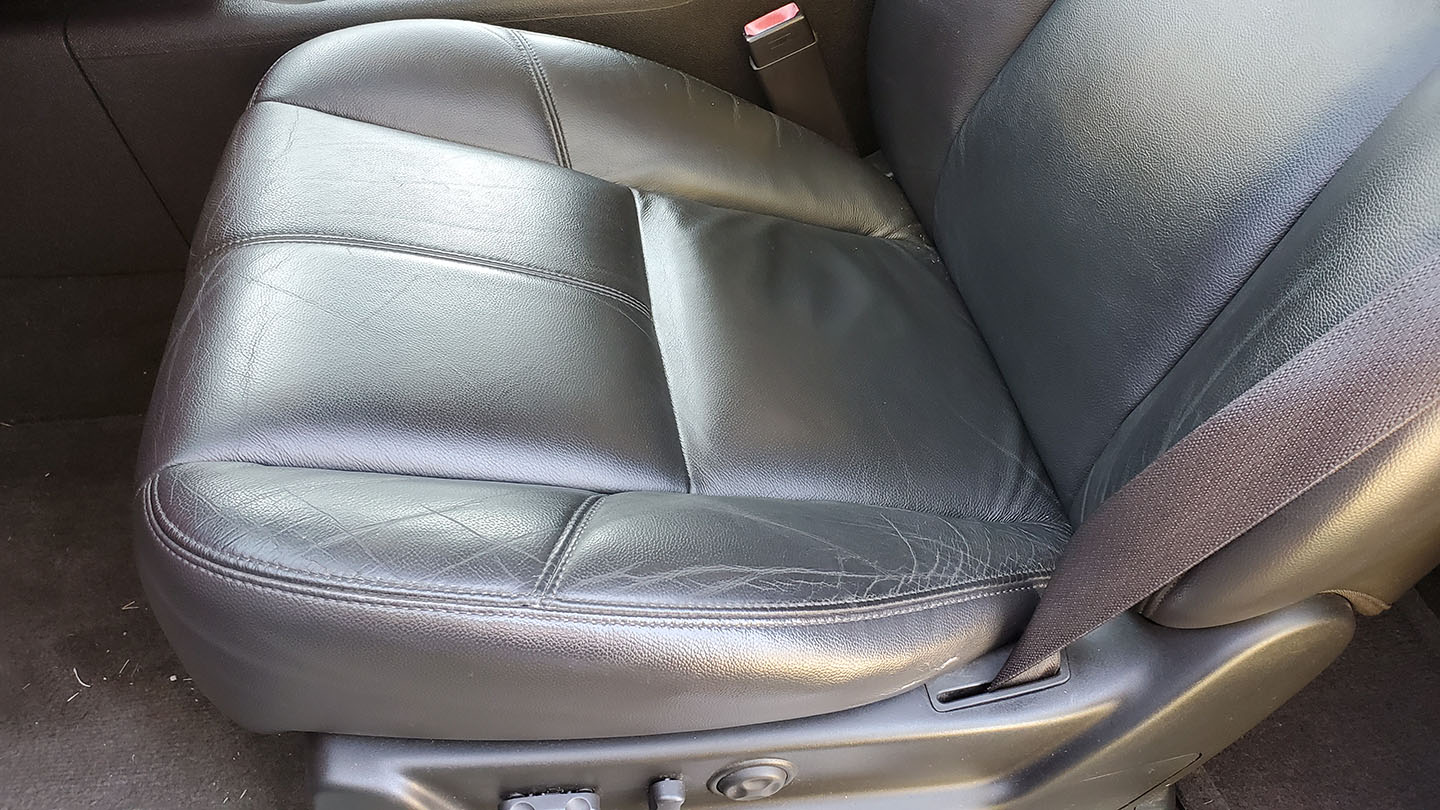

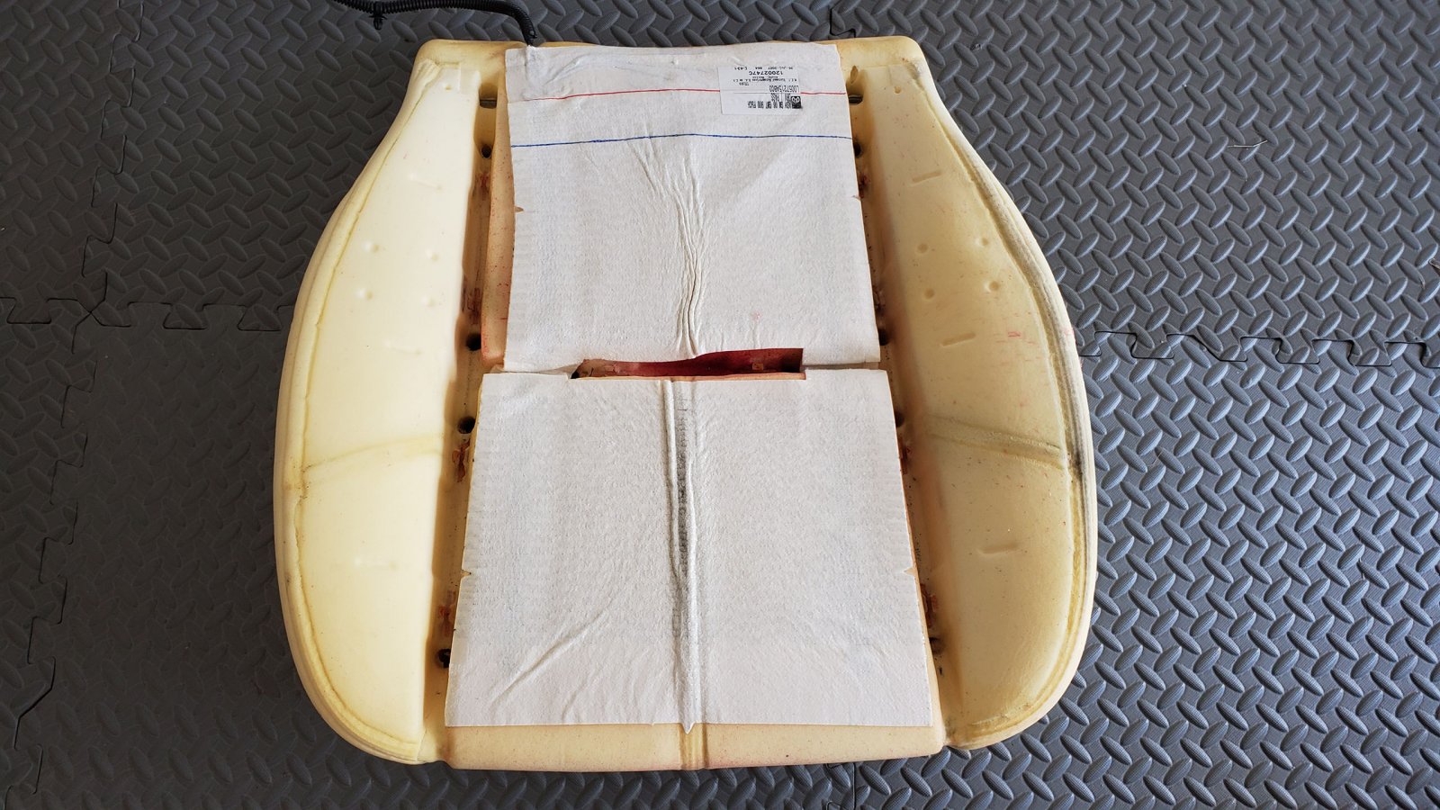

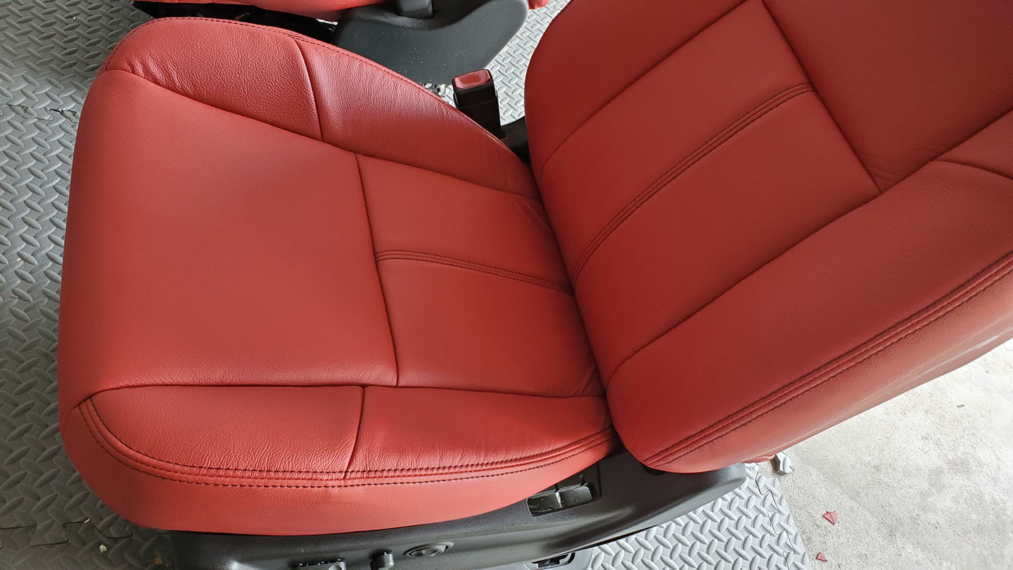

OK my new leather showed up yesterday, so I decided to just dedicate the weekend to getting that project done. As promised, here's how the front driver's cushion turned out.
Before - left side bolster worn and flat:
Here's the cushion after being de-leathered:
Everything's intact, just quite worn and pushed down:
After steaming - notice the seam indentations are gone and the left bolster is like new again:
Seat reassembled with new leather:
Like I said, it's like new again. Not only in form, but in feel too...it's nice and springy and firm again, just like it would be from the factory.
So yeah, IF your cushions aren't like ripped and seriously damaged, just steam them. I picked up a used commercial steamer on ebay for $36 shipped. Hell of a lot better than spending $200+ for two new cushions - and I was able to steam the seat backs, and the back seat too. Everything's like new again.
