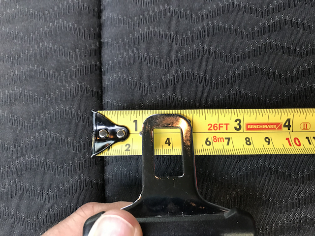

My seat belt problem just keeps getting worse. The local Chevy parts guy ordered the RH and LH buckle ends for the 2016 2nd row seat that I have in my 2014 PPV. They are too narrow and do not fit the seat belt tongue.
I'm trying to narrow down what the problem is.
Do I need different buckle ends?
Do I need different seat belts?
Do I need a 2014 2nd row seat?
Here's what my 2014 2nd row RH and LH seat belt tongues look like.
Can anyone confirm that the 2015-2020 2nd row belts are the same?

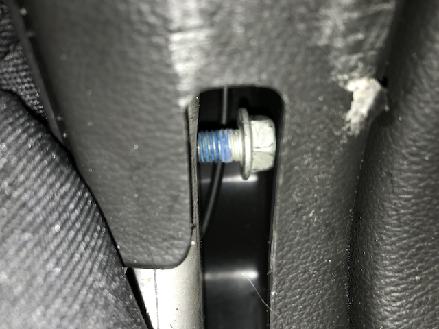

Here's the LH seat belt mount. It has a 90 deg bend. There's a buckle end attached but it's mangled and too narrow for the belt tongue.
Here's the RH mount. Looks like it should come straight out.

i would try to source the 2014 receiving ends, the 14 and 16 were different models and may different suppliers. if the seat works, leave that, just remove the buckle ends and swap them to fit your model year
